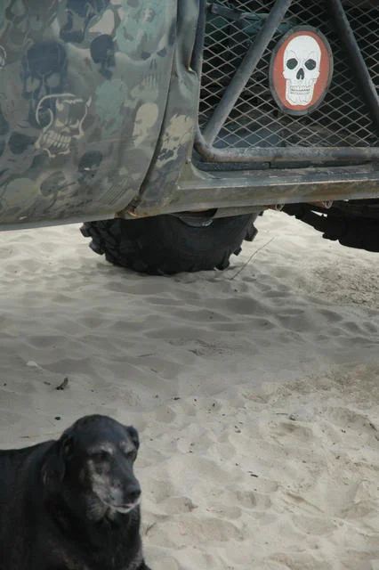

i like the camo look, I cant take the credit for this, and you prolly saw it at pismo but i love the skull camo paint job done by the guy with the chevy truck and cruiser bezel.
I am trying to figue out how to do a skull camo paint job with my rhino lining/flareless look, it hasnt come to me yet but this guys rig is definetly sick.

That is Seth aka "SETHZILLA"s rig.
