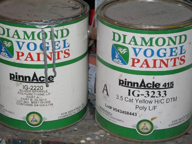

diamond vogel
Try looking into diamondvogel.com. They make a nice line of 2 component urethanes that when dry, you could literally comb your hair in the reflection.
The name I would get if you can is pinnacle 460. Should be able to get a gallon for under $80. The can on the right is pinnacle 415 , which is not quite as shiny as 460.
