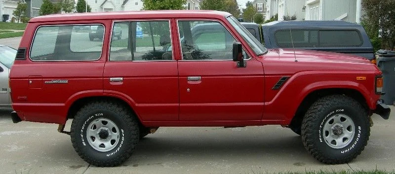

I did 10% minerial spirts when I sparyed the 60. 10% thins it out quite abit. I did get some slight orange peel but I think if I would of adjusted the spray gun better I would not have had any.
I would get a large piece of cardboard and play around with the guns settings till you get it adjusted correctly. then have at it
