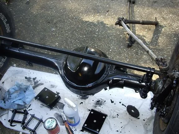

por 15
I used POR-15 The chassis coat top coat I put on it is less glossy than these pics.
De-greasing is the biggest challenge I used mineral spirits, MEK, dish-washing liquid, marine clean and metal prep. a steam clener or press washer would have been a big help
I stripped paint with 3M wheels, some cup wire wheels and a little hand sanding and went over it with 80 grit
The por goes on nice it flows on and dosen't get sticky and is easy to use without runs. I just used a paintbrush but the POR flows out and look pretty much like a spray paint
