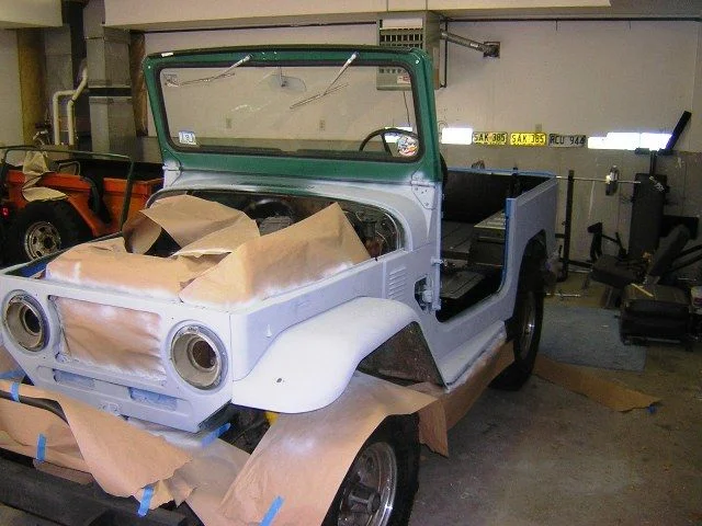

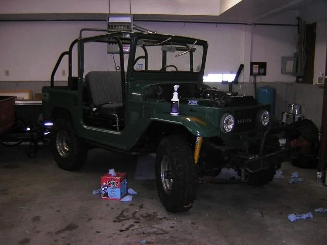

Pumpkin 40 Roller paint job

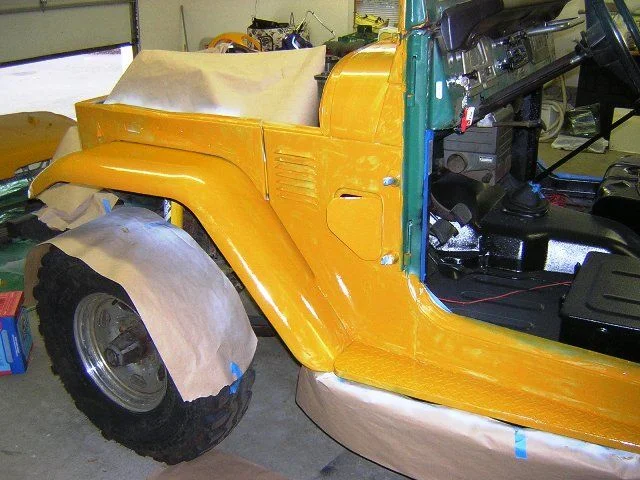

FInally decided to start up the roller paint job. It just snowed here the other day so the 40 sill stay in the garage all winter. Bought Pollux Orange color paint from ACE Hardware and a few matching spray cans from Tower Paint (for the soft top bows.)

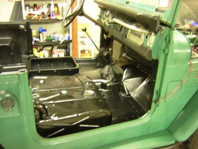

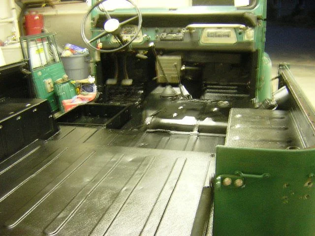

Took a bunch apart. Painted the inside of the tub black since it was green spray-liner.
Pulled the roll bar since it was covered with Herculiner and was too rough. Gonna grind it and spray some black rustoleum on it.
Rims gotta go too. Going back to old style with the original hub caps
This should take all winter so I'll post as things move along!!!!

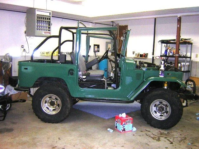

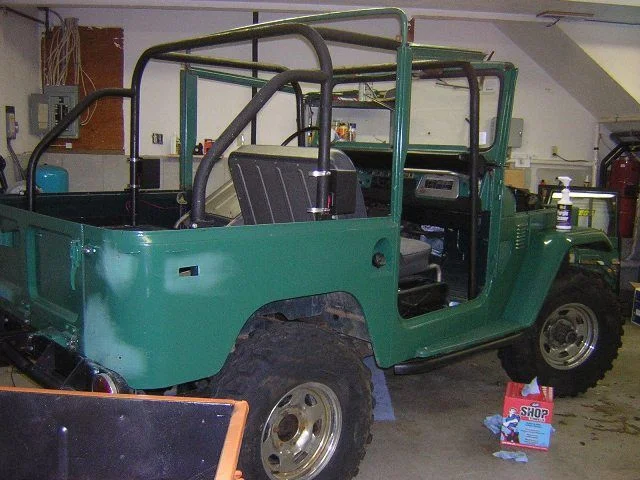

more pics

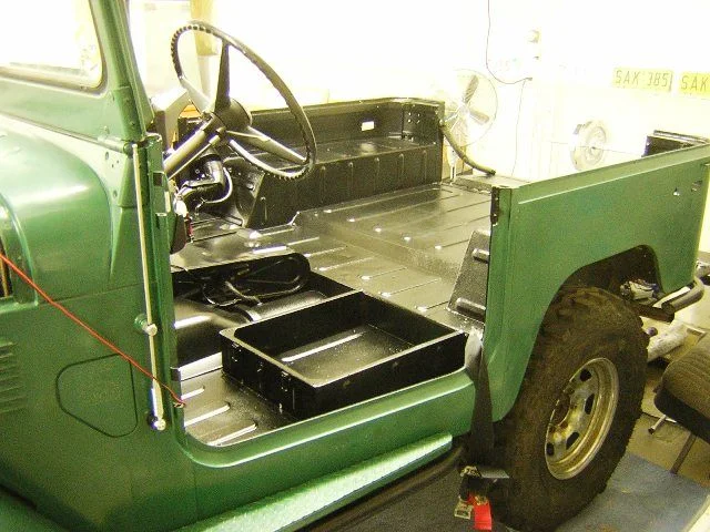

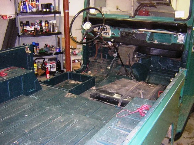

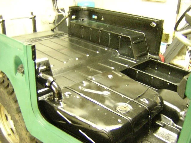

inside done

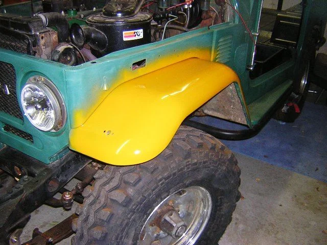

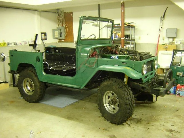

Had to spray one fender just for inspiration!!!

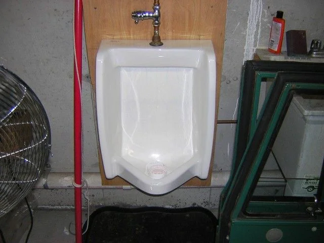

Note the urinal in the first picture below. VERY convenient!

A urinal in the shop you're my hero. The cruiser looks good to.

Shop also has air line piped thru the walls. Haven't bought a compressor yet. It's more garage than I deserve. heated 4-car.

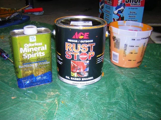

Just for clarification, you're spraying or rolling?

Quote:
I'm rolling 90% of it but bought a few spray cans for the soft top bows and for the hard to reach places. Yes, I'm cheating....

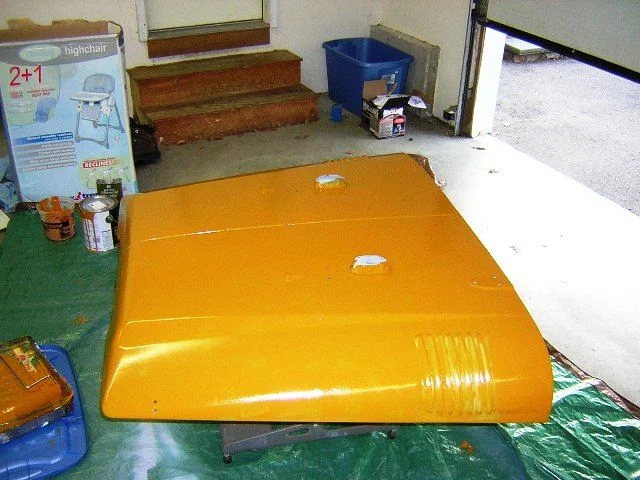

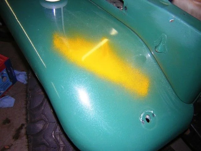

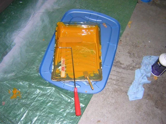

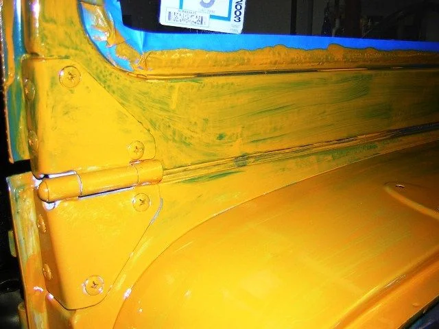

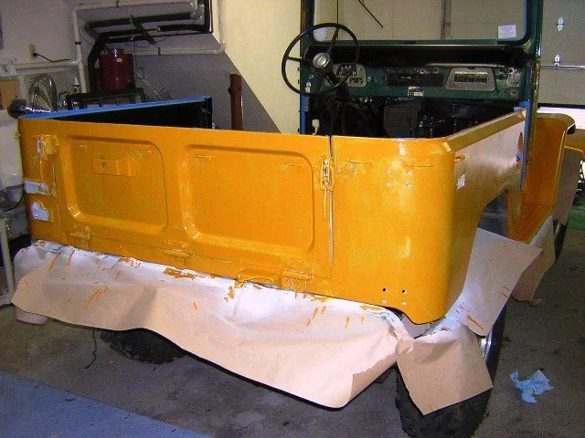

First coat of paint
Got the first coat on. I HIGHLY recommend a primer coat. The parts I hit with primer went on very easily. The parts I didn't are gonna take a lot more work. All in all very fun and easy. Looks good too!
Better pic of the ol' pisser too.....

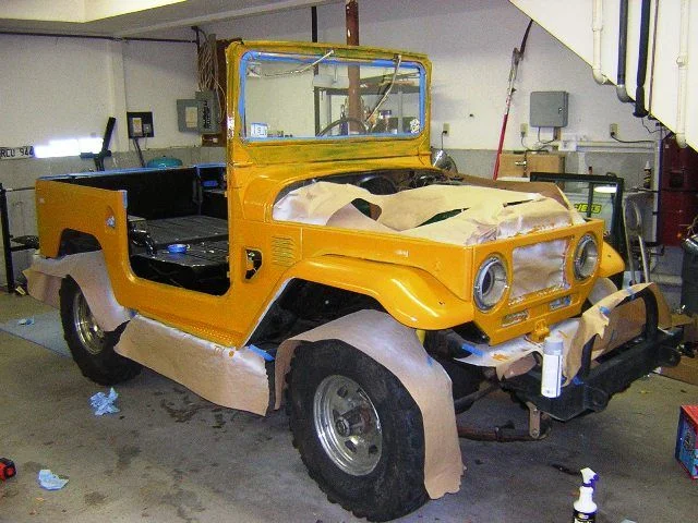

few more

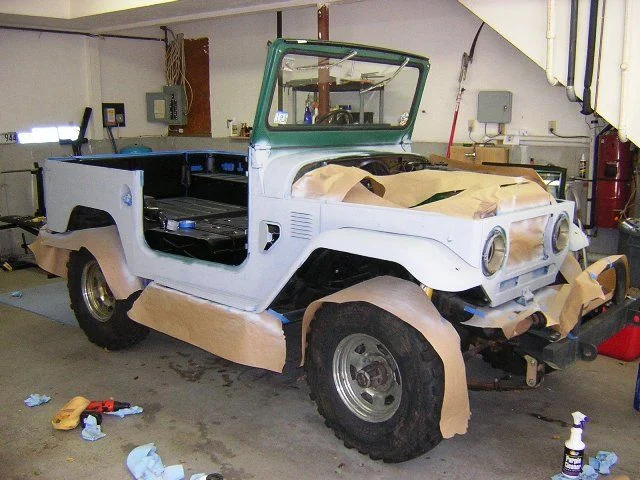

NOTE the difference between the cowl (primered) and the windshield frame (not primered) DEFINITELY use primer. Big difference

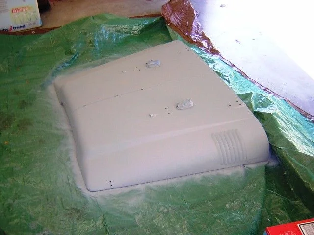

It's 9:30 pm and just did the dash and the inside windshield frame. I used the Tower spray cans to do that. Doing in between the knobs etc would have taken forever with a brush and wet-sanding in there....forget it. Went back with the can to hit all the small/tight areas that the rollers and brush wouldn't go. Well worth it. Since I had the gallon of paint matched to the spray cans it's all exact.
My dash is junk so I really half-assed it. Still looks great!!!
Wet-sanding to come.....
