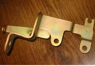

This link has some pictures.
http://forum.ih8mud.com/showthread.p...aswell+plating
Something I plated from around the carb I think and the emergency brake thingy

Thank you! Those look great! Guess I'll have to look hard at the plating kit now... That was the copy cad, then dip in the dichromate solution, and dry process?

Interesting post your parts look like new good work
