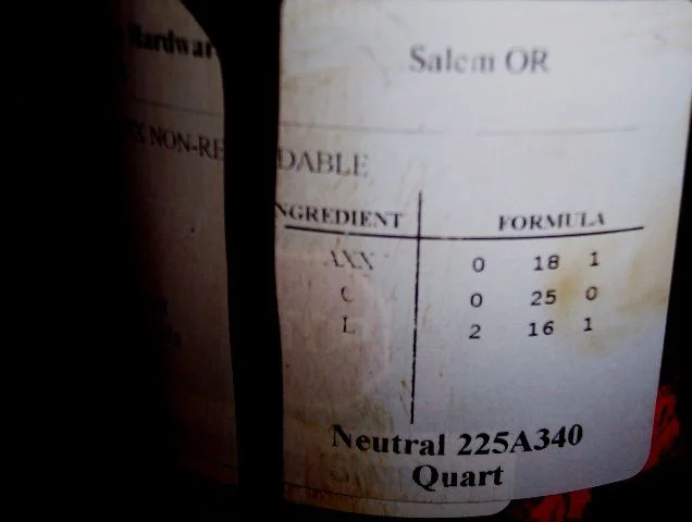

The code for the ACE Rust Stop Paint for OLIVE 653 is
Ingredient | Formula
AXX | 0 18 1
C | 0 25 0
L | 2 16 1
This is how it appears on the side of the can. And no they do not use Auto color codes. I used a color chip and they used the laser spectrometer and created the paint. The color is DEAD ON tho. I sprayed it on next to a area that I shot with Automotive paint at $50.00 a quart using the 653 code. After drying I could not see any color variation. Amazing. And this stuff does not run. Very high solids. I will be shooting clear over it as well.

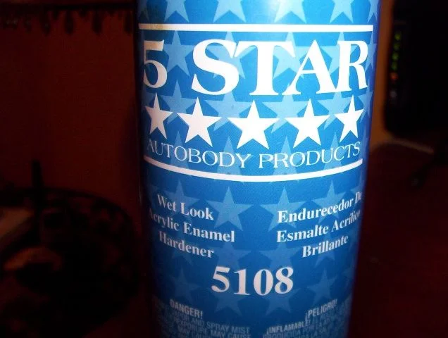

I shot my third and fourth coat but I added some "wet look" hardner. HOLY TOLEDO!!! Man it lays down nice.
The hardner I used is fully compatible and shines it up very nicely. heres a pic... May not even need to shoot clear...
