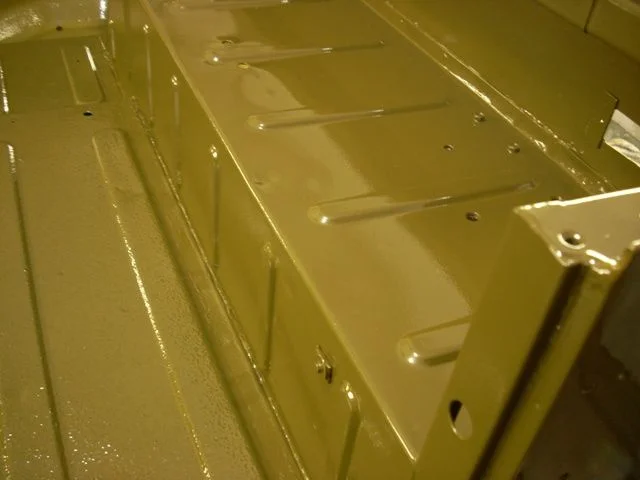

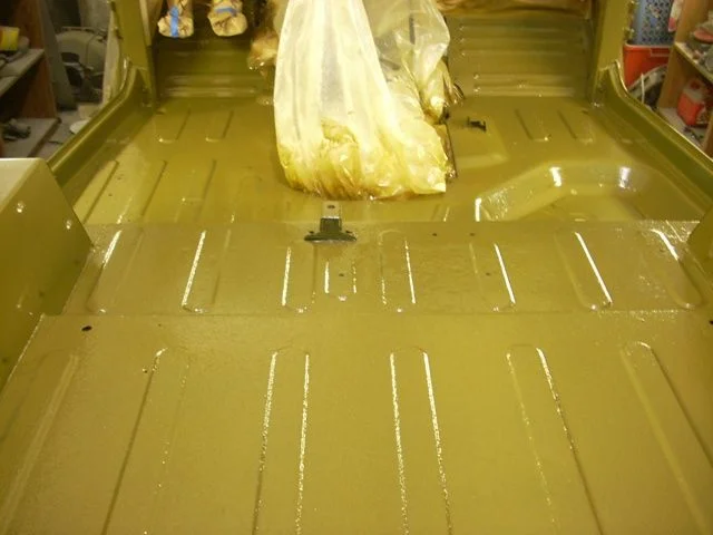

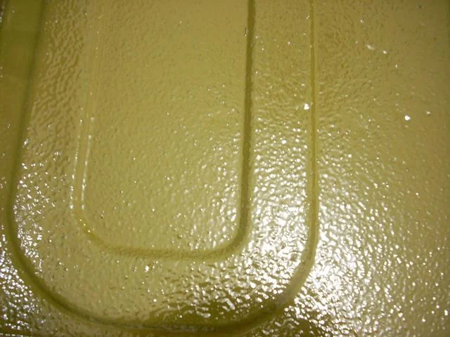

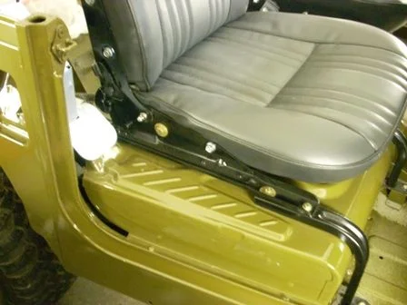

Close up of floor...
Close up of the floor...

Hmmmmm........Hadn't really thought about doing the floors. I have a ton of paint left over and will need to repaint the inside anyway. We'll see how ambitious I get.
The spray looks great. Roller is a ton of wet-sanding. Spraying really gets those tough areas like seams and hinges much better.

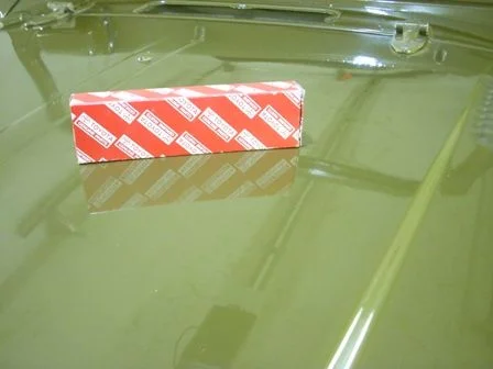

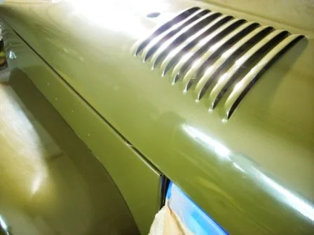

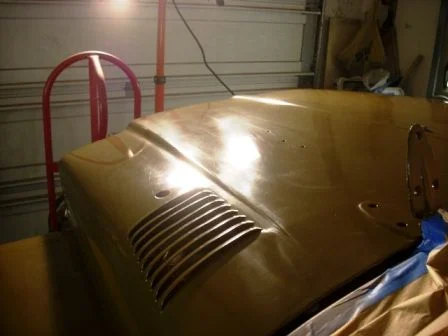

Clear and Buff!
Just got done with the first buff. Looks pretty good. Will need to get some swirl remover on it, but overall a decent finish for ACE paint...

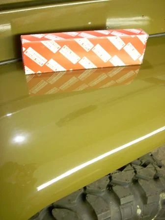

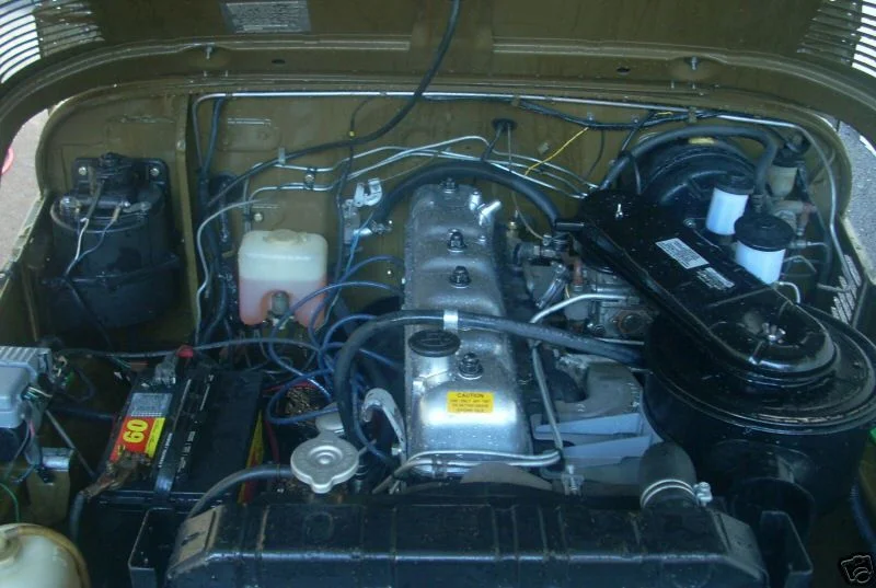

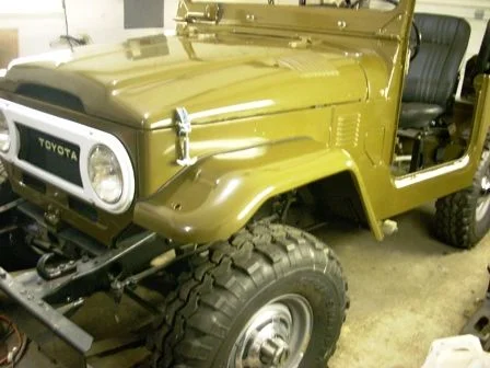

Getting closer...
Heres an update...
Getting her together. Here's some shots of an ACE paint job. Not too shabby at $25.00 a gallon...

Posts: 771
a couple more
These are after a good buff.
Should be done by the end of the month.
Garage is a tight place to work...

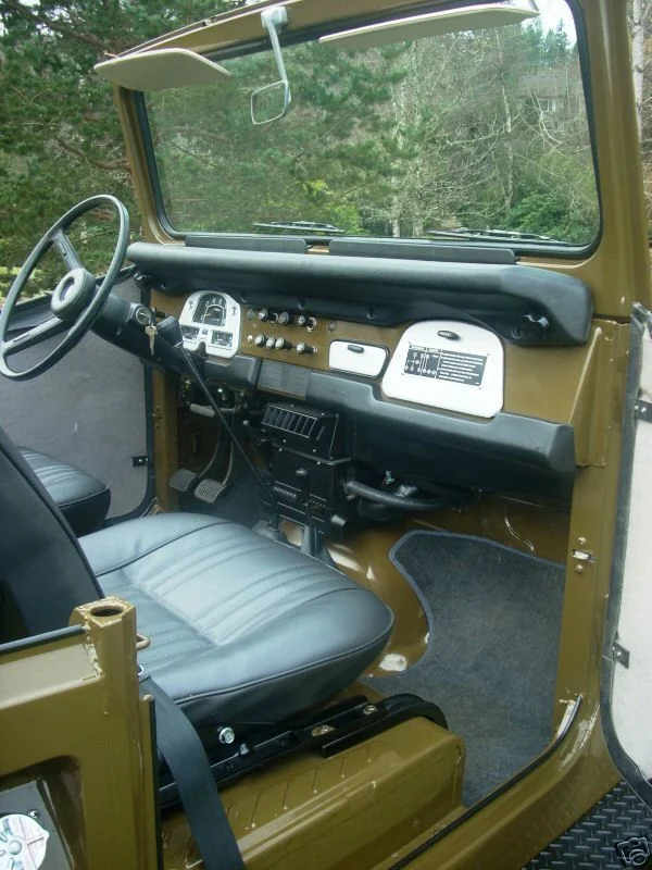

Posts: 771

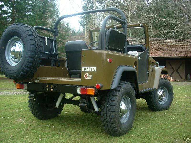

Overall outside shot
First time on the road in 13+years. Almost done.
Took her out in 30 degree weather as you see it. People were looking at me funny...
When I stopped at ACE 5 people were taking a look. One guy took a couple pics... (wow, is this normal?) Picked up a couple bolts n such, then drover her home.

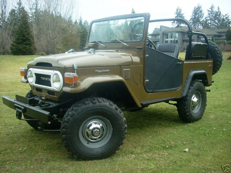

Another Update
Some final shots.
Overall, it turned out pretty nice. Alot of sanding and buffing, and the paint turns out solid.

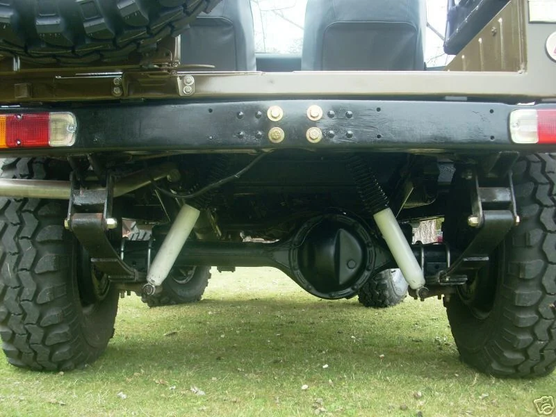

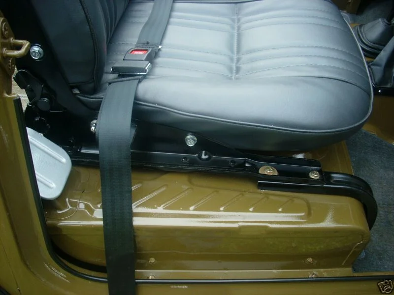

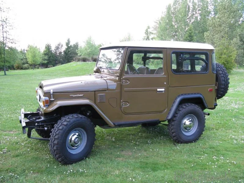

Last Picture
Just wanted to show the final outcome of this paint. (plus its another chance to post a photo!)
For the cost, you can't beat it.
Upside was low cost, accurate color, compatible with other enamel products (clear etc)
Downside, takes along time to dry, rather soft compared to true auto paint (this was resolved with the clearcoat tho), can be a trick to get the right mix of paint / thinner, issues with the process of getting the color you want (lots of "hoops")
Thx
Angelo J
