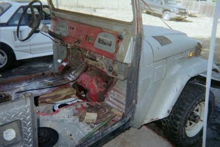

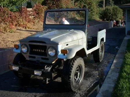

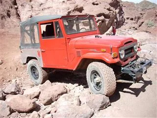

Our $60 Pant Job (Wills Cruiser)
Here is a pic when we first got the cruiser . My 15 year old son William and I started cleaning her up its been about a year now and yesterday we got busy with the paint . once we get everything bolted back on we will post more pics/

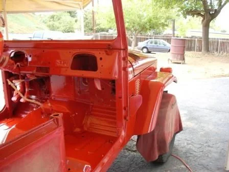

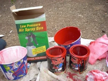

the paint
Got it all masked off and got started

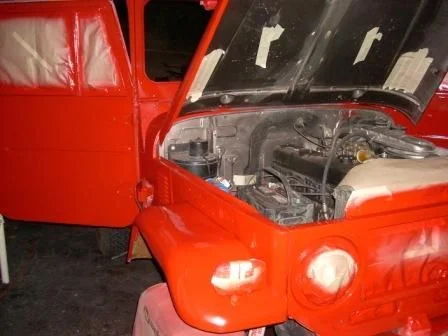

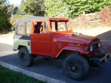

finished
This took about 4 hours and 2 coats , 3 coats on the hood and fenders today i will get all the masking off and get the seat frame painted

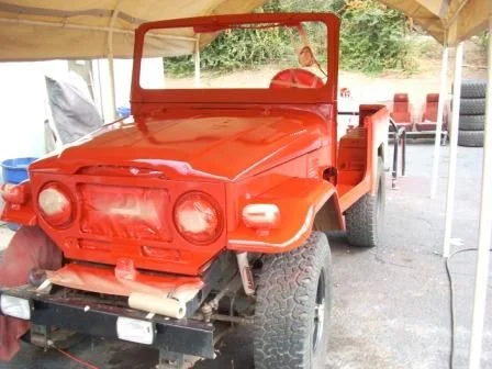

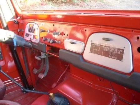

wills cruiser
we got the paint at Ace Hardware here is another pic its ciming together Will has the roll bar painted and thanks to Dan (DAnimal ) he is painting new seat frames we have the soft top bows in adn its all coming together Thanks for everyones help SnT will be Williams first drive since he now has his drivers permit

How did that paint gun work for you? Does it run on a 'normal' air compressor? How even was the coat?
I ran about 40 psi thru the gun using my sears 90 compressor and yes a very even coat. i am very happt with the gun

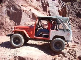

paint
Its April and the paint is holding up great ! Will has been to Calico and beyond You cant beat a back yard paint job

how much did you prep? just scuffed up the ole paint? and no clear coat I take it, right?

The paint that was on the Cruiser was in layers so William took it down to the bare metal with a box of 3-M stripper wheels, some primer and paint He has waxed it since then and its holding up well and yes no clear.
