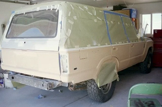

Here's a quick pic of my recent RattleGuard project. It's DIY, 2-part epoxy based, but def. spray on only. Deing a true epoxy, it should last longer than the 1-part Durabaks and the like.
It takes more prep than ROLL-ON Durabak due to overspray, and short pot-life means you can't dally while spraying.
