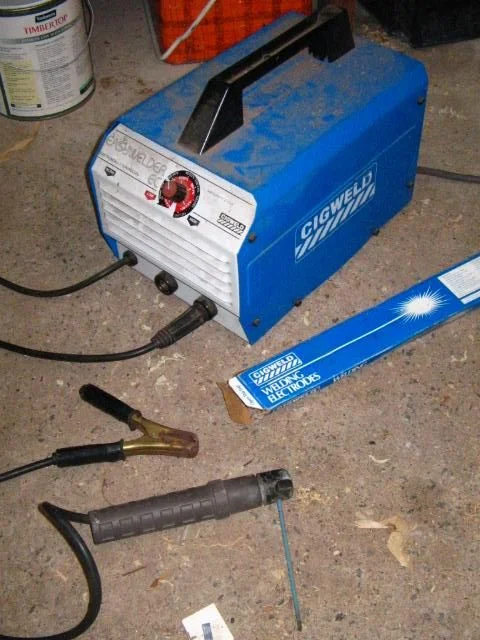

its an AC machine running 240 V, the electrodes ive got have an amp range of 95 to 125, box says there good for mild steel wanna know anything else?

ac machine= not so good, but wil get the job done.
240v=good.
what kind of rods are they?
can say i've ever seen blue rods, but there they are. there should be a number on the rod themselves that same number should be on the box.
read the box, make sure those are AC rods.

they are cigweld rods aussie stuff, the box says they do both ac and dc, are you talkin bout the classification number? cos its E4113. whats the positives of DC over AC?

smoother, more controled arc.
i'm afraid the numbers they us over down, there are not going to jive with numbers i'm accustom to dealing with.
a quick goggle seach just proved that.
http://209.85.165.104/search?q=cache...lnk&cd=9&gl=us
your 4113 is our 6013.
an 1/8" rod should run around 90 amps.
it will lay a strong bead, though it will not have the smooth look most people think of when talking abuot welding. you may have to run two pass in order to build the bead up enough to sand it smooth, for a clean looking bumper.

i'm no engineer either but we are talking big heavy cruisers anyway.
go big or go home! 1/4" all the way.
after i cap the ends of my bumpers, i have a 1/2" of plate welded on the ends.
but anyway, tack it all together then i go back and lay about a 4"-5" bead, move to the other end of the bumper and do the same. go to the middle then move back and forth cleaning your welds before welding over each one.
and when i start a new weld where another ended, i'll back up over the first weld as not to get a low spot between them.
i also fully weld the outer part of the bumper and lay some support welds on the inside.
have fun!!!!!!

Use the 1/4'' steel for the bumper . As the previous posts have said practice , practice and more practice. Nothing more embarassing than to tie a strap onto your bumper and have the welds break and the bumper fall off. Run the machine as hot as you feel confortable with , no cold welds.
For the mild steel use E6011 (AC or DC rod ) . This rod is stronger than mild steel. You can use Low Hi rod but by being a beginner if you have to weld vertical it could be nightmare.

Hi fellow ozzie,I am a boilermaker,pressure welder and for your skill level go to awelding shop and buy some cig brand rods called ferrocraft 22 they are very easy to use but you can ony weld downhand with them hope this helps.
