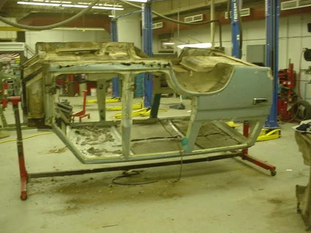

Rotisserie is the way to go.

All they did at my High School was build demolition derby cars and hack up stuff. Wish I would have had a cool auto shop teacher. Now, just a few more years of working and maybe I too can get on at a votec or hs.
Back on topic, no need to brace on the 55? or did you make a "frame" to mount the body to?

No frame.
Maybe before I take the roof panel off it'd be a good idea though.
Taxpayers didn't buy me a rotisserie. The kids made it for a fabrication project out of some old engine stands. Someone had bought some three legged ones that I wouldn't use after a kid tipped one over almost on himself last year. I can't stand to throw anything out so I still had 'em when I needed 'em.

That is clever. I have seen those three legged jobies, but would never use one. Is it adjustable in height and length? Does it just use the engine mounting plate/tube to rotate or did the get fancy with some bearings or such?
Two engine stands and two sets of big pneumatic casters and I would be able to role it in and out of the shop and over to the Costco tarp for painting.

It's adjustable for length. The big 2" chunk in the middle is bolted in. We can drill new holes wherever.
The heads just rotate on the stands. One person can spin it easily enough.
The tires are the steel casters that came on the stands. One person can wheel it around the shop. That was a huge bonus that I wasn't expecting.

cool rotisserie Gumby. Do you plan on pouring some rust inhibitor up/down the a/b/c/d pillars.

Hadn't thought of that. They really aren't a rust prone area on the 55. I might cut the B pillar open and weld a roll bar hoop right inside the pillar.
