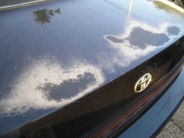

Quote:
Originally Posted by okie View Post
i am getting mine painted in base coat clear coat
specifically Dupont Chromabase
if your going with durability: imron
it will fade faster (on average) than any base coat clear but it all depends what the use of the vehicle is going to be used for
good luck
You are definitely on the right track going with an Dupont product.
But Imron doesn't fade.
Your clear coat will do this long before Imron fades.
