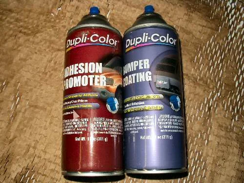

I used bumper paint and an adhesion promoter to do my duct. Turned out great!

I sanded the whole thing to remove the 'dead' plastic, used JB Weld to fill in a couple of gouges, sanded that down, sprayed on the adhesion promoter, then the top coat. It's tough stuff. There are pics of this on my web site under the heater section.
