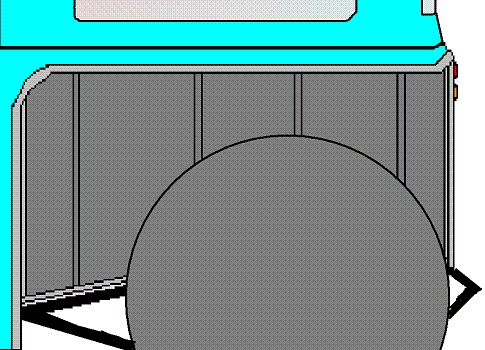

Ok so here's my idea. Move the fenders all the way to the bottom of the hardtop channel, replace outer fenders, inner fenders, and cargo area with tube framed, metal skinned box of some sort. Would look something like the following, assuming I can pull it off.
Also please ignore my horrible MS Paint skills

That's quite literally gonna be more trouble than doing it right....

Sounds like a heck of a lot of work to me. Not sure getting some replacement panels wouldnt be easier.

I'v seen serveral rigs chopped up this way. Most just hack the outer fenders up to the HT channel and box the inners inward far enough to stop them from limiting the rear axle up travel and mount taller shock towers.

What are your suspension components? I would think that you would need to do this only if you are running bigger than 37" with absolutley no lift at all adn crazy soft springs..

an awful lot of cuttin involved here, you sure about this dogg?

sorta like I did on mine. The rust demon had a party on mine so there wasn't any harm in trying. I can stuf my 42's real well and use every bit of the BBCS 15" shock travel. Here's a pic -

sounds like gunmetal's old ride, mace did the same thing, I don't think it would be that much work, I would like to do the same for when I up tire size but I would have to completly remake my cage.

Do it. I am going to be doing this mod this winter. Just like Mace, Gunmetalcruzer, and wannabecruisen. I am going to get the raised fenders CAD drawn and have it bent into shape. Already have a mock up piece done already using some old rusty fender skins

The reason for doing this is that a few bends, notches, etc and you've got a whole rear cage then just skin it to make it a "tub" but I would essentially have to re-build everything but the HT channel starting at the doors to do it right so this would actually be less work and prep to paint when it's done. I think I'm gonna get a friend to do the CAD for me so I know what I'm looking at for material and go for it. I only have puney 33" right now but I'd like to go to 37"+ tires in the future.

even with 37 would you have to cut that much out,

I've considered a similar approach using wheel tubs from Summit (or Jegs or ...). That way, the outer fender can be cut to the hardtop rail and the inner fender (so you have tire room without needing to lift more) behind the seats can be cut out for more leg room. The flat parts of the inner fender that you cut out to fit the wheel tubs can then be used to patch the inevitable rust holes where the factory roll bar attaches at the rear of the body tub. Waddya you guys think? Been sniffin' too much gear oil have I?

Probably true for the outer, but if there is a bad case of cancer what is there to loose?
My inner fenders are limiting the up travel on the rear. I am SOA with 36" TSL swampers. I pulled a couple of leaves out of my spring pack so they are almost flat with the rig static. I would like to box the inners out to get more up travel and to reduce the shock angle with taller shock towers. But with not much space for gear already I don't think that will happen.

projectdotnet,
look at post #29 I Think I Need Longer Shackles!
this is my 40 with 36" iroks with my modified 2.5" 60 springs.
i'm cut to the bottom of the inner fenderwell.
i plan to wrap the cut around the back.
but.....
your SOA and want to run 37s'
i think you'll cut to much if you go up to the h/t channel.
my .02

the advantage to doing it now is that if I ever turn it into the hardcore, lower to the ground rig I'd like to make it that I would have plenty of room to do so (for one) and for two as I said the whole rear body needs to be replaced short of the H/T Channel anyways so why not make a killer storage unit and open it up for more travel while i'm at it?
I think when i have the money for the tube i'm gonna do it for sure
