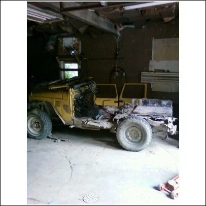

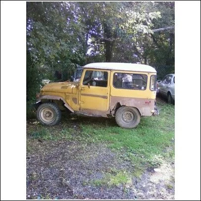

Operation FJ day:1
here is a few pictures of my 75 when it was deposited at my garage and a few after its first day of surgery...all of tub is gone,gas tank out(leaking),all 4 seats out,rockers fell off,windshield frame crumbled(damn it...i needed that)...oh well ill keep this thread updated as i progress..........

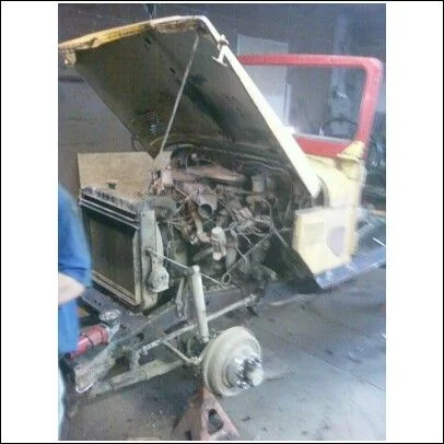

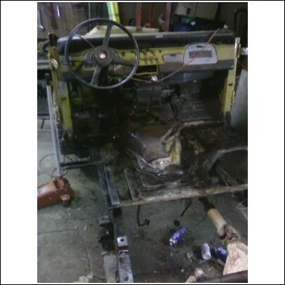

Day 2
So heres where i got to after another few hours...nearly all the metal thats coming out is out....except the rear crossmember/rear bumper which needs cut out and the last foot of the frame...then box it in,lower the rear spring mount an inch,and weld in a rear cross/bumper........also check out one of my 33" TSL's mounted up for a test fit......2 days down....298 to go

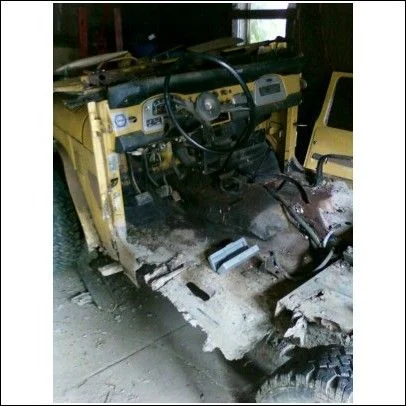

close of week one.... DAY 7
well at this point we got the frame ground down to where we want it........im replacing the crossmember that is under your floor under the rear mounts for the front seats....using 4"x4" .250 box tubing......then realized the 33's at full stuff WILL rub the crossmember....so had to clearance cut the square end to a triangle from the outer edges in to the frame mount and box it in...then i can mount my 4" .125 C-channel rockers in place running from the end of the crossmembers to the original A pillars of the 40.......at that point ill have a basis for the front floor and can relocate my original seat mounts off of the tub remnants lanquishing outside on to the floor and the 4x4 crossmember.....ill post pics of this once its done

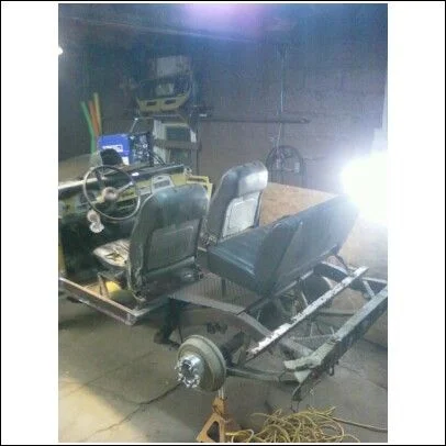

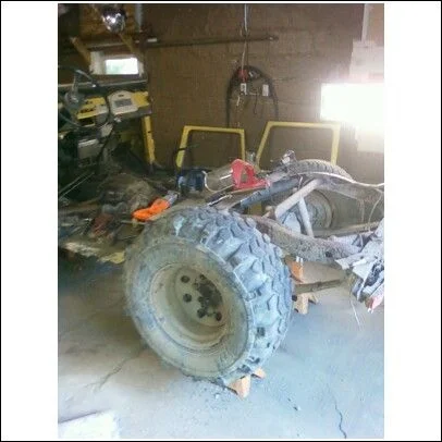

heres a pic before the crossmember was located

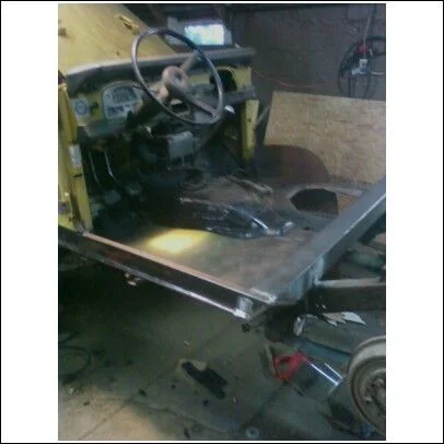

seating arrangement
Well after getting back from the 1st Annual Eastern Ohio Trail Tour...lol....I was renewed to get this buggy on its roof....i mean on the trail........the front floor is nearly done,just waiting on a few odds n ends courtesy of Tom, and ive begun to plot out rear seats and fuel cell mounting...this shows my basic idea with the cell goin in the rear....also check out the near mint bib hanging on the wall in the window...nice!

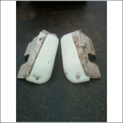

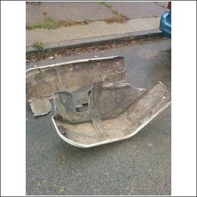

New/old fenders via Minnesota,via Arizona,via Japan
Here are some pics I took myself of my new fenders....had them shipped in from a guy on Mud from Minnesota.....using Greyhound which isnt really that bad......now i have all my front end body parts and i can see what this things gonna look like

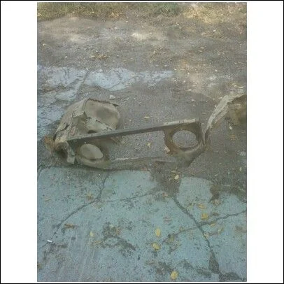

Front end Focus
here is a picture of the remnants of my bib and fenders....we had to save the aprons but have new fenders and bib so this should look half decent....for now it will look like this with no front clip at all....gonna do some frame wirewheel and grinder action,rustproofing and rust oleum,plus gonna do my mini-truck PS conversion while i have everything stripped out of there...so it will be awhile....also tried a test fit of the windshield frame....anyone got a set of windshield frame screws...had to cut out all of mine....thanx guys

Ok, I suck ive gotten nothing done on the buggy all week....luckily my uncle continues with the sanding,fixing,filling,sanding,priming,painting of my hood,aprons,fenders,bib,cowl,grill etc.....but im waiting for it to be assembled for a picture....i was supposed to do the PS conversion but ive been BURIED at the shop.....so for now i will attempt to entertain everyone with pictures of what Santa (UPS) brought for the 40
