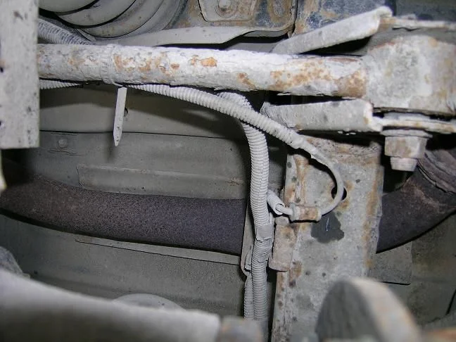

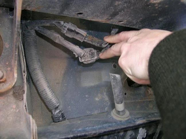

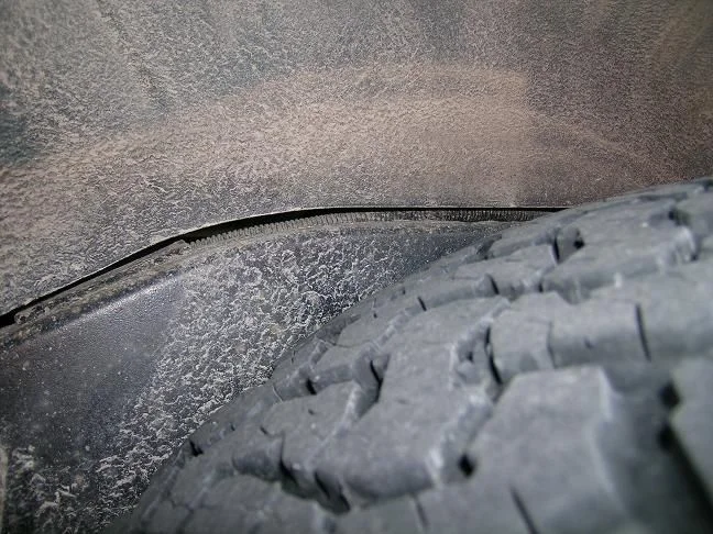

Pics
I hope these are what you're looking for.
1. is the rear quarter--you can see the drain sticking out.
2. is along the frame rail from the rear quarter.
3. is inside the fender well--you can see the harness thru the crack.

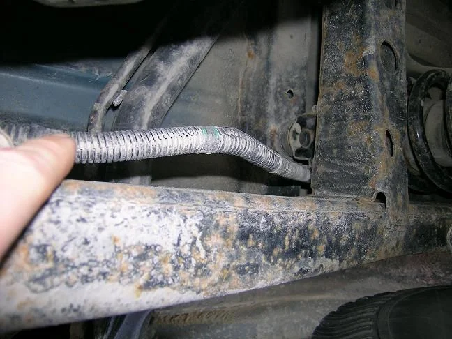

Last pic. the harness coming off the diff and up the upper control arm to the frame. you can see the companion flange at the bottom of the pic.

Posts: 664
FINALLY! A picture.
Yes a wiring harness must fabricated once the actuator harness makes inside. On all FJ80 trucks there is a way to penetrate the truck through an existing harness and it is this harness I am trying to find.
I have to plugs/connectors (from the actuator harness) that have to hook up to something outside and in the back of the truck - I just couldn't find the connection. I think this picture finally shows where to look for those connections.
