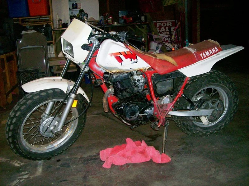

I just got (for free) an 87 Yamaha TW200 bike.
Very cool, same story, it did run but blah blah blah...

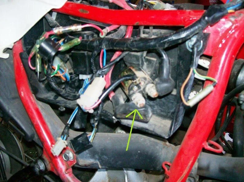

Anyways, it's at home and I've begun to start the repairs. Pulled the tank, it's leaking, I either need to seal or get a new tank.
At the moment I have no Spark. I've tried the old pull the plug, put it on the cylinder and kick it over but no fire. Even with the battery charger plugged in showing full juice, no spark. No electric start either, thats not working. When I check the coil I dont' have any power to it with key on. I would assume I should?
Now in the second picture, it shows I have power from the battery to this relay (assuming it's the starter relay) but none on the other side, which I shouldn't unless I'm trying to start.
Any other thoughts on where to go/start?

thatnks Poser, I found that yesterday. From the sounds of it, I think the neutral sensor may be causing some issues. I can use a screwdriver to jumper the starter relay and it turns over, just no spark.
I downloaded a FSM so I'll start the tear down into that.

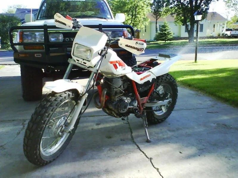

nice pics!
I got the bike started and running this weekend. Needs some adjustment here and there, but overall, I"m super happy!

thought I'd post an update...
Pro-Grip 791's
Tusk roost guards
New Oil and Filter
Seat is getting recovered
Rebuilt carb
Junkyard bar risers
Still need to do:
Baja Designs rear LED taillight
New Fork Seals
Seal Savers
New/used gas tank
New muffler
She's running pretty good, I haven't got to mess around too much yet because of the tank, (leaking slowly)
