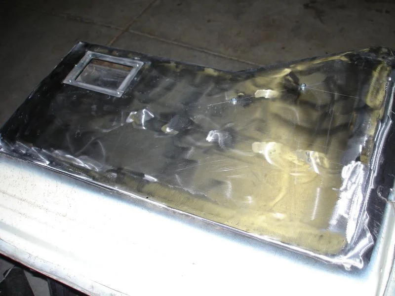

Several months ago Mark had asked me to chop his 40 doors for him, like I did Rusty's. However, I was having some execution issues until recently.
Im now WELL IN TO this project and as always, learning as I go. Found a few tricks that is making it easier, but there was a learning curve of course.
Here it is....

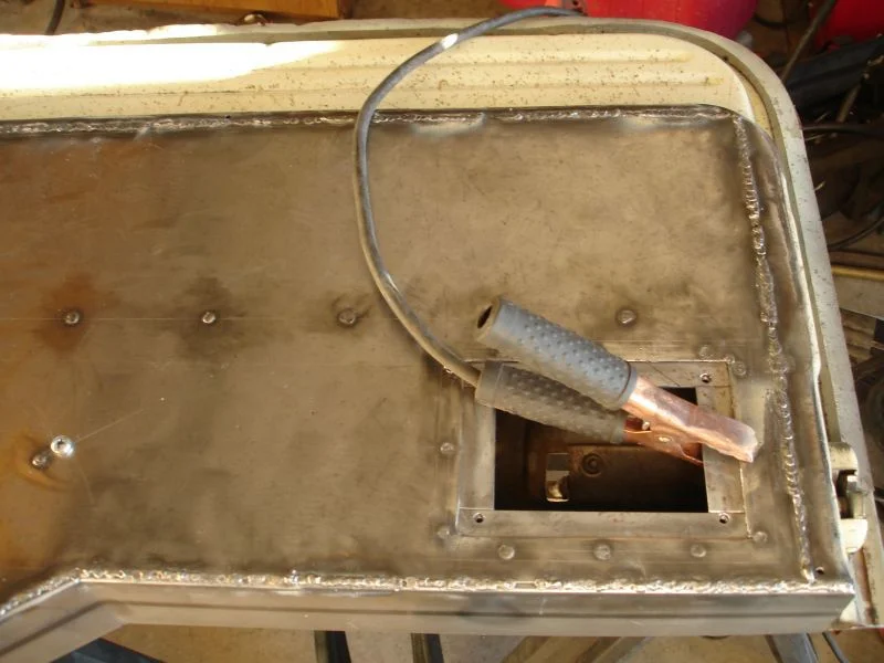

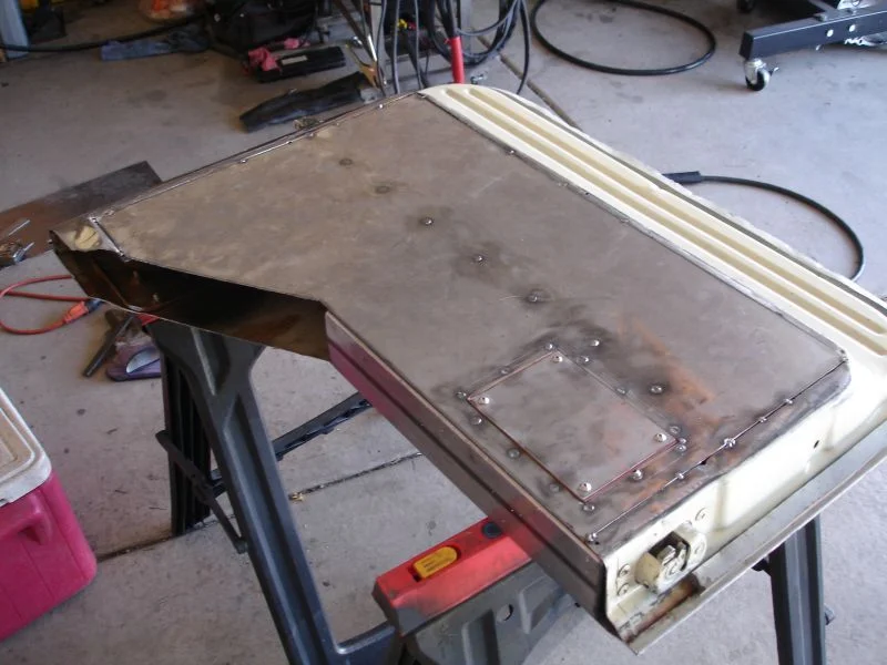

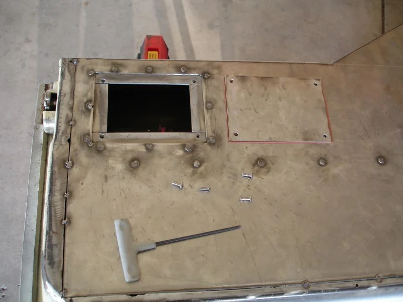

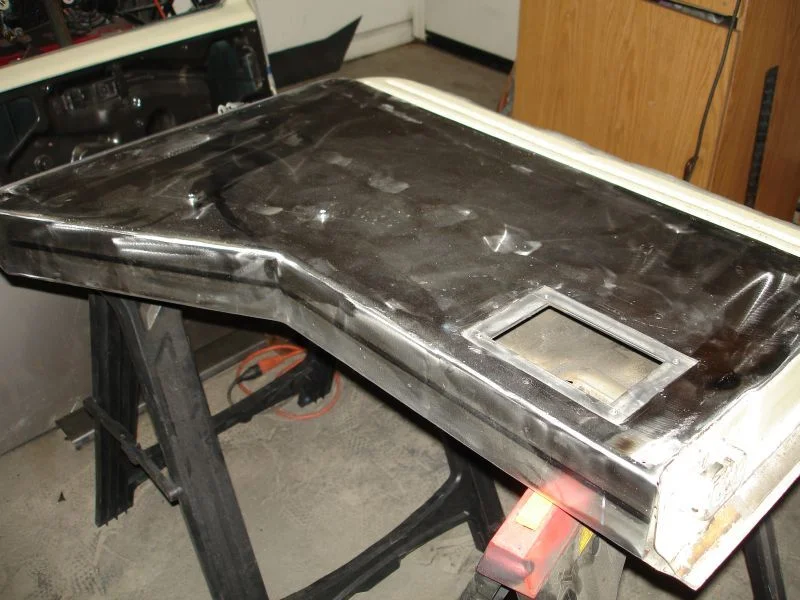

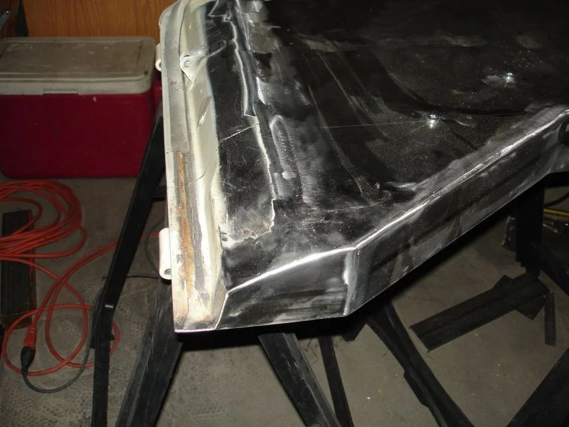

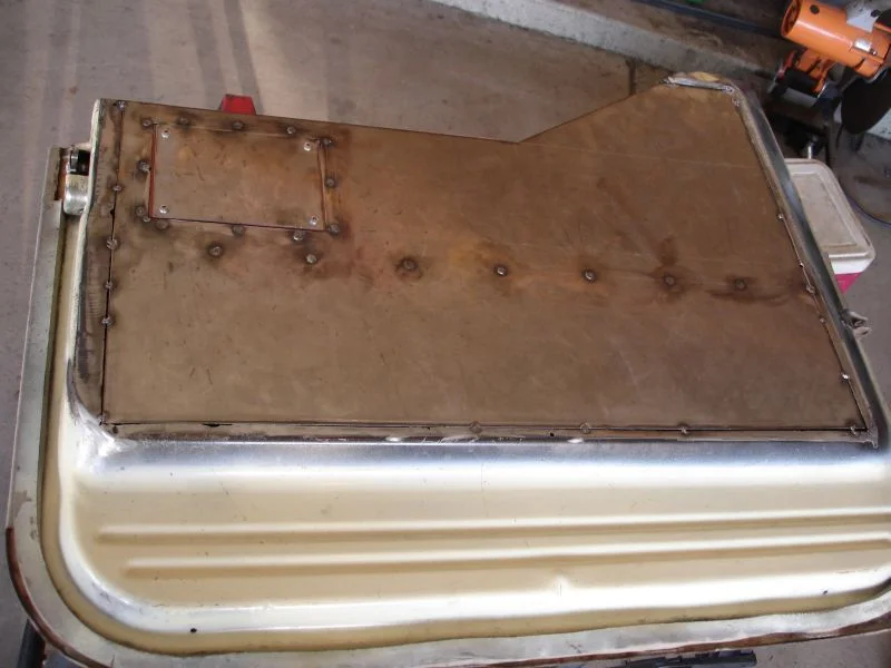

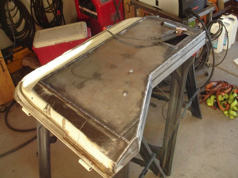

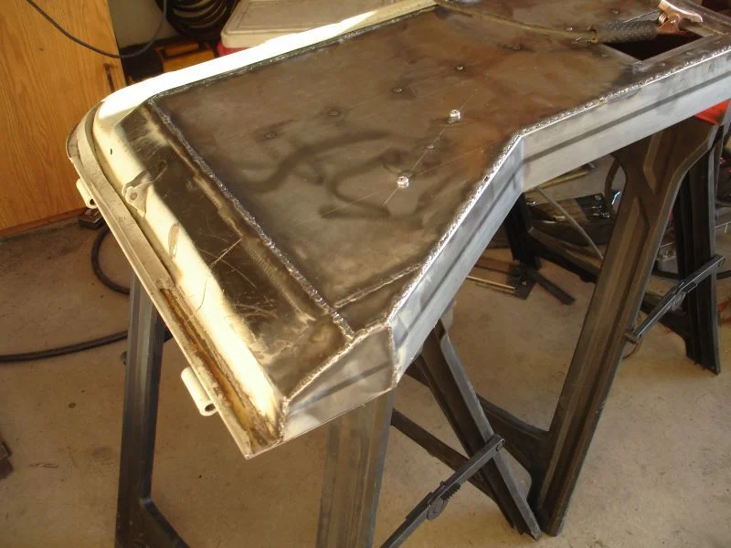

The BIG side is almost welded in...
Here are some pics. The two bolts you all see are where the door handle goes. Just gotta seal in the OUTSIDE of the cap, and finish up the fore and aft ends, then Ill start grinding.
Mark...BY NO MEANS do I want you to feel bad! Im just NOT a big fan of sheet metal work...Primarily because its not something that Im inherently good at. Im honored to do this for you, and grateful that you thought highly enough of my craft to allow me to do it. I just HATE welding the sheet metal. That is the only reason that I bitch.
K

Few pics of the finish...
It was much easier than I was bracing myself for. That 1x3 cap made a HUGE difference in how the welds came out. There was more backing to weld to that way, and thus virtually no burn through. PLUS, it made for a nice rounded/ beveled finish which was what I was after.

There are still those low spots where the weld bead is/ was. That is the stuff that the body work guy is gonna have to fill with some bondo to make it a really nice finished product.
You just cant work that too much with the grinder, or youll screw yourself.
