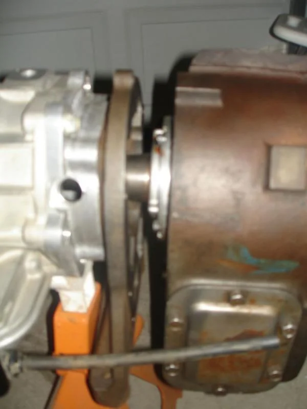

Almost...
Got my tranny to 203 adapter the other day...Went out to get it mocked up...the shaft was TOO LONG!
The 203 input bottoms out on the splines on the tranny, sooooo....gotta get a new output.
FAWK!

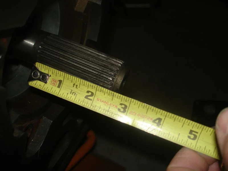

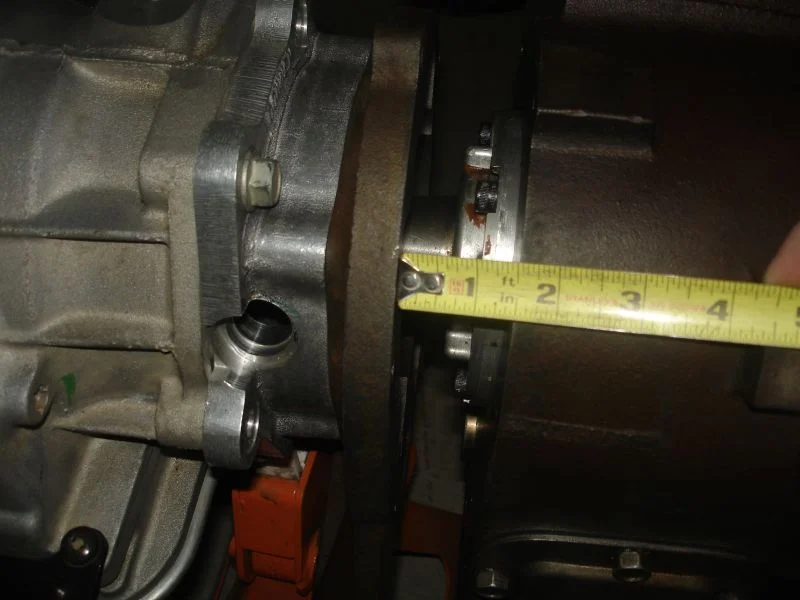

SOOOO, I went out and checked it again...
Its NOT bottoming out on the splines. I didnt check the depth inside of the 203 and its only 2 in. In theory, I could conceivably cut the required 1.5 in OFF of the shaft, but that would only leave me 1 in of spline. Beyond the splines on the tranny, there is 1 in of basically nothing till it tapers out, so I actually COULD do this.
Should I?
1 in of splines isnt a whole lot. I could maybe squeeze 1.25 if I had the cone on the 203 machined...
What do you think?
It seems kinda risky, but...

Seems kinda slim to me bro! It's hard to decide these things sometimes.....but is cheaper and easier the way you really want to go when you on the trail and those splines bomb on you????
Don't get me wrong, I like to slide my pennies when I can, but sometimes you gotta go with the $$

I've got a makita cold saw that would cut right through that and the end product wouldn't even need to be touched up afterwards.

Not knowing anything about the two parts you are trying to connect...but how long is the spline "receiver"? If it only is a 1" mate than I'd say cut it. However if the mating "receiver" is longer in terms of spline length I'd say you'd want to do it right the first time.
Aren't these swaps/installs done all the time? I wonder why they would sell you the adapter without an "FYI". Or is it just more of the 4x4 aftermarket company BS we all seem to deal with on one level or another?

The input for the splines are 2 in, so cutting the shaft will yield only 1 in of actual spline contact.
As far as the swaps are concerned...well, theyre getting to be MORE common especially for those doing V8 swaps with automatics. From what I gather, the out put shafts ARE the determining factor as to how easily and how cheap this particular swap can be done for. If I had gone with a 700R tranny, I think that my life would have been much easier as then, all I would have had to do was cut the shaft. Since my tranny is a late(R) model transmission Im trading off ease for modern technology and perfomance.
I knew about the potential for this event, but I was hoping that I could avoid it. As it turns out, I would still pretty much NEED to do the upgrades to the tranny either way to ensure longevity/ strength, so....really, all Im out is the cost of the shaft. I just didnt figure it to begin with. Only AFTER the fact (after I did some research on what the tranny guy said) did I realize this.
