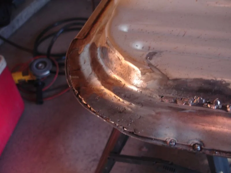

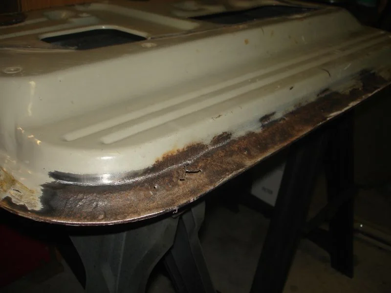

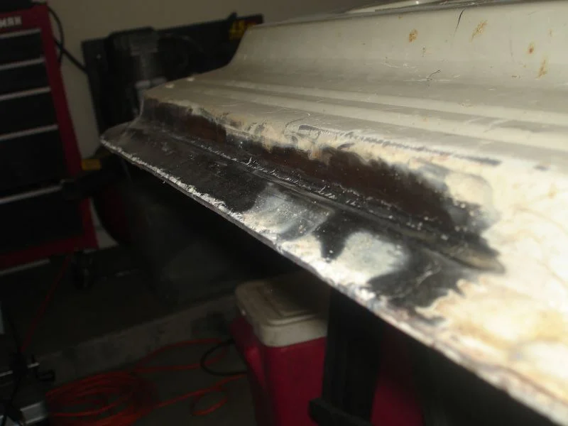

The challenge!!!!
Okay...
So the DS door wasnt as straight nor clean as the PS door. There was this NAST RUSTED ASS section on the bottom of the door where it meets the sill. How the F*CK am I gonna do this. Rusty Dan and I comiserated on the subject, and he gave me the go ahead.
I will say...This is REALLY FAWKING HARD to do, try to recreate the factory bends with FLAT 18 ga sheet metal. NOT FUN!
Well see how it turns out. Here is the task thus far.

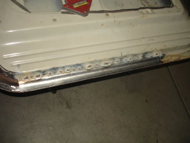

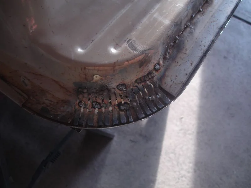

Here are some more!
This is the only way that I could think to make that bend at the lower corner. This is the spot that concerns me the most.
Wish me luck!

What are you using to make the bend?

could you cut a flat piece out that coppies that width and radius and put the curve in it?
kinda hard to explain what I mean... looks tricky for sure, but the challenging ones are what you learn and get better with!

Sheet metal break.

NOPE.
I used a flat piece that was bent with the angles in the original, and the most effective way to do it, was cut a bunch of slits in it, and make the bend around the lower edge of the door.
I tried cutting radius's and doing each angle individually, its just too frickin hard. The material is thick enough, and with all the filler that will be going in, I should be able to shape it pretty well with the angle grinder and a flap disc sander.
I could have take the easy route and just angled it in flat...
But what fun would that have been?

I didn't realize you could make "gentle" curves with those.

Well...yes and no...
It did take some "massaging" to get the slopes to match.
I picked up the HF 30 in brake...Its a POS, but it did DO the bends, so I cant say too much bad about it.
I wont be using it too much, so its good enough for that purpose.
I WOULD NOT suggest it for the 18 ga material. 16 I think it would work pretty well, but anything more....you're struggling.
Ive spent HOURS on this stupid rust section, but...LEARNING is taking place if nothing else.

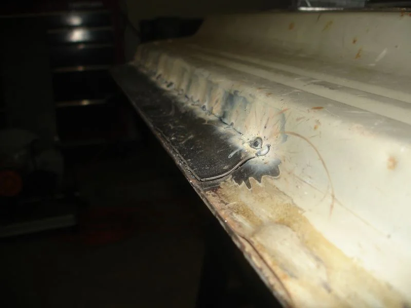

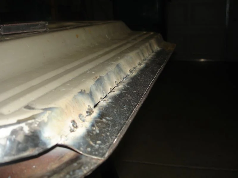

I think the straight run came out pretty good...

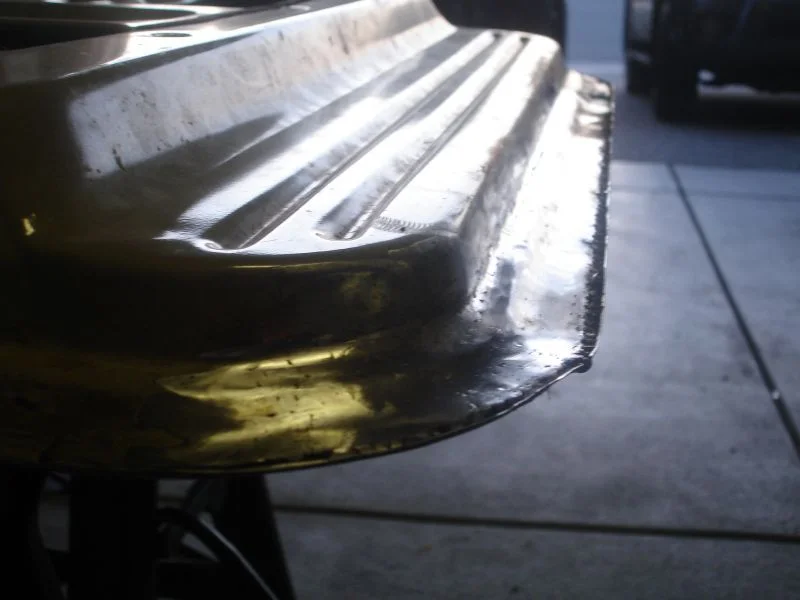

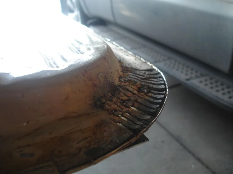

More progress!

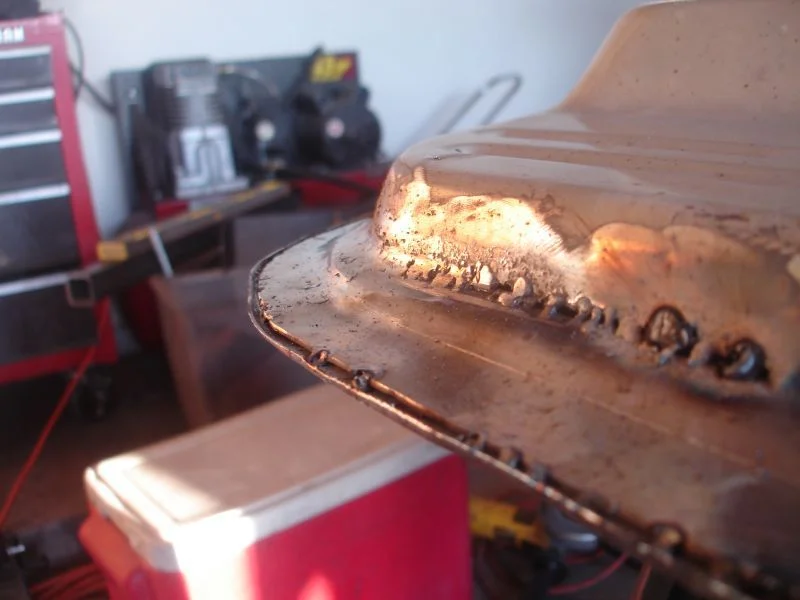

One more!

Nice Job Keith! lookin good!

Thanks...
Gonna need some bondo to fill the low spots, but...that's what's gotta happen.
It'll be better than the rust anyway.

What did you fill the slits with? Assuming molten metal, what type of welder?

Posts: 4,479
Quote:
Yeup!
Actually, some of the wider "slits" I cut pieces to fill in the gaps, other wiset was a lot of fill welding. Fill welding is stressful and tedious.
My welder is a Hobart 187 mig. I use flux core, not gas.
Turn the setting all the way down for this ga material and run the wire speed at 30. You wanna get the metal down as quickly as possible before it burns through. Its literally a ZAP, then stop.
Did I mention that sheet metal is a PITA!
K

Nice job Keith! Do you have oxy/acy? You could use brass to fill in the low spots on the bottom of the door(s) if you do. I imagine if you had a gas welder you'd already have thought of that

Quote:
Thanks Spresso!
I already took the liberty of essentially RE DOING the corner.
I didnt go so far as to cut it out and start over, but I re welded the whole section over and used the weld to build up the low spots.
Im feeling better about it.
Regardless, that is a rather good idea brazing the low spots in...
I actually hadnt thought of it.
There is gonna be bondo, but at least I wont have to use it to build up the shape that I was trying to achieve. As it was before...well, it just looked SHOTTIE.
