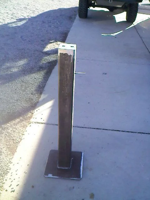

Finished building the base today. All I need to do is figure out where I'm going to bolt it down... I'm still waiting to hear from Samco on tubing. Sam said he could get me some for cheap, but haven't heard back yet. Going with 1" .095

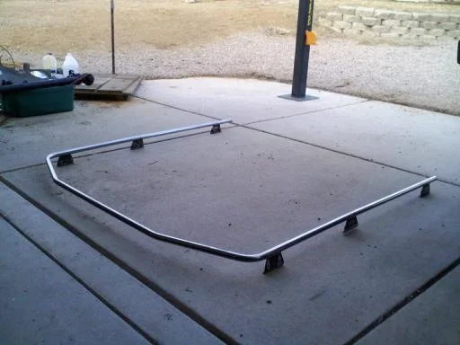

Forum Regular
Join Date: Mar 2008
Posts: 111
Nice work.

Are you gonna bolt it down?
Whats the material you used?

not yet, just waiting to hear back from Sam (Samco) on the tubing. I built the base out of 5/16 plate and a section of 4"x4 3/16" squared tubing. Welded the nuts to the top plate before closing it up. Drilling 3/4" holes through that plate was not fun....

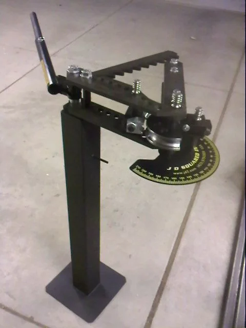

Hmm, what size die(s) do you have for this bad boy?

I ordered a 1" OD 3" CLR die set with it cause i'm planning on building Rover roof racks with it.

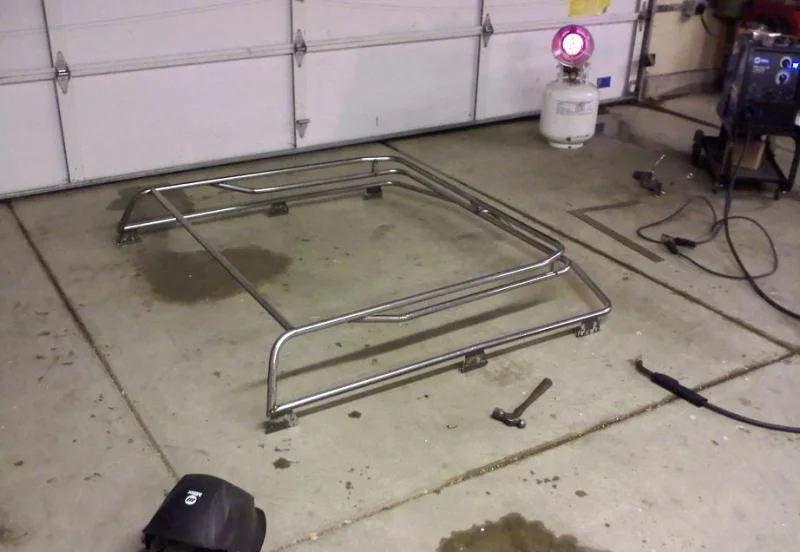

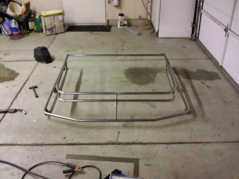

little sneak peek....

Looking good. Takes a little while to get the hang of it (I still suck) but when you do, it's amazing what can be done.

Nice job. I would really like a bender will by my next big tool purchase. Are you finding the technique fairly easy to get down?

If you want tobend simple parts (that are on one plane, for example) it's not hard at all. But if you plan on building more complicated parts, then the software comes in handy big time.
Having the angle finder that clamps on to the end of the tube is a must if you want to keep the same plane, or rotate to a new one.

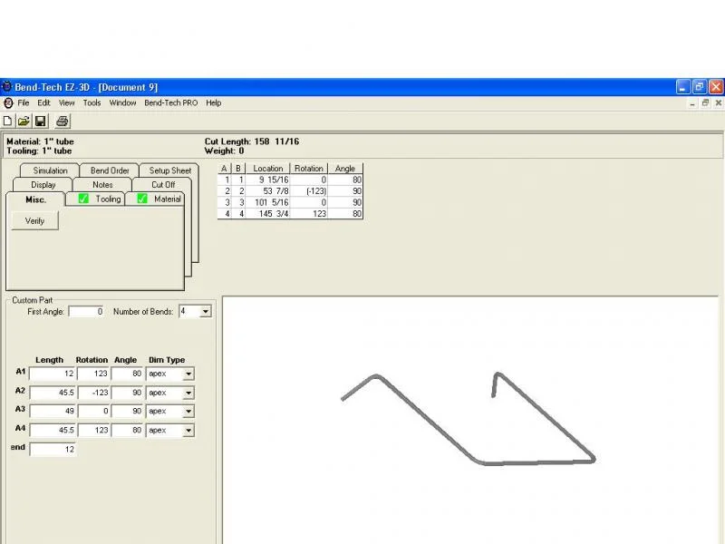

Looks great man!
What does this program do that youre talking about?
How does it assist with the process?
K

here's the website.... Bend-Tech Home
it basically allows you to build the part, or pieces of the final project (or the entire project if you buy the expensive software) step by step and angle by angle. The EZ 3D is what I have, and you can draw out pieces in 3D on your screen.
here's a snap of the piece I bent in the photo.

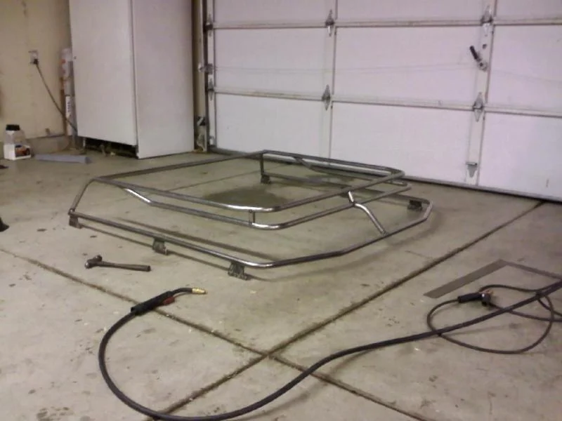

what a good way to spend valentines day.....

That's "hot"
Nice job amigo!

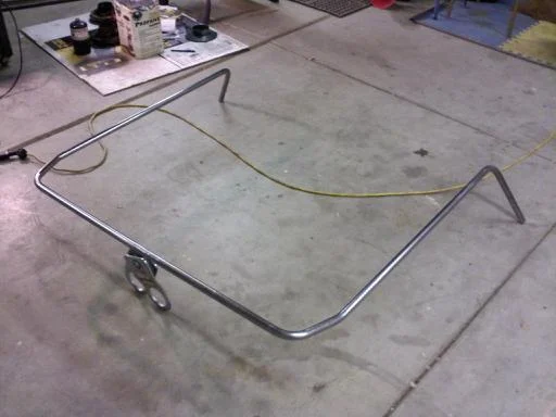

more pics from last night.... Just need to add some more supports, cross bars, and then mesh flooring. Wish I could be working on it, but I'm sick....

Wow. That looks great. I might have some future work for you.

Looking better all the time.
What kind of finish do you have planned?
Hope you feeling better soon, the one going around right now is bad.
