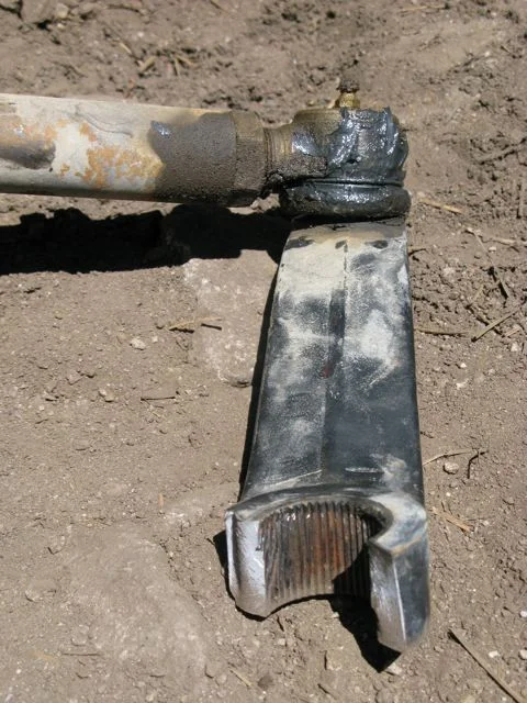

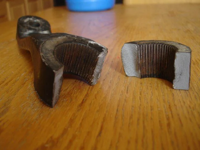

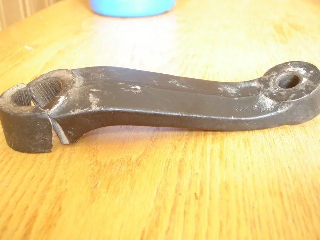

SNAPPED the pitman arm CLEAN OFF on the back side of the spud shaft!
Of all things that I thought would NEVER fail....the FAWKING PITTMAN ARM!
Theres just NO trail fix for that!

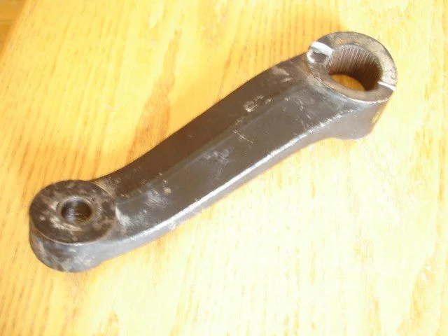

That's a tough break. Last year at Dusy, Alvaro snapped the sector shaft (that's the shaft the pittman attaches to at the steering box). You really can't even drag a rig with that broken.
I have a Pittman arm you can use, but I'll need it back (it's on my spare steering box)
Regarding the 2m, it totally rocks, as your experience demonstrates.
Post a pic of where the break occurred.

Keith: Glad, of course, that things turned out OK in relative terms . Sean Pritchard (silverscout) and hoser (Les Wong) along with their wives Kate and Julie are great folks. Was Sean driving the black LX (80...which used to be Les')? And if so it had no problem negotiating the terrain?
If you keep this up Keith I'm going to have to make sure my next 'Yota isn't 60-related .
And...now you know first hand why we've been bantering you about getting your HAM license!
Back to pitman arms: Do they make stronger arms for lifted/bigger tired rigs?
Not that I have ever seen. The 80 series Pittman is considerably beefier and fits the splines of the 60 series box. I'm just not sure if the drop is enough to clear the 60 frame. It would be worth experimenting with, though.

Yeah, I remember hearing that story about Alvaro and his wife saving him...
Theres just nothing that can be done.
Thanks for the offer on the loan, but Marlin Crawler is making good on it.
I called them today...
As it turns out, they were getting those arms from a different manufacturer two years ago and they did a recall on them for breakage issues and they no longer use that manufacturer.
So, theyre gonna ship out a new one, like the one Dylan has, free of charge.
Im thinking about going with a CNC'd pittman arm as opposed to the forged type, like the ones from Sky off road....

Quote:
Originally Posted by rusty_tlc View Post
It could have been interesting if it had broken on HWY4 between Markleeville and Hermit Valley.
Interesting INDEED!
Here's the arm.
I didnt have a camera for pics this weekend. I wish I did!
K

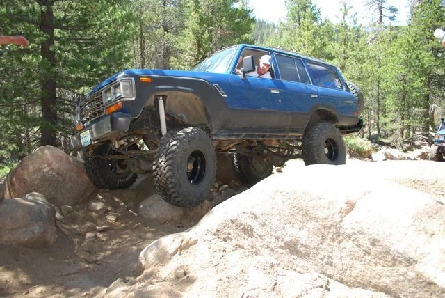

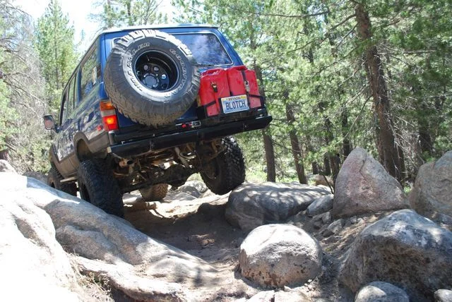

Keith, glad you were able to get your rig home that day! Here are some pics from Sean's camera.

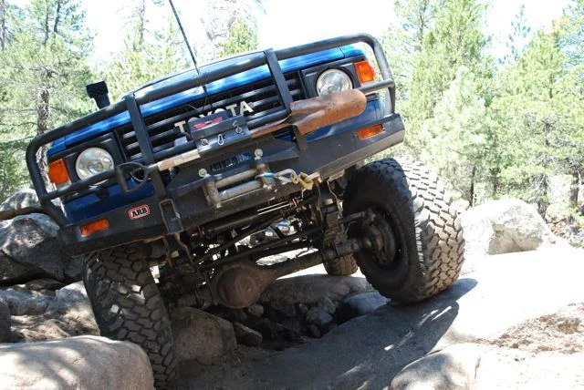

A couple more...

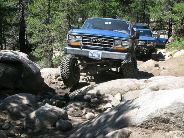

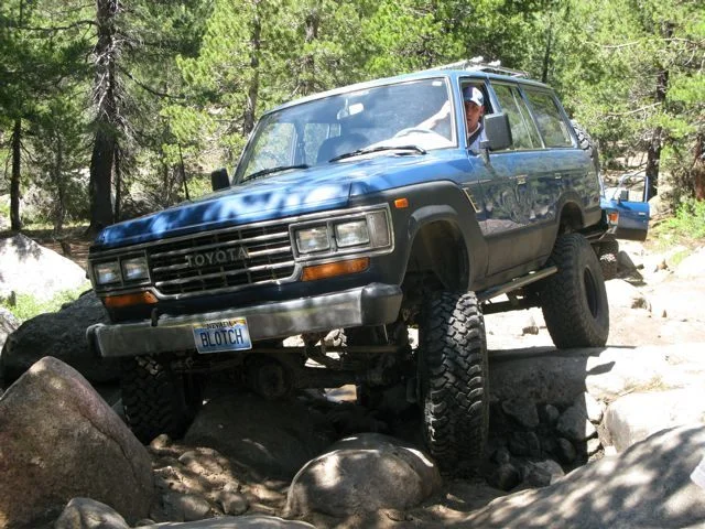

Me gots some pics as well....
ken

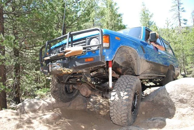

mooore

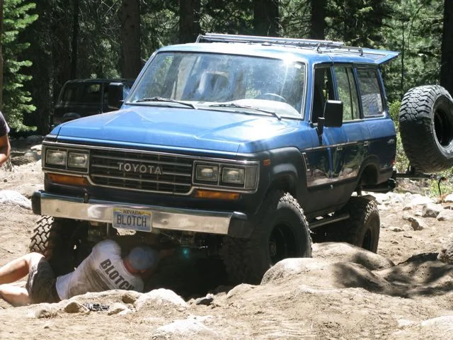

and more

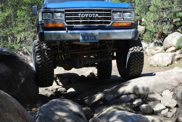

Quote:
Originally Posted by hoser View Post
A couple more...

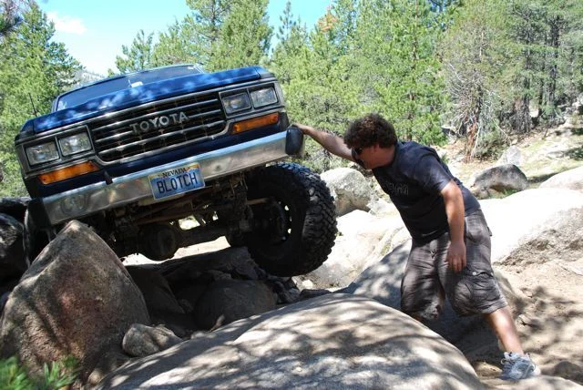

Thanks for Posting those Les!
Ive been thinking about this all week and wondering if the front end had been in a weird position or not.
From the pics...it looks to be rather routine...wheels relatively straight, not too flexed out.
All I know is that I DONT want it to happen agian!
Thanks for all your help out there!
Keith
