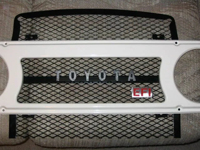

More play today. Taking a clue from our BJ friends I put an EFI badge on da'40's grill. The badge is from the top of the intake on the 3FE motor. It's mounted to a piece of 1/8" steel with two holes drilled in it. The holes have #10 flat head machine screws, counter sunk, welded, and ground flush.

that looks awesome Jon

Very cool! As soon as people see that badge, they'll be asking you to pop the hood so they can see what's underneath.

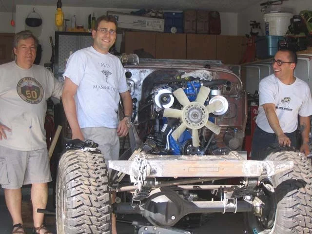

Engine is in! Thanks to Graham, Onur, and Mike M. for taking time out from their beauty rest. More pics later.
Jon

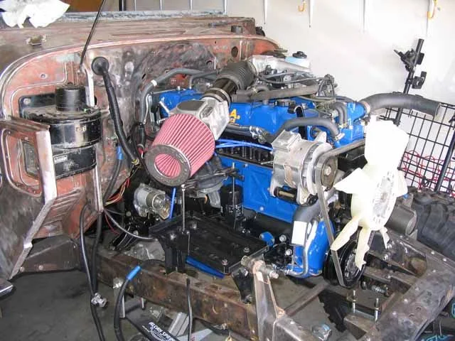

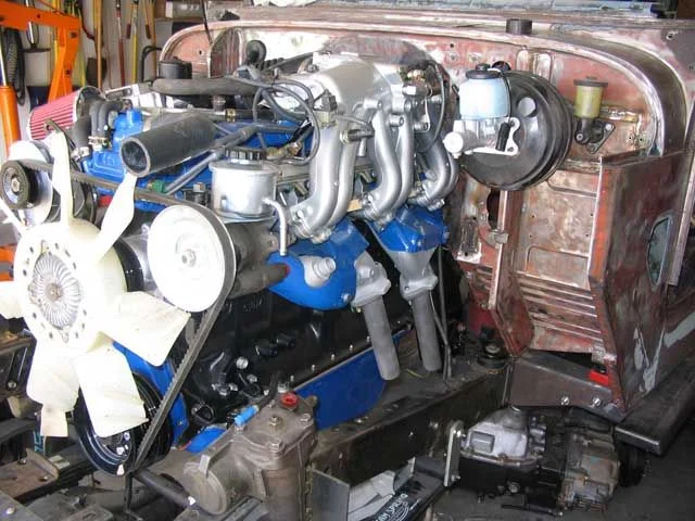

Picture-proof I haven't been a lazy butt!
PICS!

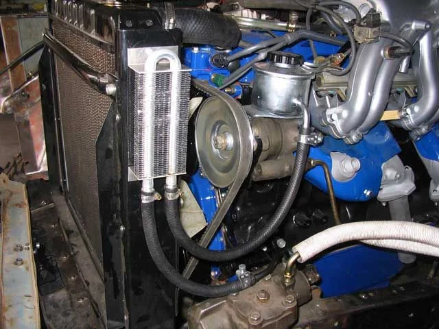

Power Steering
Power steering loop is now complete, with cooler.

did you purposely use a cogged belt? or was that what was available?
and this is the PS from a 60? Did you get to keep the stock column/ wheel?
