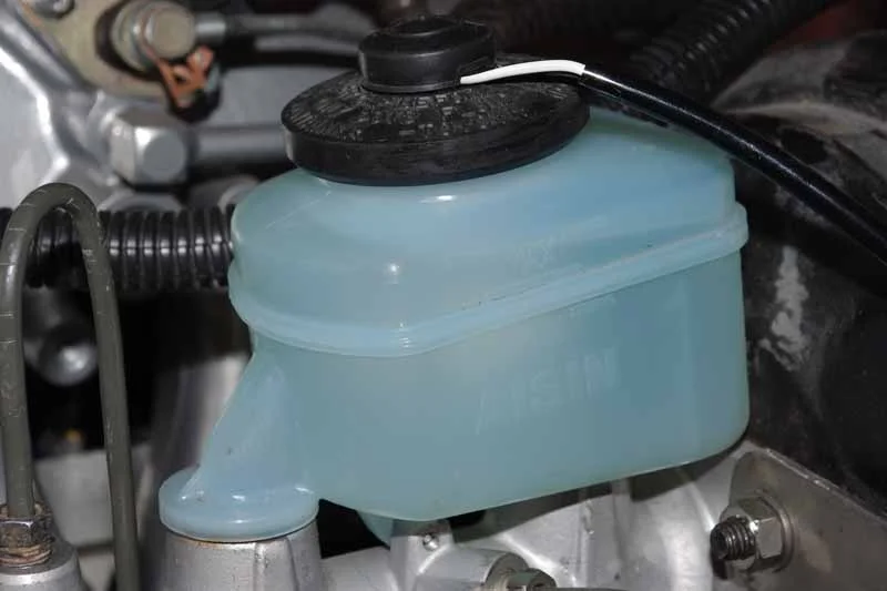

As promised. BRAKES!

Quote:
Originally Posted by Ruadhrigh View Post
I think you are low on fluid...
And just to make Rory feel better ...

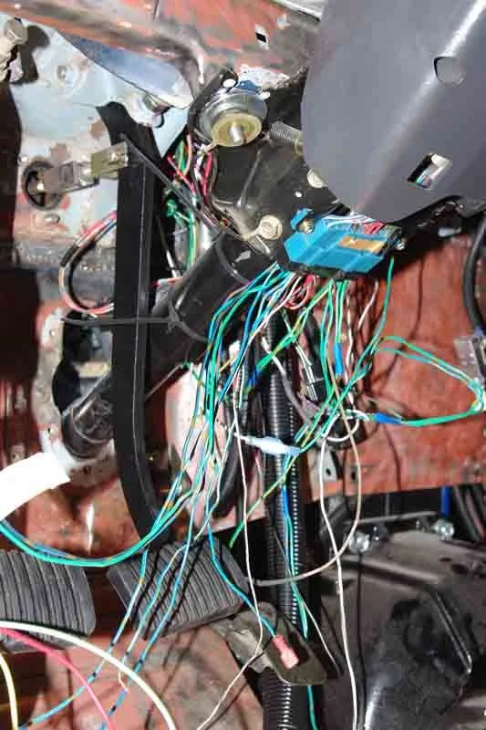

More pieces to the puzzle.

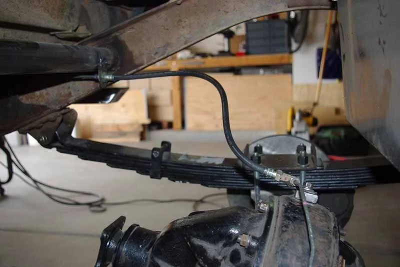

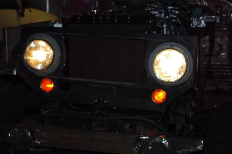

Recap of Today
I finish the rear brakes. It turned out to be more complicated than I had hoped. I worked on them last night and realized that the 3-way split on the rear diff wasn't going to work in the factory location. The 3-way was located right where I need to mount one of the shocks. So this morning I went back to the drawing board.
The solution was to drill and tap a 1/2" piece of steel and weld it to the top of the diff housing. I also realized that the Chevy calipers were set up for a front exit on the banjo fitting which put the line right into the axle tube. Solution was to grind in a notch so I could bring them out the side parallel with the axle instead of directly into it.
After I was all done I filled the master cylinder and bleed the calipers. The only leak I had was at the proportion valve. I don't have a 3/8" flare wrench so it wasn't tight. It is now.
On to electrical.

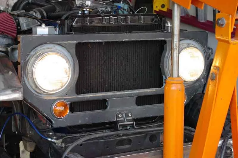

Headlights are roughed in. The goal was to get them figured out. Tomorrow I'll make them pretty. I need to figure out where I'm going to mount the relay, either under the dash, or on the firewall. Same goes for the taillight relay. I suspect they will go on the firewall. I did get the OEM flasher wired. I also got the horns wired, though I found out one of my horns doesn't work. I have a pair of FJ62 horns someplace but I couldn't put my hands on them.
Tomorrow will be taillights and turn signals ... and making things pretty.

Beowulf is offline   Reply With Quote

Update. I just can't seem to stay away now that I'm motivated again. Parking/tail lights work. I'm a little concerned about the haz/turn signals. I couldn't get the flasher to work and I'm hoping it's because I didn't have any lights attached.

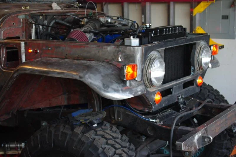

One reason yesterday took so long is because I decided to DOCUMENT what I'm doing this time. Sample:

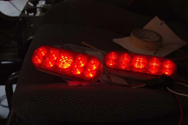

More JOY!
Except for a few very loose ends like the license plate light, and the backup light, the lights are DONE.
Figuring out the turn signals/hazards was a challenge, but in the end was easy to solve. The fuse block I used had separate wires for the turns and the hazards, each with it's own fuse. It took me a long stare at the wiring diagrams to figure out that the wires go from the fuse through the flasher then out. That was the problem. I was trying to double flash the lights and the flasher just buzzed. A simple jumper across the flasher terminals on the fuse block solved the problem. As expected the turn signals are real fast due to the LEDs in the rear end. I found a LED flasher online, snagged the part number, and will see if I can't find it local and save the shipping.
Two pics. One of the LED brake/parking lights for the rear end. Second of the lights on the apron, bib, and fender.
