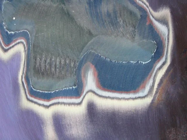

bummer, did it damage the pushrod?
Quote:
Originally Posted by pappy View Post
One of the valve adjusters (#5 exhaust) was very loose. When I found it the adjuster was sitting on the rim of the pushrod instead of in the bowl.

Don't know yet.

Yes. Rod was ever so slightly bent. Replaced with a new rod.

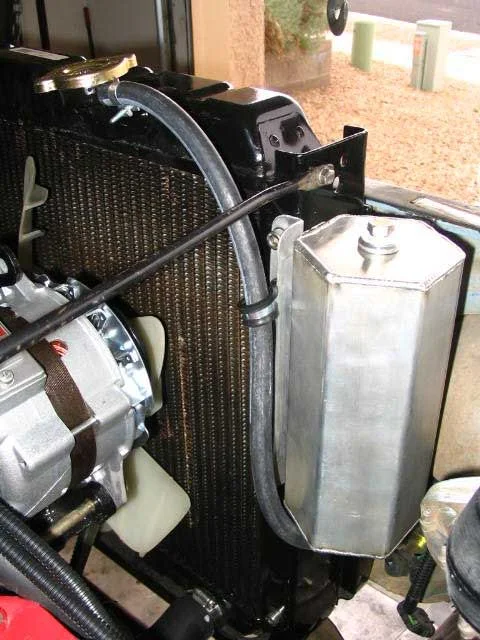

Overflow can installed, from JEGS. I chose not to get the purdy one. Does anybody know of a source for thin wall tube? The stuff NAPA sold me was the thickness of fuel line. I've considered just getting some clear tube. Size is 5/16".
That one is still purdy in a utilitarian way
Check Lowes - they tend to have a good varierty of tubing.

Just go with clear. That's what toyota used 40 years ago.

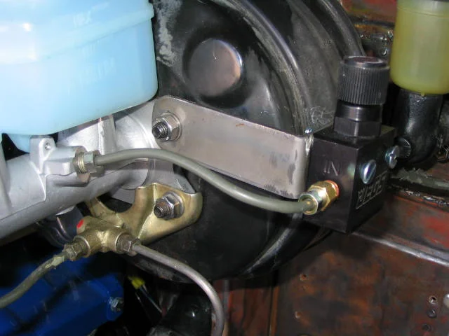

Another baby step. Did I mention how much I hate bending brake lines? Well, add flaring them too. Pics of the proportion valve for the rear brakes.

yuck, flaring brake lines. be sure to do the fancy double flare. i had problems with mine leaking until i did that. looking very good and proffessional!
Nice bends.....
I hope mine turn out as good.
What tool are you using Jon? I assume you are using metric fittings?
Thanks.
-onur

Yep, double flare, though I've split a few bubbles and had to start over. In reality, what I have now will be redone with new tube. That 20 year old tubing doesn't flare well.

A tool I've seen in catalogs that I picked up at some autoparts store. All of my fittings are boneyard Toyota, so yes, metric. Note that the fittings to the clutch master/brake master are different than every place else (gee, how did I figure this out?).

Just a little body work today. Stripped the paint off two doors (I have four). One of them had been painted several times. I count six times. Beige, black, smirf blue, red, dark blue, green.

Yep, still don't like bending and flaring brake lines. Barring any goof-balls on my part the front brakes are DONE. Lines came from Marlin. Way overkill, but they match the engine.
Now to the rear.
Drivers side:
Passenger side:
Line from the master to the frame:

Quote:
Originally Posted by beno View Post
Looking good Jon. Is that an 80 series MC? Can't tell from the picture... -o-
Quote:
Originally Posted by Beowulf View Post
... it does have a beautiful, new brake master cylinder from an 80 though.
-Mike-
Ya know, there was discussion recently about all the parts that have gone into this truck. Early FJ40, late FJ40, FJ60, FJ62, FZJ80 (e-locker, brake master), non-USA (H55F, TC parking brake), mini-truck.
Yep, disk brakes on all four corners with the FZJ80 master cylinder.
I "finished" the rear brakes yesterday afternoon. For the rear brakes I used flex lines from Downey to adapt the Toyota 10mm to the GM banjo fitting on the calipers. There has to be a better way. IF I was spring under the Downey lines would probably work good. But with the spring over they just don't line up well and I have too much line. I'm getting better with the bending tools so I might look at other options for adapting the banjo fitting. What would be nice is a short rubber hose with the banjo fitting on one end and a 3/8" female on the other. I might need to walk the GM section at the boneyard [gasp] and see what I can find.
