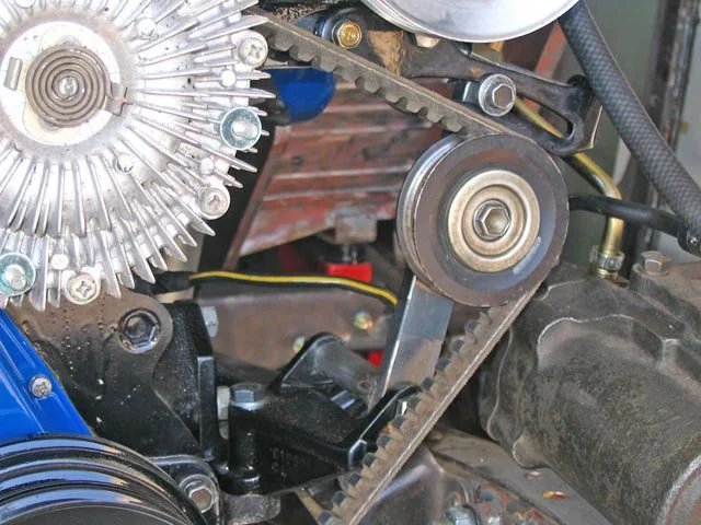

Garage
Water Pump Idler
More progress after work.

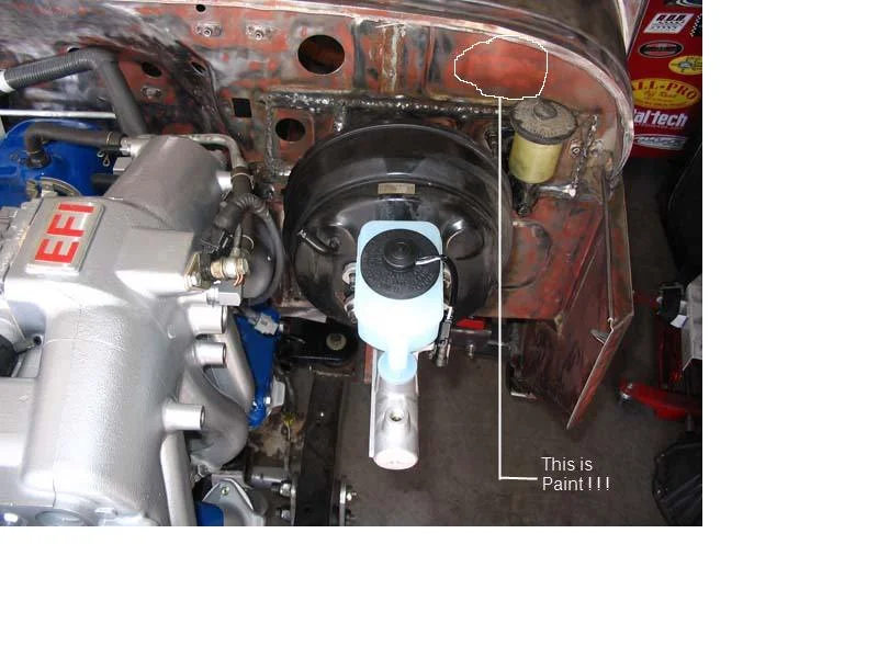

Posts: 1,243
It's going to be difficult to paint the firewall with all the engine parts in the way. What's your plan?

Posts: 1,243
Not even primer? From the pictures it appears there are some bare metal spots. Is this the case? After you've put all that work into that beautiful motor, you're going to lift the hood to show it off and have the unfinished look of the firewall and fenderwells.

Posts: 11,846
Why waste good money on paint to cover something that nobody will see unless you open the hood? How many times do you open the hood anyway?
Good Point - not to mention rust...

what about some bed-liner material? you could paint it on at home and would help with heat...

Clear coating it was also suggested awhile back.

Quote:
Originally Posted by pappy View Post
Ya, but I only need to do that once. After everybody sees it, it will be old news, and most folks have already seen it.
Exactly. Keep a picture of the engine in the glove box (that thing has a glove box doesn't it?) and pull it out any time someone wants to peek under the hood.
Save the time and money you would use painting the firewall to do important things.... like getting the engine running!!!
-Mike-

Quote:
Geez. How much more paint do you guys want? It's not like this is some kinda restored classic truck like a nice 80 or something. This is an old 1965 FJ40; a TRAIL TRUCK; not a show truck.
-Mike-

At least do something to cover the bare metal. I like the hand applied bedliner idea Rory mentioned. Then it won't matter what color you paint the truck since the bedliner stuff is black. Didn't Greg do that with the outside of his 60? Or maybe just some of the POR 15 (or whatever the number is) rust inhibitor I see mentioned a lot on MUD by people doing rebuilds and restorations. Spraying paint on will definitely get overspray all over the fresh engine unless you spend a lot of time covering and masking. And you will probably still get some, despite how well you cover everything up.

Brush on bedliner matl. Does it come in Voodoo Blue?

Quote:
The POR 15 Marc mentioned is "tintable", so you can make it whatever color you want...
and yes that includes Vodoo Blue!

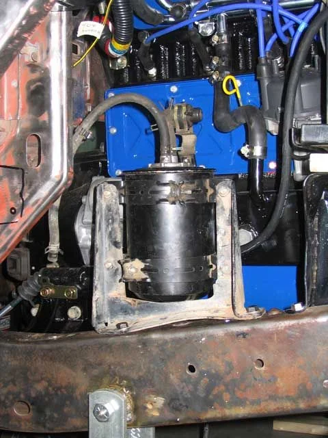

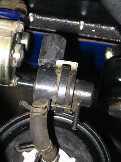

Charcoal Canister Installed
You would think this was the way it's supposed to be. I tossed in a pic of the VCV on top of the canister. Ya, I could probably eliminate it, but it's there. There are four ports on this thing.
  • One comes from the purge port on the cansiter.
  • One goes to the manifold (purge).
  • One comes from the BVSV.
  • The forth came from the air cleaner. Well, what port on the air cleaner? My solution? I grabbed one of those little air filters that fits on vacuum switches and put it on. Another undocumented solution to a problem.
