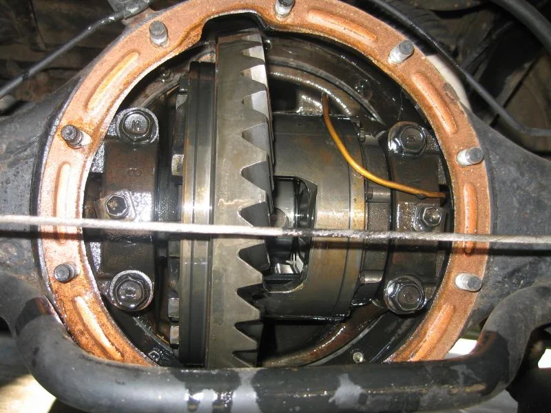

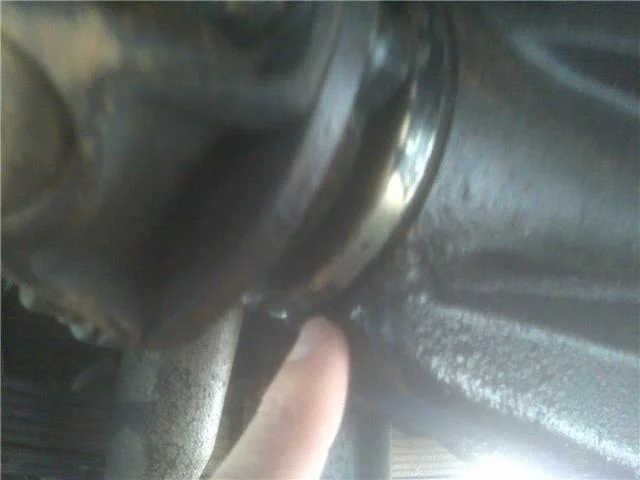

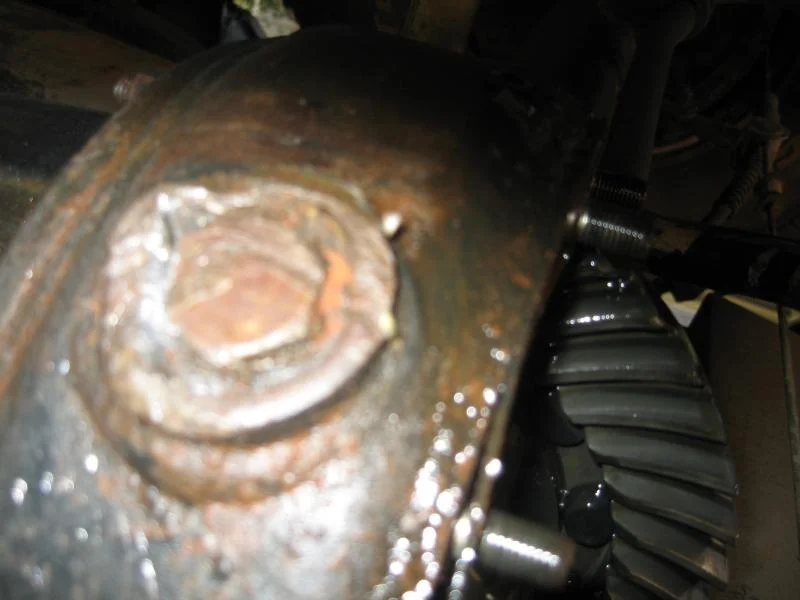

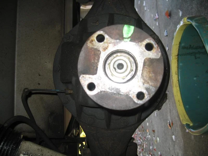

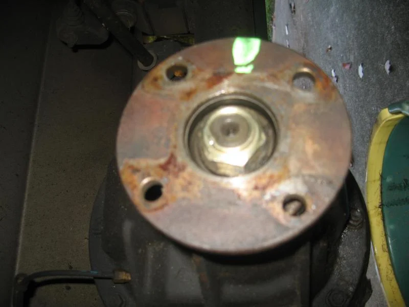

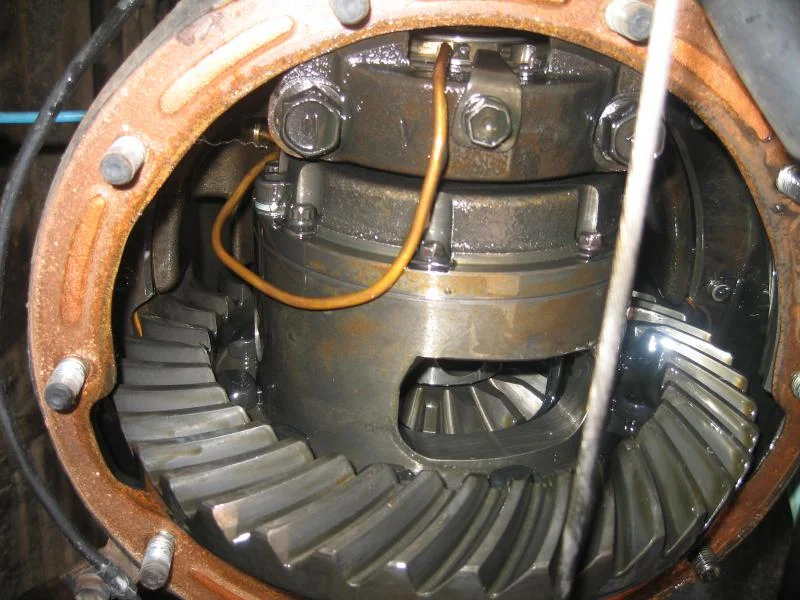

Pics from today
Decided to just start getting dirty. Got home and took off the rear diff cover, disconnected the driveshaft and snapped a few pics.
Gears look perfect, driveshaft has no play at all in it, Fluid was a little dirty but there was nothing in it at all. I rotated the wheel and inspected and its all pristine.
On another note i will post a pic. Anyone got any tips for resolving an issue where i bashed the diff drain plug on a rock and it partially welded itself shut? I beat on it with a chisel for a bit but wasnt making much headway...I think a dremmel tool might be too light duty.
BRING ON THE THOUGHTS...

A couple more shots...The fluid is coming from right behind the drive shaft flange

Old 10-28-09, 03:03 PM   #20 (permalink)
250+ Club
77cruiser's Avatar
Join Date: Jun 2006
Location: Charlotte North Carolina
Posts: 930
last one
Thanks for your patience and help...I am a novice mechanic at best so I am prob over thinking the problem
My finger is pointing to where the leak is coming from. It looks like the fluid is coming from behind it.

Old 10-28-09, 03:33 PM   #21 (permalink)
Forum Lifer
Join Date: Apr 2005
Location: Nam, NC
TLCA# 5330
Posts: 2,600
As long as you can not push the pinion up and down you should be good just replacing the seal, Also need to see if the flange has some wear on it to cut the seal up. If it has some wear on it they have sleeves you can use to fix it.

Old 10-28-09, 03:36 PM   #22 (permalink)
Forum Lifer
Join Date: Apr 2005
Location: Nam, NC
TLCA# 5330
Posts: 2,600
Now on the drain plug . However you can get it out is good. Alot of companies out there make a good replacement type plug. Might want to think about maybe welding some type of ramp thing around it to help get over it on the rocks.

Old 10-28-09, 03:38 PM   #23 (permalink)
Forum Lifer
Join Date: Apr 2005
Location: Nam, NC
TLCA# 5330
Posts: 2,600
Another thing to think about while you have it out to fix. Check the wear pattern and also the backlash. Just a good thing to do while you have it out. Then again if you are replacing the seals then you are going to need to check the backlash and stuff.

Old 10-28-09, 08:36 PM   #27 (permalink)
250+ Club
77cruiser's Avatar
Join Date: Jun 2006
Posts: 930
yeah... theres an ARB in there... Blew the seals on it a couple months ago so it will get fixed during all of this mess....
So to answer my question it sounds like, YES I do have to completely removed the 3rd member?
