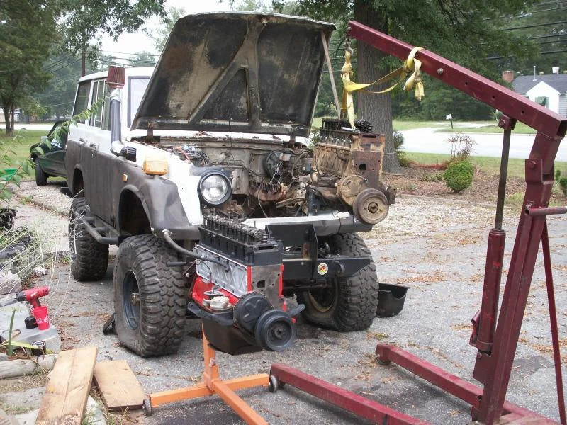

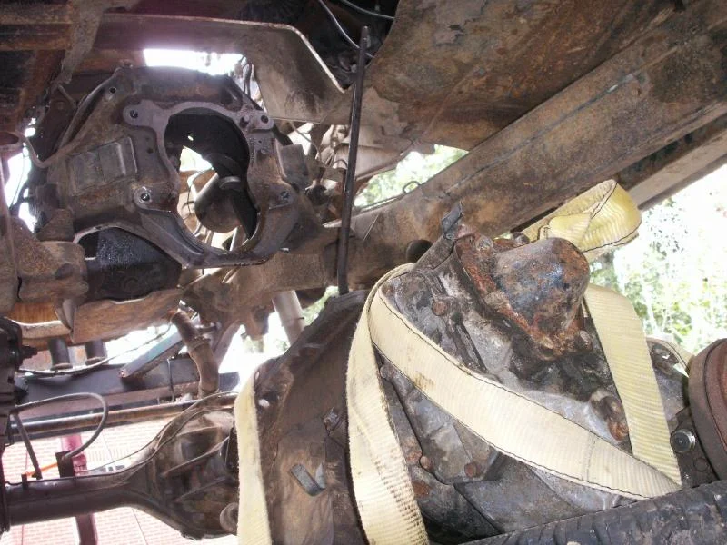

So ive been busy trying to revive the pig and get back in on some trail action this year. For those that dont know the 1f went out at Uwharrie last December when Steve and I ran down for the day. I picked up a 79 2F from Flinny and took it down completely, had it cleaned, new cam bearings pressed in,new freeze plugs, and the head rebuilt. Finally got it back and put in new bearings and rings and got it all buttoned up.
I managed to get the F out and the 2F in by myself and get the clutch, tcase and tranny back in and now am at the final stretch (and did i mention sore???). Im waiting on some manifolds to show up so i can bolt em up, toss on the carb and finish plumbing it up. Im at the point now where I'm going to have some ?s. I took some pics but still got to wire and plumb it all back up and set the dizzy/timing up before the moment of truth. If it runs as good as it looks ill be happy
Any and all suggestions are welcome
And many many thanks to Flinny, Mdemeglio, Trollhole, S4 and others along the way that have helped w/ tools, knowledge and patience.
heres what we started with....

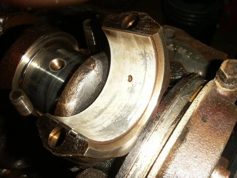

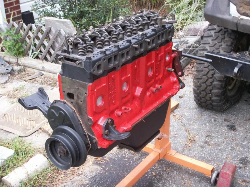

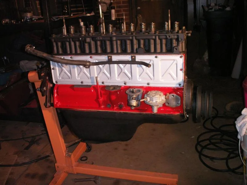

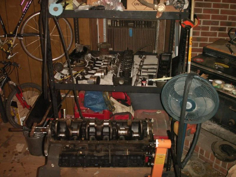

and some shots of the rebuild....

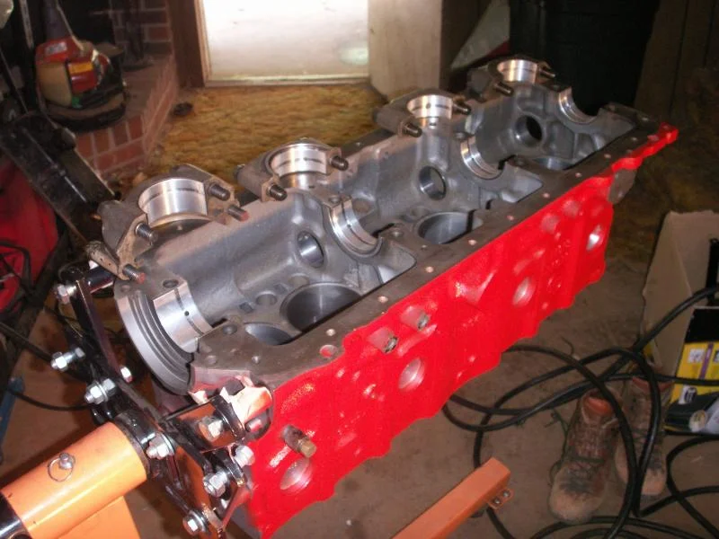

and how to keep your friends away......

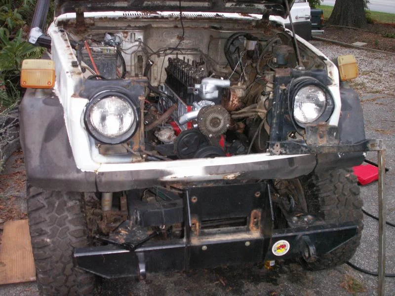

now the real trick is to see if any of the front grill and rad supports will line up
not to mention the getting it running part. Im all ears and up for volunteers on the final stretch. Just got to pick up a few more things. Exhaust manifolds, oil cooler, hoses and finish the plumbing/electrical and set the dizzy to GO!!!!

not fancy at all, just built back to stock with new bearings races and rings.

I like the turn signals that let the people on the obstacle you're trying to get on know which way you're going! Thanks for the mention about the engine in your list!!!

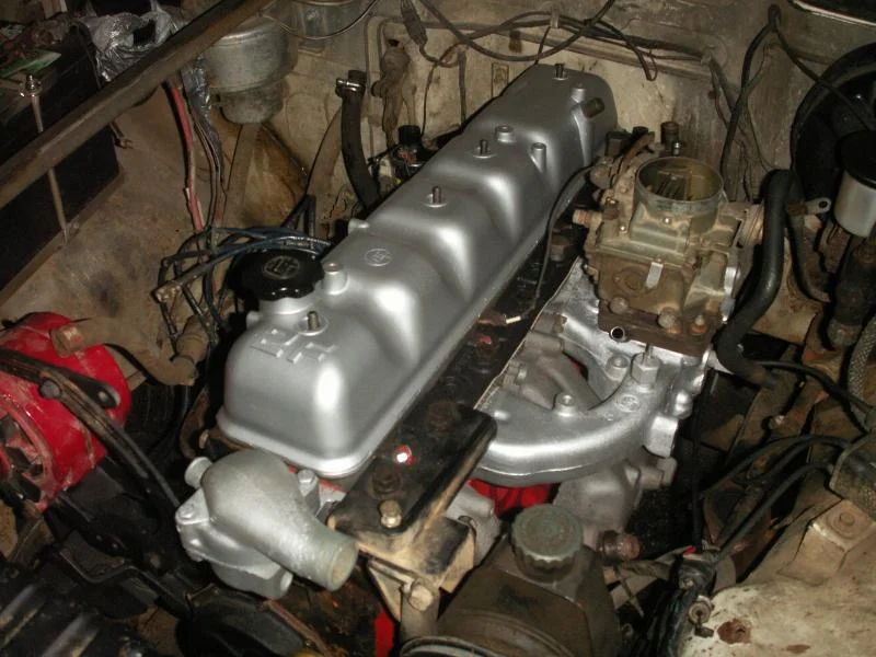

Man that thing is shiny!!
Looks really good. You've made a ton of process in the past week. Impressive.

Doh............... so it turns out this is actually a 77 with a 79 valve cover.

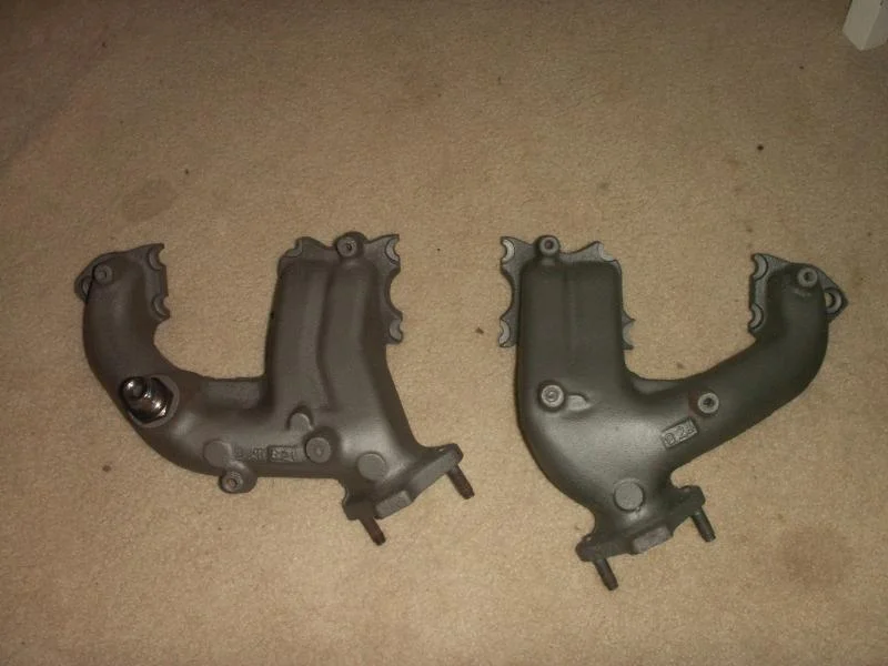

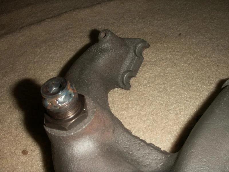

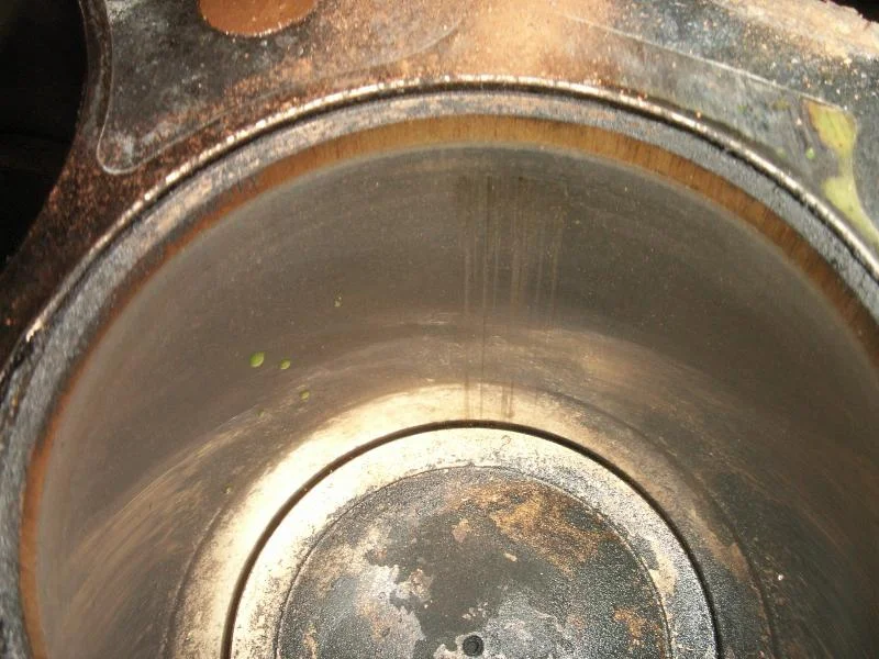

One step closer, i picked these up today. One thing i learned through the whole process is whatever timeline your machinist says...........................triple it.
cleaned, cut, clearanced, and capped
Need the shorty waterpump w/ 2-groove pulley and smaller bolt pattern for fan.........a 75 from what ive read.

I know I know believe me Im tired of it sitting in the middle of the driveway. Pushing it close to having it ready in time to make a URE run.
Manifold studs should be here today and that leaves me looking for the 2 groove pulley with early bolt pattern.

got the pulley thanks to Trollhole!! mounted up the alternator and will have to adjust the powersteering.
Now I just need the plastic non clutch fan and a day with no rain.
