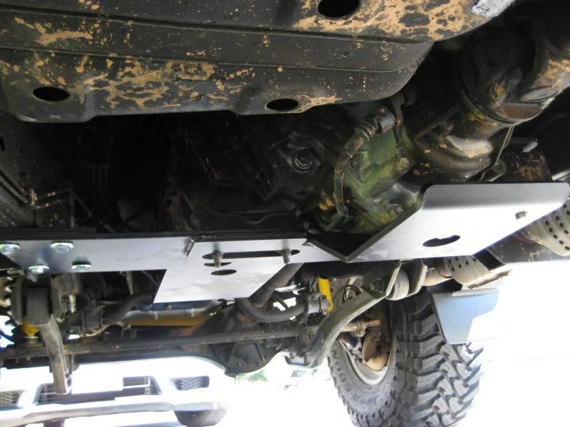

First for the 80 -
I had some bumper 'fitment issues' so I drove up to IPOR to have them sorted out. They fixed things up and threw in a skid plate for my troubles . Here are a few crappy cell phone shots while at their shop.

Back to the 80
Installed an IPOR skid plate yesterday with a little help from my father in-law. This skid is pretty heavy and having two people makes it fairly simple and a lot safer. Took us about an hour and half from start to finish. Still need to trim the transmission support bolts or they'll most likely get mangled.

Looks familiar! It will also take a beating.

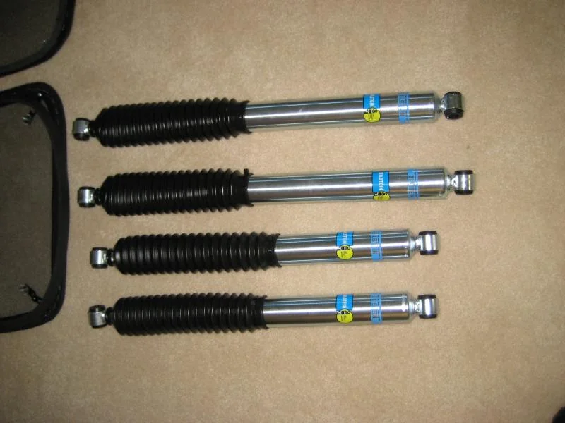

I couldn't resist the Bilstein buy 3 get one free deal they had going on in April. Just got these yesterday (they were backordered).
BIL F4-BE5-6253-H5 for the front and BIL F4-BE5-6248-H5 for the rear. I haven't put them on yet...I'm considering replacing the bushing in the leafs and shackles.
What's the consensus on whether I should replace the bushings? The springs are ~10 years old but only have 40k miles on them.

Are they Poly? I wouldn't see any reason to replace them unless they were deformed or brittle... That stuff is pretty durable...

I'm not sure if they're poly or not. They are red and looked cracked/cracking in a few places. Most likely whatever came with a skyjacker lift and conferr shackles 10 years ago...
Were your's really that hard to remove/replace?

Yeah, once the material dries out, it glues itself to the interior of the perch. But, I also had a decent amount of rust in there too. We had to dremel out the hole a little to get the new ones in...
If they're cracked, then I'd change them, and give em some grease in and out... I wanted to get some of the Aussie bushings with the grease grooves, but the time frame didn't allow... I'll do those on the other one..

This is probably a stupid question but the leaf sprung 40 suspension is new to me compared to the 80...are all the bushings one size fits all or do I need to get skyjacker specific ones??
Which ones did you go with Brian?
