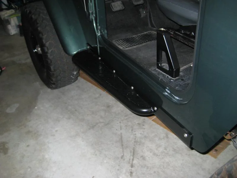

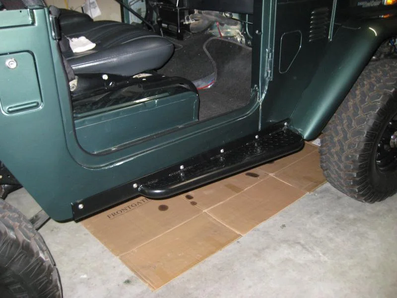

Installed a set of the 4+ step sliders today from Man-a-fre. They arrived fairly undamaged but there were a few scratches/chips on the powder coating. Nothing that some touch up paint won't fix.
They weren't hard to install but it was a bit un-nerving to drill 12 new holes into the aluminum tub. Luckily I didn't **** any of the holes up .
A couple of pics...

Jon, looking good.
So my question is this since i have seen those types of sliders on 55s as well..... are those actually sliders? On the 80 as you know the slider is not bolted to the rocker but to the frame. There is a lot of load put on a slider when the truck comes down on them. These just seem like those 6 little bolts won't do much of anything but allowing the entire slider to push the whole rocker up? Am i wrong? explain how this type of slider works?

To answer your question, these aren't really true sliders like we have on the 80. I think the 55 series ones that IPOR sell are but I don't know many details about them.
These are b/w a regular stock step and a frame weld on slider. They give the rockers a good bit of protection from a minor scrub/hit, but you wouldn't want to put the wieght of the truck on one. I might add a frame tie in to these for some added beef...but I doubt I ever wheel this truck hard enough for it to be an issue. Also the wheel base of the 40 is so short that the likely hood you would use the sliders to pivot on/up/around an obstacle would be a lot less than in the 80.
But you're right they are not 'sliders'...just overdone steps.

cool. just wondering. Not trying to talk them down at all.... plus if i had a 40 that nice it wouldn't see many trails at all. Just a lot of town driving with the top and doors off!

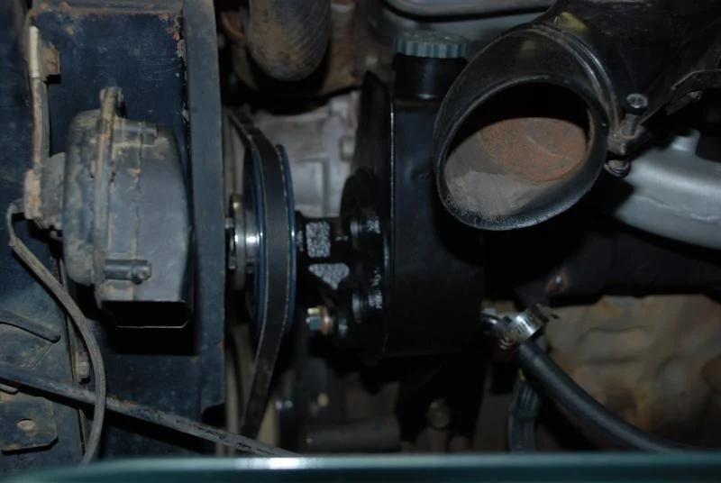

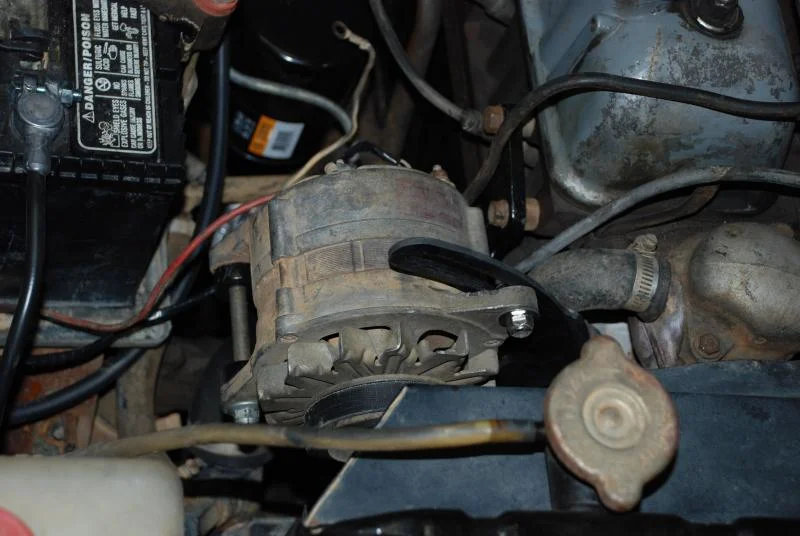

Power Steering Conversion and Alternator Swap

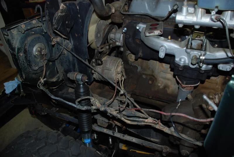

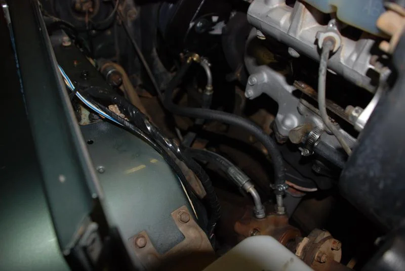

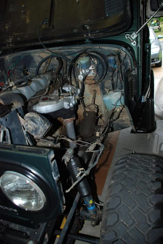

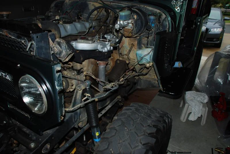

After procurring all the parts that I think I'll need, I started working on a mini truck box and saginaw power steering pump (with Grainger pulley/bushing) conversion on the 40.
Right off the bat I've got a question. I've done some research on the 40 tech section but let's call it limited at best.
I'm moving the alternator from the driver side of the 2F in my truck to the 2F appropriate passenger side. Should I consider upgrading to a higher output alternator or new one while I'm at it?
The current alternator I have has the part number 27020-61012. I have no idea if this is a a 2F, 1F or something else F alternator so any help here would be great.
Here are a few pics of the in progress tear down...

I have read posts that suggest to do more research into upgrading the alternator to a "high output". I think most people just do it on the forums and don't look back, but some of the electrical gurus on here advise against it due to the possibility/probability of the fact that the 30+ year old wiring might/won't be able to handle the higher amperage.
Whether people have had problems or not after switching who knows?

Jon, w/ a PTO winch, I can't imagine what else you are going to be running to justify a HO altenator. If you have some other plans for a boomin' system or something else requiring more current draw, you can upgrade to a AC Delco unit fairly easily. There are lots of posts on the tech section, but if it were me, I'd stick w/ the OE.

I might have some bracketry here for pass. side install if you need.

Anyone have a 2F alt. bracket? i still need to get Ramon his roll bar template back!

Brian I will check in see if I have one, we should just make one for you.

Where in the hell were you when I needed one .
I'm good, thanks...got one from eventhough from upstate.
I'll stick with the alternator I've got.

Made a little progress today/last night.
Got the old box out and pedestal mount off (pain in the @ss). Mounted the new pedestal and box. Also got the saginaw pump/resevoir and alternator mounted.
Next step will be to plumb the hoses and measure for new belts. All in all not a bad conversion so far...
A few more pics of the progress -

Finally finished my mini truck w/saginaw pump power steering install. It took me longer than expected but was fairly straightforward.
So far the addition of power steering is freaking awesome!! Drives like a different car. I still need to recenter the steering wheel but no major leaks so far from the steering box/hoses. I did have a small leak from the pump but think I've fixed that. If not then I'll exchange it for another rebuilt pump under warranty.
I'm going to try and do a write up on the ONSC website with pics and parts numbers of the install. Nothing new that you can't find in the 40 series FAQ's but would be a nice addition to our site.
Here are a few pics of the finished install. Can't wait to test it on the trails!!
