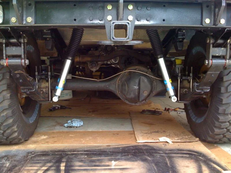

MAF 4+ Flip Kit and Shocks
Rear is done, bushings replaced, greasable spring pins installed...now on to the front.
Darn leaf springs are a little more of a pain in the @ss than coils...

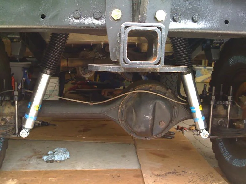

Finished to fronts.
And to those of you who wheel their 40 without a flip kit or ubolt skids...please think of the next owner and upgrade now before you bend the crap out of the bolt ends and someone has to cut off the ubolts .
I assume I should trim the tops of the ubolts? Brian, how close to the nut did you trim?

Wow, you've got a lot of extra on the driver side. Mine don't look like that, but I did but correction shims in. Incorrectly, but they're there! A minor to do later, no DW, so it's not a HAVE to do... I will tell you this, if those are the same as the MAF, you'll want to put a coat of paint on them, mine have a nice coat of surface rust on them already...

Yeah my springs have less packs in them than others so there is a good bit of extra thread on the tops (one has been removed too).
So your ubolts are rusting or the plates? Yes these are the MAF 4+ kits.

The bolts...

Guys, when tightening u-bolts, make sure the axle is suspended (ie no weigh on the wheels) when you tighten. Makes a difference, seriously. Jon, cut those bolts about 1/4" or so above the nut and call it done. Cutoff wheel is a lot cleaner than a saw if you can get in there alright. Truck looks nice. Anxious to see your response after you get that carb on.

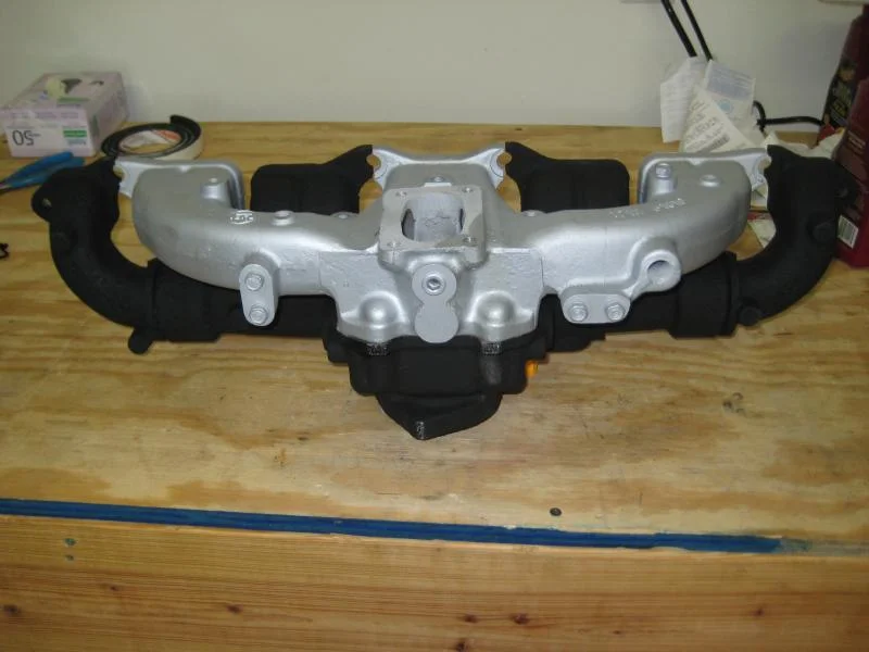

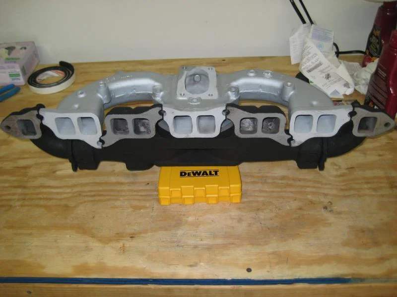

Made some more progess this week.
I picked up a 2f intake and exhaust manifold from Juan and Maria (thanks Maria!!!) on Sunday. Had it bead blasted Monday and painted it yesterday.

Running Again
Today was a productive day. Picked up the manifolds from the machine shop. Bolted them to the head. Bolted the carb and other bits back together. Only trouble here was the throttle linkage didn't line up the same as with the F intake manifold that was on the truck before. It works fine now but I'll need to keep an eye on it to ensure it doesn't bind up.
Called AAA around noonish and they sent a roll-back to take me to the exhaust store. Had Alamance Mufflers bend an exhaust with a 40 series flowmaster muffler. Sounds great and looks good too. They did a great job routing the exhaust and were really reasonable on price.
Glad to drive the 40 again!!
Here are a few pics
