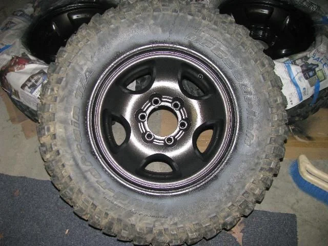

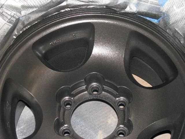

I cleaned, then scuffed the rim pretty good, then i applied a couple coats of etching primer, lightly sanding between coats (pitted some from lack or care of PO). then i used a primer sealer, followed by a couple coats of krylon black hammered paint. then 2 coats of clear. I have 3 of them done. i will wait til it get a little warmer to do the other two rims.

Nice job. I have to admit that I didn't work nearly as hard as you did. I scuffed mine with a "greenie" pad, wiped with some acetone and painted with the Duplicolor Black Wheel paint.
Here are a couple pics of mine...
