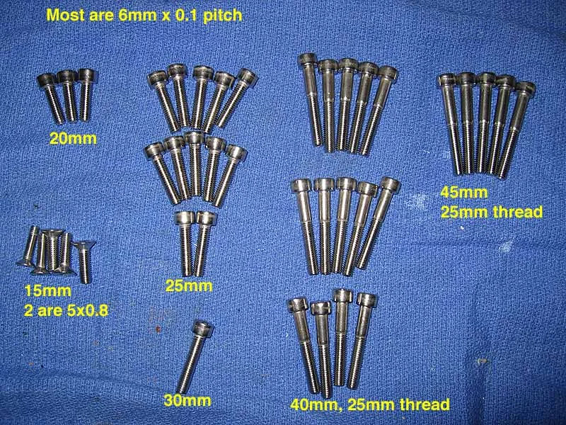

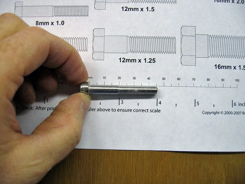

I recently bought a stainless steel bolt replacement kit for my CT90.
Source: Burks Motorsports, Motorcycle Parts
Here is what is in the kit.
Most of the bolts are 6mm x 0.1 pitch. All are Allen head.
  • 5 45mm bolts, 25mm is threaded
  • 14 40mm, 25mm is threaded
  • 1 30mm
  • 12 25mm
  • 3 20mm
  • 3 15mm tapered head
  • 2 15mm tapered head 5mm x 0.8 pitch
How I measured:

The entire kit:

awesome bolt list. the diameters and pitches match my measurements of individual bolts.
thanks yoop

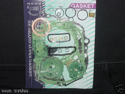

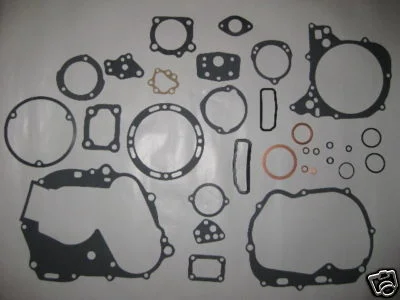

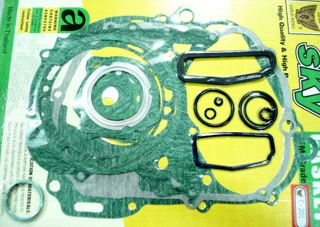

ok, here is some info on the different complete engine gasket sets available for the ct90.
there appear to be two basic sets. one is made in thailand and sells for as little as $6.00. it usually has green gasket paper but has several packages. the other is made in taiwan supposedly of "japanese" material and is sold by dr atv and others for about $20. it usually has at least some black gaskets. the easiest way to tell the sets apart though is that the thai sets are missing four small copper washer/seal things and you can usually see this in the packaging if you look hard.
the short answer is that the thai set is missing 5 gaskets including the oil pump gasket, plus those 4 little copper things.
here are photos of the two sets in the packages. thailand first. taiwan/japan second.

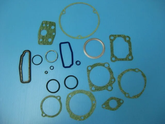

here is the taiwanese/japanese set broken out. notice it has the 4 small copper washers and also the oil pump gasket pictured separately.

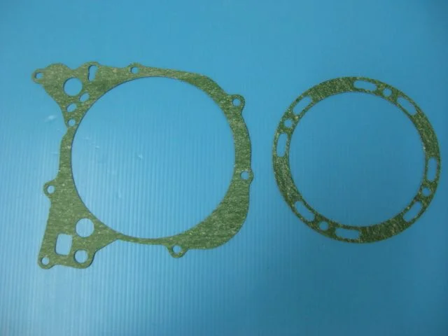

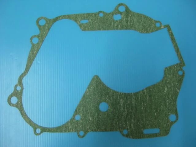

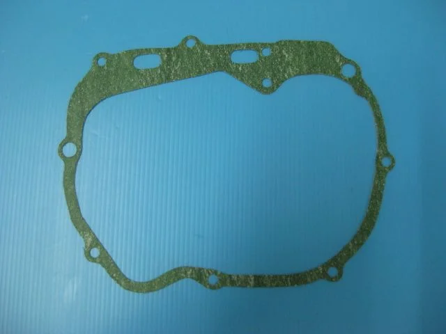

now here are 3 of 4 photos of the less expensive thai set. notice it is missing several gaskets including the oil pump gasket.

here is the last photo of the thai set. i don't know what the other missing gaskets and seals do yet because i am about to order them but it seems prudent to get the more expensive set.

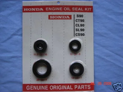

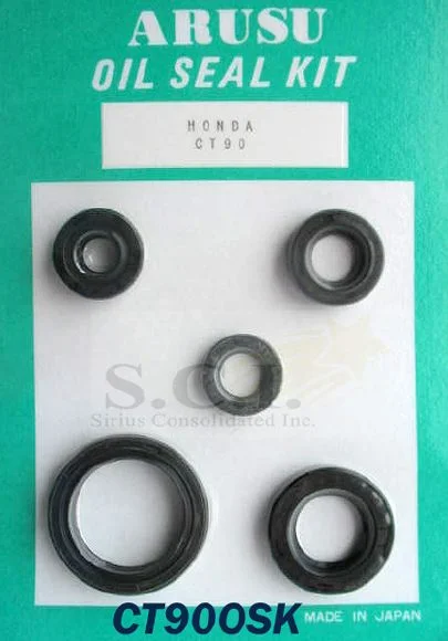

and now for the oil seals. there are two kits again. one has 4 seals, and one has 5 the 4 seal set is as little half the price of the 5 seal set and you can see here that it is the biggest seal that is missing.
the kit of 5 has the following
13225 POINTS ASSEMBLY SPINDLE
11.62410 SHIFTER FORK
31438 SPROCKET DRIVESHAFT
14267 RIGHT CRANKCASE
20347 MAIN COUNTERSHAFT
those numbers are actually the seal dimensions not a part number. looking closely at the set of 4 you can see the same numbers are printed on the package. the missing seal is the "sprocket driveshaft"

and the missing seal is honda part 91202-459-771 and goes on the subtransmission sprocket output
http://www.cmsnl.com/products/oil-se...8_91202459771/
