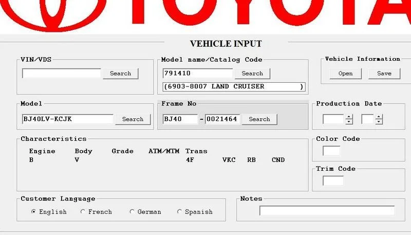

not sure how many of you guys have actually subscribed to this thread .but i just learned from lostmarbles .
that he had his V.I.N. work on the 79 BJ40 .the V,I,N, feature doesn't seem to work on any thing older than 79 . here is a pic of how i entered my info for 78 BJ40 , it pulled up most of the detail of my rig .also Tom (lostmarbles) said he had to add an extra 0 to his frame # to get it to work (see pic )
the epc still doesn't like my V.I.N. but it did tell me the info of my rig ,it's nice to have this feature to work .it narrows down your parts search.only showing you the part #'s that pertain to your year vehicle. less searching .

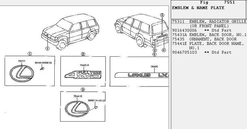

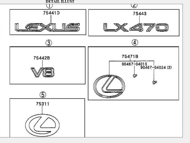

here are a couple of pics showing a lexus catalog, LX470(bottom),LX450(top) , emblems .

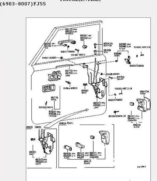

so will it work on early fj55s

sure here is a pic of the door (how early).it list's part #'s for the years 69/03-80/07
the epc still works you just have to search by model. skipping the part about entering the V.I.N.
