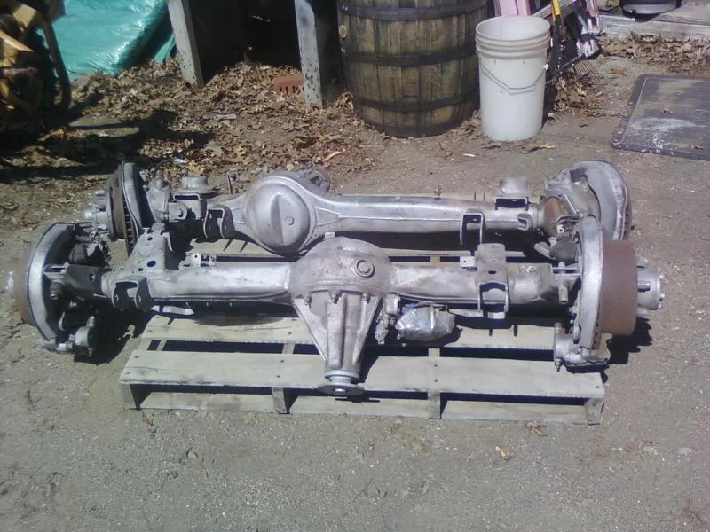

first step on the build was to get the axles sand blasted and ready for some paint...

No offense, but shouldn't you take all that stuff apart before sandblasting it? Seems like now it's gonna have sand crammed in all the "nooks and crannies".

i was thinking the same thing i plan to do an axle rebuild on the front just wanted to keep the contamination to a minimum so i just left everything on. The rear is sealed up tite so no worries there, also plan on rebuilding the front and rear breaks

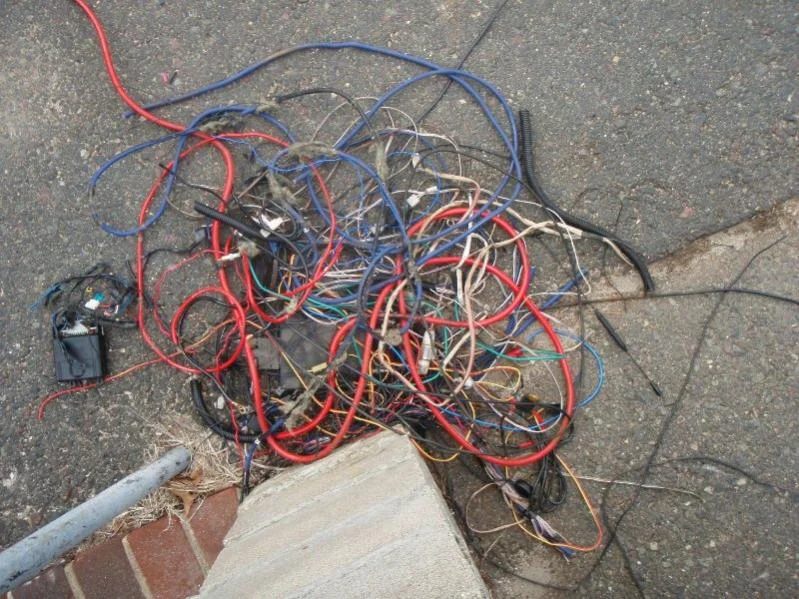

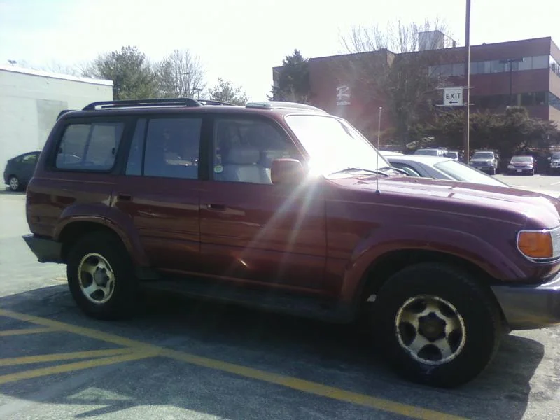

spent some time today trying to find out while the truck is int getting fuel after checking the fusees fusible links alternator i decided to get rid of the alarm and the rest of the not need wiring, all i have to say is WTF pic explains it all

is that the alarm wiring? I really want to pull my alarm out but it is so matrixed in there I don't know where to start.

alarm, sound system, phone system bla bla bla swing by Boston some time i will help you rip that crap out not all that hard

ended up jumping the fuel pump + and got the truck started drove it around the block drove well sounded great only thing left to mess with is the EFI relay most likely my problem

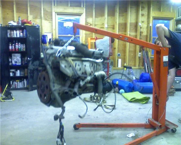

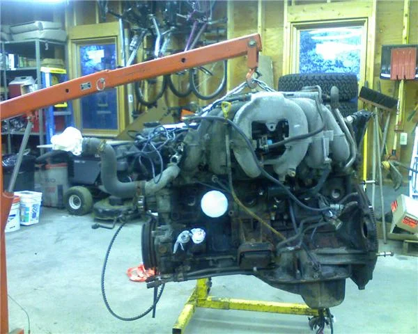

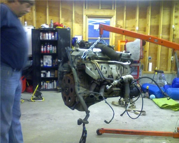

pulled the engine out of the 93 today and brought it over to Ricks so we can start rebuilding it, turn it into a ob2 and slam er in to the 96. ohh let the fun beguine

I think Jen's choice to go with a pink block is superb!

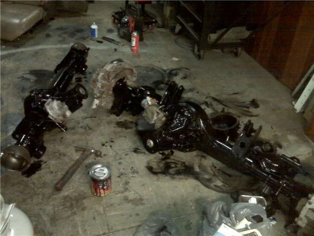

Wife and I finished painting the axles tonight with POR-15 i will top coat tomorrow with black spray paint for UV protection
oh and yah i could care less about the basement floor, i need to rip that tile up and epoxy it
