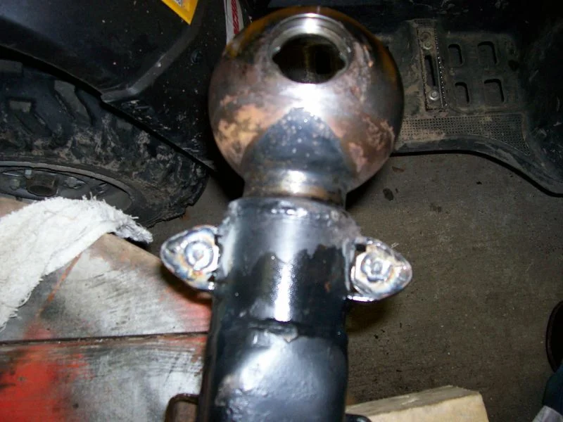

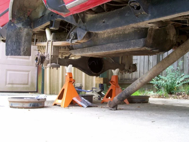

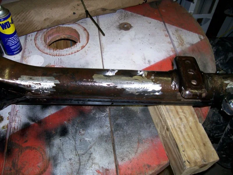

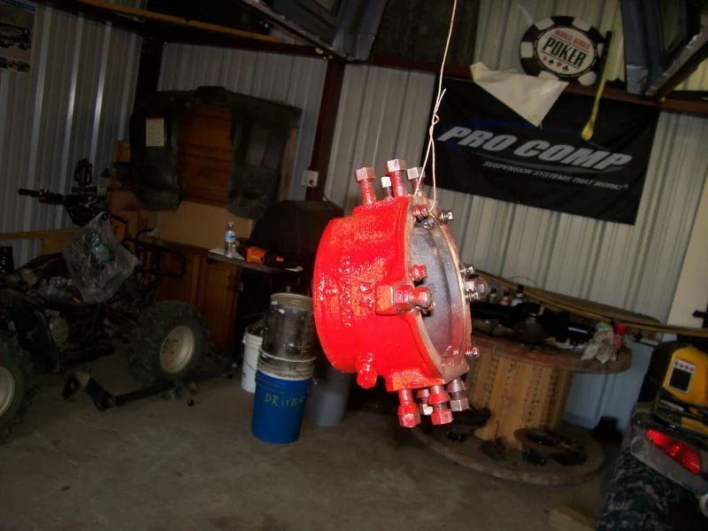

Finally had time to start cleaning some parts, and apply some paint to the area that don't get something welded on or cut off.
Name:  Toyota SAS 001.jpg
Going to have a black axle and red knuckles (to match the truck body).

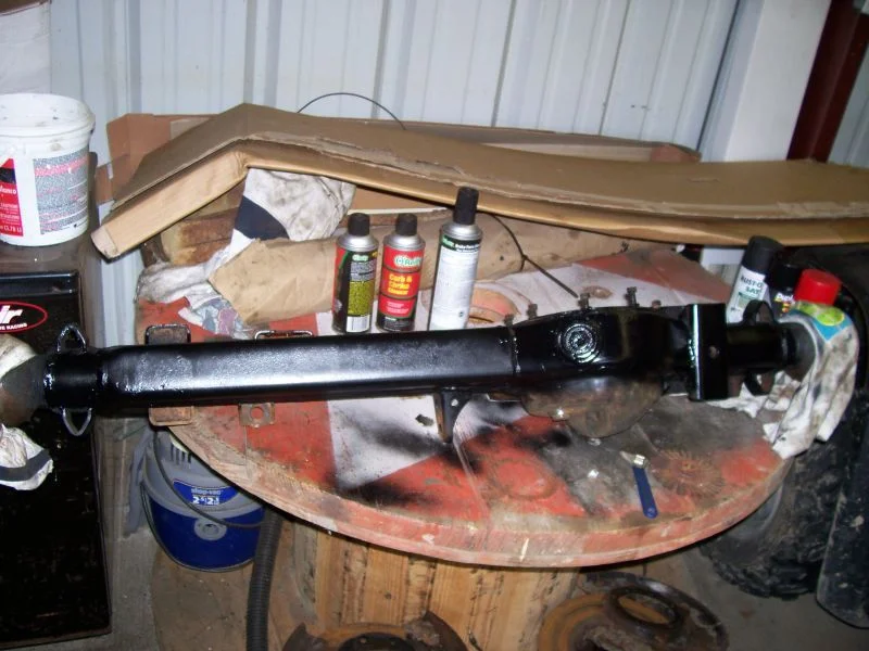

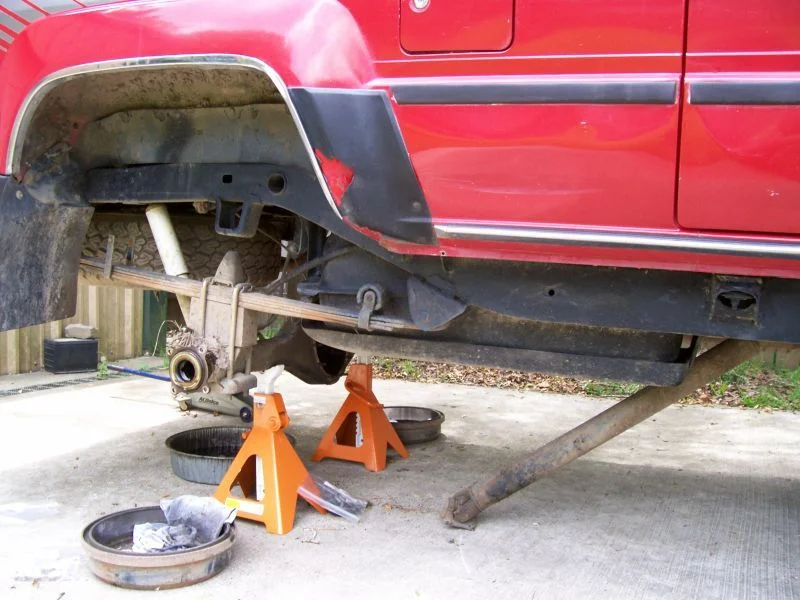

Cut off the unnecessary brackets and tabs today, also got to weld in some nuts for the steering stops. That will be all for a couple of weeks until I return from work. Hopefully there will be a big pile of new parts in my shed when I return.
Name:  Toyota SAS 003.jpg
Name:  Toyota SAS 004.jpg

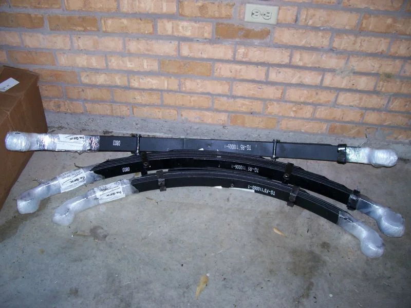

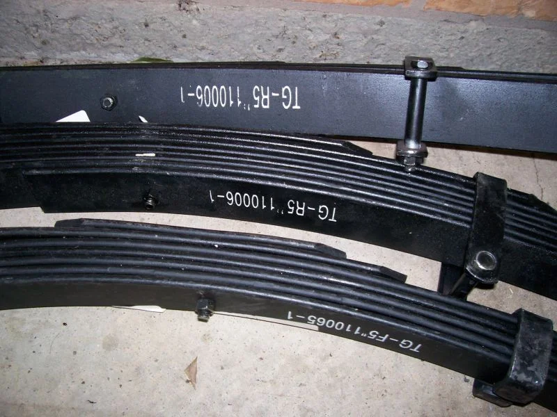

The parts are arriving hope they all there. We will start on the gears and lockers the first week I am home and then the fab work.
Name:  Toyota Springs 2.jpg
Name:  Toyota Springs.jpg

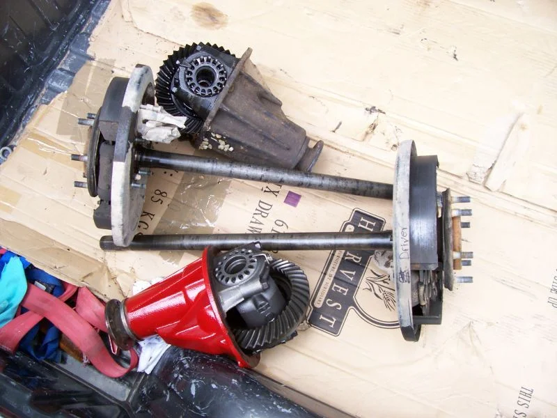

Finally made it home from work and started looking through the parts received. Soon after my friend shows up and next thing I know the rear axle is disassembled. We loaded up the third members and rear shafts to start the gear swap along with installing lockers at the shop in Franklin.

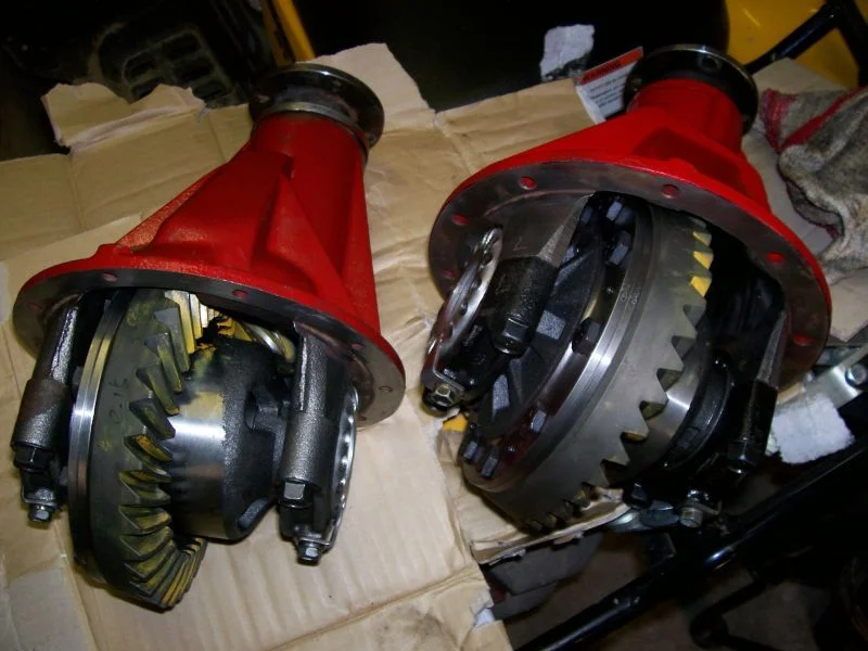

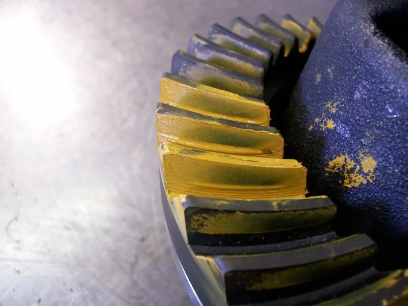

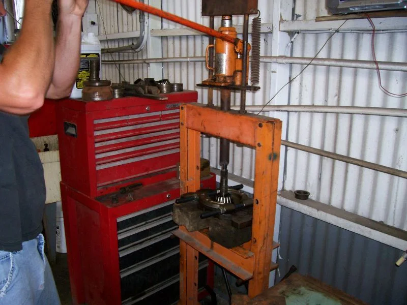

Finished up the gears and Detroit Lockers just have to reassemble the rear axle. Plan on reassembling the front after all the welding. It took use three wrenches and a home made jig to get the rear crush sleeve set. Four attempts and all our shims to get the front gear mesh set but it is all set right thanks to some friendly guidance.
Name:  Toyota SAS 008.jpg
Name:  Toyota SAS 018.jpg
Name:  Toyota SAS 026.jpg

Decided not to get the TSL SX's because I found some 35x14.50x18 Irocs on some polished wheels for about the same price. Picked them up today and pretty happy with them they have some stress marks but nothing to bad. I hope the wider tire helps with my high center of gravity now.
Name:  Toyota SAS 020.jpg
Name:  Toyota SAS 021.jpg

New parts are always nice. Yep setting up gears is fun. Are you going to do anything special to break in the new gears ?

Nothing special just heat them up, cool them down several times , and put about 500 miles on them before I strain them to bad. I was going to try riding around with my front hubs locked to warm up the front. That way I do not have to ride around in 4wheel drive all the time. Is there some special way to break them in? I would be truly grateful for all the advise I can get.
