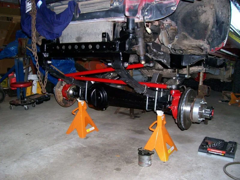

We have worked kind of late so here is just a preview of how far we have gotten.

I've been waiting for those? Looks like thats pretty much a wrap. Great job it looks ready to take on the trails. That floor sparkles clean you sure you were working over there?

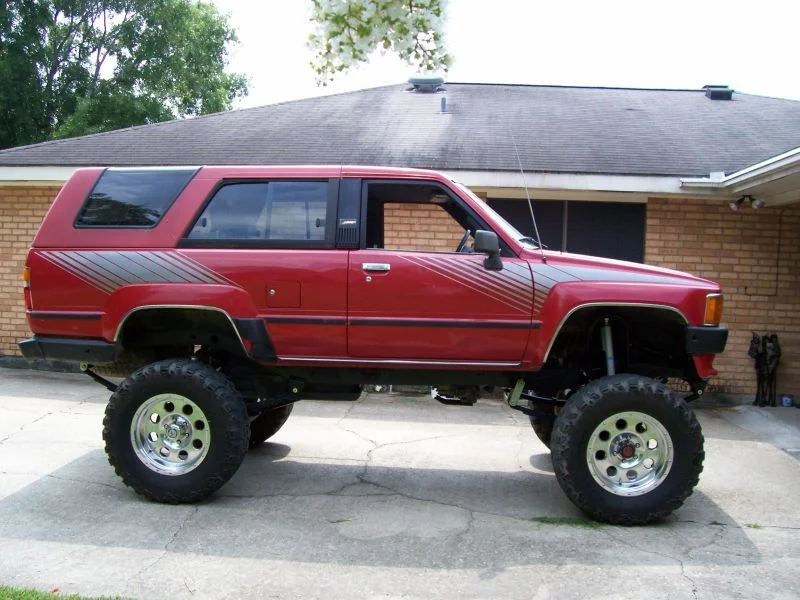

Sure is, I fell like I was on Overhaulin or Pimp My Ride and Albert was Chip Foose. I have to install the drive shafts, finish up the hubs, trim down the U-bolts, and put some 6'' shackle plates in the rear. I hope I have time to finish when I get in, before the weekend of the 4th. I will try to add pictures and storyline when I get some time home.

Dang... Just how much lift did it end up being. those 35's look like my 32"s on my truck. oh wait, you have about a 3 inch body lift too it looks like.

He could easily clear 38's but some 37's would probably be ideal. I didn't think that was 35's either when I first looked because it towers over them.

All that time and I don't know if they are 35" or 36" but they look big compared to my 35" MTR's. Nice IROKS.

one other question.. What size rimes are those? 18's?

yes, tires are 35x14.50x18 used Irocks, wheels are 18x10 polished.

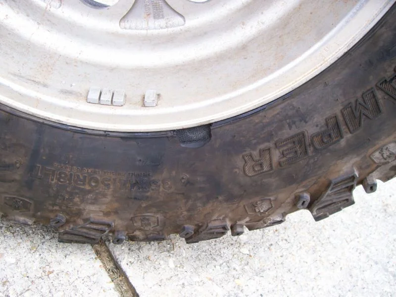

Has luck would have it found some nails in my used tire. Went to Pepboys to have it patched and they tore a chunk of rubber off near the bead near during dismount. They are saying they should have never tried working on a tire that big and that the tires are dry rot.
Thanks not so much Pepboys.

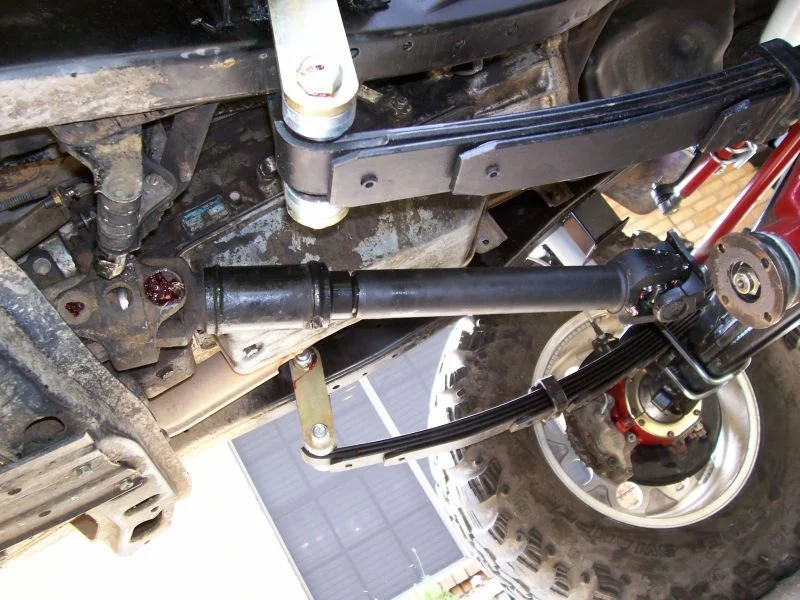

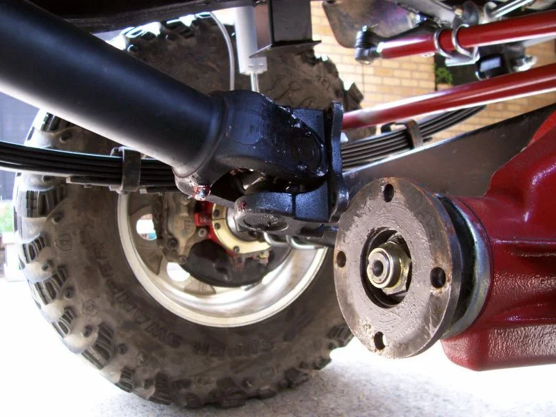

Also ran into a problem with the front drive shaft, it is to long after I brought the whole truck so that they could measure themselves. The angle is not right it seems I have the wrong u-joint, any suggestions.
Will try to take it back to the drive shaft shop tomorrow, but it doesn't look good for the weekend. But got everything else together just hope that tire holds up.

Looks great John, sorry to hear of your woes. No ideas on the driveshaft but with a well outfitted shop they should be able to fix the length with no problems. Drive it over there and let them get it right you went out of your way no they can fix it. You should be ok on the tire I've had tire shops damage the bead on several swampers and others because of the new style machine they're using it not really big enough to mount large tires and it pinches the bead. The beads on the swampers are very thick. I've tried a few places and they've turned me away for just a 33' tire.

Put a single u-joint at the T-case to eliminate the CV joint .This still means to cut and re weld, look at how much angle you are getting from the single u-joint for the front third member.
I have some spare drive shafts, let me look at them and see if I can find one that will bolt up to your T-case and you can cut the tube off it and swap it in place of the CV on the one you have now. Don't give up hope on the truck we all get little thing that does not work out like planed.

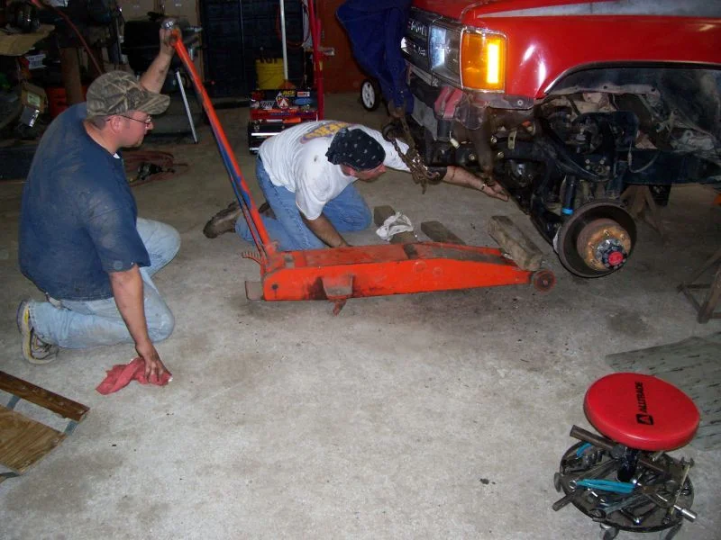

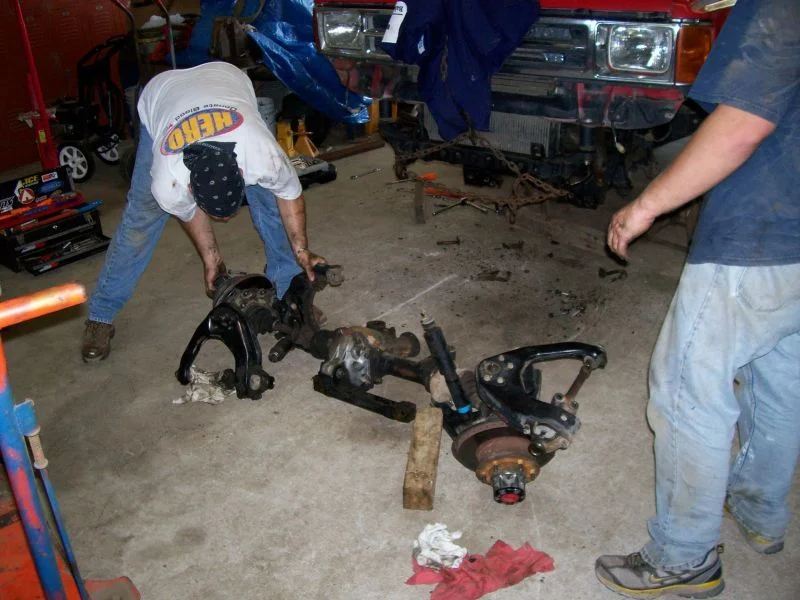

Thought I would do a story line and pics for those of you just wandering about the process. I used the trail gear 5'' IFS eliminator kit and 5'' rear classic lift kit. Loaded all the parts and some tools onto the cargo area of the 4runner and off to the shop we went.
Name:  Toyota SAS 037.jpg
We got a game plan together and with my experienced leader the removal of the IFS was done on the first day.
Name:  Toyota SAS 041.jpg
Name:  Toyota SAS 046.jpg
John Stw is offline   Reply With Quote
