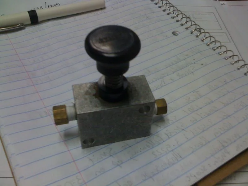

What I like and will do to my 40 is a line lock. I helped Larry install it on his 40 before we went to SCC two years ago. It's easy and not to pricey. And it works great. All you do is tap into your brake line and install a small shutoff valve. When you press the brake you close the valve and your brakes stay locked in. to release just open the valve. easy cheesy

That's a great idea. Why didn't I think of that?

I believe you can find them in the electric form also. I was told drag cars have them. So if you look on summit I bet you could find them. If you had electric ones you could install them on each wheel. This would alow you to lock the wheel so you could turn the truck around a rock or tree.

All you would need are some electric actuators that could handle the break fluid. I wonder how that would work with lockers. I guess you would have to have a selectable locker to run it like a dozer.
Another though, if you could control each wheel individually, it might actually eliminate some of the need for a locker. When a wheel breaks traction, you could lock that one up and an open diff would be forced to transfer torque to the tire with traction!

you get them and lets see. All i need is one i'm locked.

X2 on what Corey said they work great but I'll go with the electric next time. On a trail maintenance day I rode with a gentleman from Alexandria with the electric 1 in front and 1 in the rear and they worked great. I went with the Jamar unit and though it worked great on the trail I wasn't crazy about bringing the lines in the cab. When I got in my accident and locked up the brakes it locked up the line lock valve but I planned it right when I did my plumbing in the case it failed it could be easily removed. Its funny you mentioned it I brought it to work and have it right here on my desk. I'm about to ship it back to Jamar to fix it.
Poly Performance Inc.*::*Braking*::*Jamar Brake Parts*::*Jamar Line Lock - JK Synergy Suspension Systems, Fox Racing Shox, Beard, CTM, Johnny Joints®, Currie Enterprises, Edelbrock, Total Chaos, Ramsey Winch, Walker Evans, Wilwood, Mastercraft, CNC B

Looks like it could be made easily with hardware store parts.

On a manual trans rig with a carb where you may kill the engine on a vertical climb with an obsticle to get over its a big help to use the line lock to hold you in place start it up let out on the clutch and bump the brake to release the lock and away you go. Those with a good ebrake you don't need it but the ebrake on my 40 won't hold me on a vertical slope where this does.
