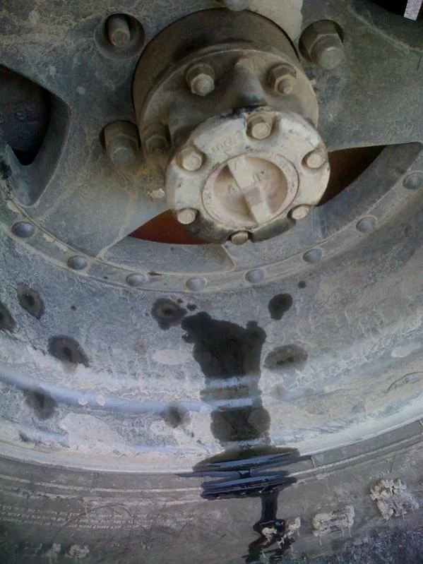

Ok I am getting what smells like gear oil out out the end of my hub... is it just an o ring in the hub or what?
and looking at the picture I also see I am missing a lugnut...

Looks like you need to get some Marlin HD inner axle seals.
Do you have oil leaking around the knuckle any where?
We might be ordering some seals for my friend's truck if you want to combine shipping it should help.

Hopefully it's just around the outer portion because those cone washers and the snap ring can be a pain!

Now for some information that helps.....
You can drain the oil and put fresh oil in when you finish...OR...you can jack up that hub above the level of your oil fill plug to get all of the oil to stay below the hub you are working on.
1. Make sure the hub is in the "FREE" position 2. Remove bolts 3. Carefully remove the outer part of the hub (there is a spring and a gear attached to it) 4. Apply gasket and reinstall in reverse order.
Be sure to keep the hub in the "FREE" position or the gear will leave its holder and can sometimes be difficult to reinstall. On a scale of 1-10 I would say its a 2 and should take about 5 minutes.

That will help keep the fluid from leaking from the hub, but the gear oil should not get pass the axle seals to end up in the hub assembly to begin with. The knuckles and hubs should have grease in them not gear oil the gaskets are designed to keep water and undesirables out to prevent corrosion to these internal parts.

Quote:
your inner axle seal is NFG.
as for the nut go lookin da mirror
