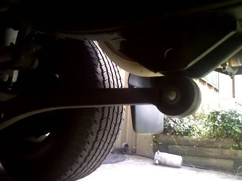

Well, it started raining again, but I did get a few pics...I definitely need to decide on tires. Up for suggestions. I am looking at 295/75/16 and 305/70/16 for all around performance and travel. BTW, the Stock catalytic converters (there were two) were replaced by a Stainless Magnaflow along with Flowmaster muffler just prior to the lift. The magnaflow clears the frame and will allow for sliders to fit nicely. The factory cats were hanging low and I thought they'd hit easily on the trail. I went out for a drive in the rain and filled her up. Here are a few pics on stock tires and OME 850/863 J-springs no spacers. Kept raining, all pics came out dark...finally got MANUAL mode and forced flash to get a descent pic: Before lift, after lift, and the Magnaflow Cat:

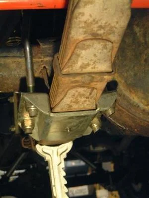

I think we'd all benefit even better from a U-bolt flip kit. I'm sure you all know how much those cost. I've given it a lot of consideration, and I think that the old Pirate4x4 DIY solution is the best. I mean, for under $15 a piece plus some plate and bolts, you can have your only using very nice GM parts. I WON'T buy those U-bolt Flip Kits from you know who, only because I think they are outrageously priced. Anyway, if you all are interested in fabricating something, I say we at least look into using the GM axle stuff. It's very nice and proven. Here's a pic or two of the GM parts. BTW, they are $14.14 a piece from GMpartsdepot.com at this very moment....also, the last pic is the "Old School" way of doing it...this link to Pirate is pretty Old: http://www.pirate4x4.com/forum/showt...ght=ubolt+flip

I agree thats a good way to go but because I already have new u-bolts on the three rigs I want to put them on I'm going to go the skid plate route myself.

Castor Correction on FJ80
Hmmmm...you bring up a good point...
Side note: Drove the lifted 80 for a few days without correcting castor. The feel of the firmer new springs and shocks, and I never really noticed anthing wrong with the steering. Knowing that Christo Slee knows what he's talking about, I left work at noon Wednesday and went to my buddy Paul's to install Castor Correction Bushings...boy to they leave out MAJOR info on that install!!! And like Slee says, alot (most?) of people DON'T do it. He says that they usually are amazed at the way the rig drives once Slee installs the bushings for them...well, personally, I had my doubts about how much or what it would actually do. It took quite a while to do and luckily Paul has a 50-ton press. It took several tons of force to "pop" the old bushings out. We made a template for the orientation and bolts which basically simulated the mounting location on the truck itself by welding two bolts to the iron in the factory locations before removing the old bushings. Slee's similar setup:
Here you can see their jig with the two bolts, the bushings and the MARKS...the key is to get MAXIMUM drop. If you don't use such a rig, you will put them in slightly crooked or rotated, and NOT get max. drop AND put undue stress on them....thus the reason for the jig...anyway, I'm glad I drove it BEFORE and AFTER, to "See" and "feel" the difference the castor correction makes....it's HUGE. Like I said, it drove great (or so I THOUGHT) before...BUT---As soon as I drove off from Paul's house, and made my first turns, I noticed that the wheel turned more easily and returned to center on its own....I hadn't really noticed that it wasn't doing that before---mostly because I was so pleased with the quality and feel of the firmer OME ride. Anyway, thought I'd share....I'll add a pic later of the passenger side STOCK configuration AFTER the driver's side was corrected. The difference/angle is huge and alot more than I expected. I'm very happy with this OME J lift, and Highly recommend it.
Here's a picture of the passenger's side control arm's position AFTER the driver's side Castor Correction Bushings were installed.
