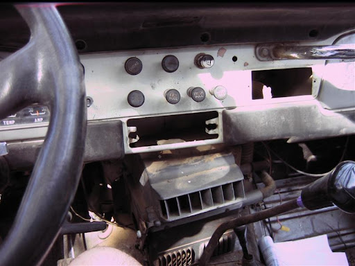

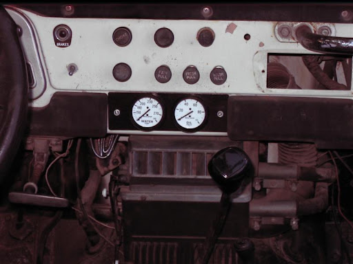

Gauge mount location suggestions for my 75 FJ40?
My oil gauge is working but my temperature gauge isn't. I messed with it a bit but decided new gauges would be more accurate so I got a pair of 2 1/16" gauges for water temp & oil pressure.
I am looking for ideas on where to mount them. My '70 FJ40 was easy cause I didn't have a heater unit. On my '75 I have winch panel above the clutch/ brake pedal area (left side) and the heater unit on the right side. The ash tray is 2" and radio slot is over 2". I will need to make a plate to mount in either place. I'd like to take the old crappy radio out, so that might be an option. Proffitt's cruisers makes a nice ash tray plate for switches and I think that spot might work too- I don't want to cut the dash up.
These are the gauges: Auto gage 2326 - Auto gage Analog Gauge Consoles - summitracing.com
I'll try to take some pictures tonight of the dash area
Any suggestions, I'd like to hear them.

Jason, my temp gauge went out on my 40 and I took the cluster apart and the big round connection port just needed some cleaning and better seating. I have also heard that the factory pins that go into the port are prone to never being fully pressed and crimped in at the factory.
Do you have room under the dash on the right side of the wheel. The area where the factory AC controls are? Mike mounted a diagnostics port there on his old 40 and I think Larry or someone else put some rocker switches there as well.

I will take a look at the cluster again & make sure the connections are good. I don't have a/c but will snap some pictures tonight, maybe that will get some ideas

Yep I like the stock gauges but want to add another set for caution will try to fit them in the radio postion I have a plate started with rocker switch for the winch and would like to add another for the factory carb fan and if I can an oil and temp gauge would be nice too

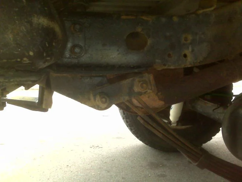

How to Fix a Rear Shackle Inversion? Help...
I was wondering, based on the attached picture, if
1.) the rear shackles are inverted
2.) is there an easy way to fix
3.) would somone do this on purpose?
4.) if i were to fix (by jacking and hoping it corrects itself, prying it back), would it cause damage to the axle, drivetrain, etc
5.) would this correct a really rough ride?
Thanks Y'all

That doesn't look good. Can you give some details on how you think this happened?
Have you tried to jack it up yet? That would be my first suggestion if you haven't. I would definitely say that will effect the ride comfort of your rig too.
Prying it down won't hurt the axle or anything else. Just make sure you have the wheels chocked and the truck on safe and stable jack stands.

1.) the rear shackles are inverted. Yes, not good
2.) is there an easy way to fix. For the time being jack the truck up and pry them right. Did this happen by putting the suspenion in a bind? What caused it? If it happens again your solution is cutting the perch then moving it to correct the angle and welding it in place. The springs, just the tiny bit I see look very worn I'd suggest new springs if you have alot of sagging in them and then you can leave the hangers in the stock position. If you were thinking of a lift now is a good time if you're not in to that look up your local spring shop and have them repair or duplicate the stockers and order some new poly bushing while you're at it and you'll be set for awhile.
3.) would somone do this on purpose? Not if you had any sense.
4.) if i were to fix (by jacking and hoping it corrects itself, prying it back), would it cause damage to the axle, drivetrain, etc. No covered that above.
5.) would this correct a really rough ride? Yes with the shackle inverted its bottomed out against the frame not allowing the shackle to travel creating a jarring or bouncy ride
Thanks Y'all, you're welcome let us know how it goes.

What I ended up doing.....
Quote:
I decided on using the radio hole. I think it turned out pretty nice. There was no cutting or grinding on the dash- all I did was gently bend the radio knob tabs back, which could be bent back into shape if ever needed. I want to change the screws to something a little more trick, like security torx bolts. I made a template & may make more to put sell on mud eventually.
All buttoned up- gauges in & heater bolted back in
You can see how long the temperature gauge sensor is. On the left is the fitting that Paul fixed the threads on, which is threaded into the stock sensor fitting, which is threaded into the head. I have another stock temp sensor in the head, which I may get working eventually but for now I am going to wrap some insulation around this new one and call it good...
I'm still not driving the cruiser around regularly. I'm still going over it, making sure stuff is up to snuff. It's stuttering under load, body is bouncing on the frame (body mounts are shot in the back), etc.
Slowly getting there

Looks good bud, what kind of gauges did you use?
__________________
Larry Landry
Bayou State Land Cruiser Assoc
Visit us at BSLCA.com ; Facebook
67 lacking some metal work and paint
74 trail beast to be
78 FJ40 trail rig
95 FJ80 DD/family wheeler
02 Sequioa family hauler
Volunteer is offline   Reply With Quote
Old 05-02-08, 10:22 AM   #444 (permalink)
250+ Club
BLKDOG40's Avatar
Join Date: Jan 2003
Location: Baton Rouge, LA
TLCA# 12850
Posts: 573
Quote:
Thanks! Autogage, maybe someday I'll step up to something nicer but it'll work for now.
