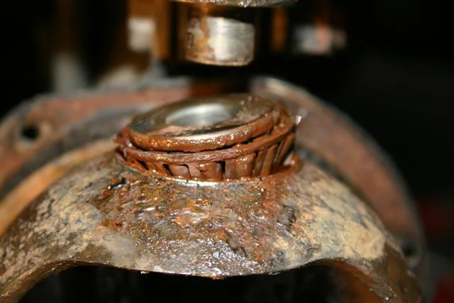

Posts: 25
Downs:
1. slight movement in the wheels when shaken
2. front left fender has 'crakled paint lines' and other 3 are perfect
fender is probley just the clear in the paint job = not mixed/sprayed properly= not a big deal just get it redone if your worried
movement 'MAY" be a problem , I would check the knuckle bearings as well as the spindle bearings ...my hilux was the same , spindles were fine but knuckles (both sides ) were toast ......no maintainance
lizardsinep is offline   Reply With Quote
