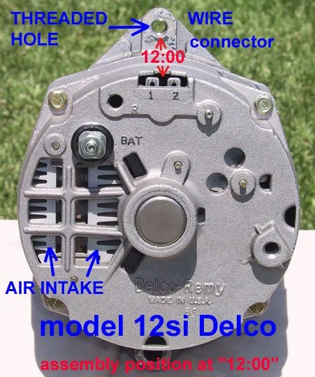

That looks like a standard 10/12SI GM alternator, very inexpensive if it is bad. Do you have a test light or voltmeter? First off, back-alley test: Start the truck, and with it running disconnect the negative battery cable. If the truck still runs, alternator is OK. If it dies: Reconnect neg. cable. Check to see if you have approx. 12 volts (or a brite test light bulb) at the large "BAT lug" on the back of alternator. If not, you have a wire that has lost its connection. If that's OK, then check the terminals on that 2-wire plug on the side of the alternator. One of them (number "2") should also have approx. 12 volts (or a brite test light bulb). If not, you have a wire that has lost its connection. See if this helps.
Adding a disclaimer. Ive read discussions about this method and there are mixed reviews on how safe it is for the vehicles electrical system. IIRC it may be ok on old vehicles, but doing it to a newer vehicle can cause damage (to the alternator if I remember correctly) I read it a while ago so I could be mistaken. I believe the thread was on Pirate4x4.
BTW "easy" way I check an alternator is to turn the vehicle to "on" and note the voltage guage (if the 40 doesnt have one you can use a volt meter on the batt.) Then start the vehicle and if the voltage goes up slightly the alt may be good. If it stays the same it may be bad. Also check all the connections.
It is very bad for the alternator and any computer controlled parts to pull a battery wire off of a running car. A FJ40 doesn't have too many parts that would be hurt by a voltage spike, but it's not a good thing to do to the alternator.
The battery should have 12-12.6V at rest and 13.5-14.7V while running.
Gumby is offline   Reply With Quote

Yeah, these guys are right, I probably should have put a disclaimer in there besides just calling it a "back-alley" method. I wouldn't recommend doing it on a newer computer controlled vehicle, though I'm not afraid to do it on old stuff, including my FJ40.
But is definitely "back alley", not the correct way to do it.
However, if you are leery of "testing" it that way, you can still do the other tests for voltage that I detailed, and if either one of those comes up bad that will be at least part of your charging issue - if not the whole problem. And they are tests easily done without removing the alternator.

Take your volt meter, ground the negative lead, put the positive lead on each side of each fuse in the holder under the dash. If the fuse has power to one side and only one side of the fuse it's bad.
No power to either side of the fuse means it's not being used. I think the w/s wiper fuse is only powered when the wiper switch is on, but it's been a while since I checked.
You still might have a bad diode in your alternator, but it's likely that it works.
An aftermarket amp hooked up improperly is a very frequent cause for a battery drain.
