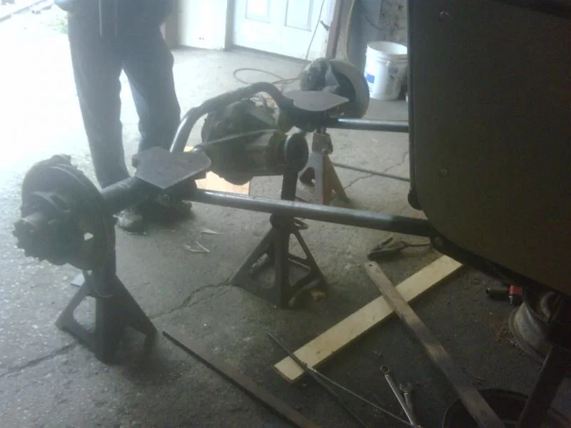

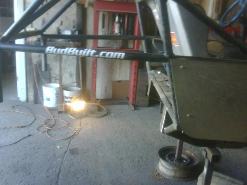

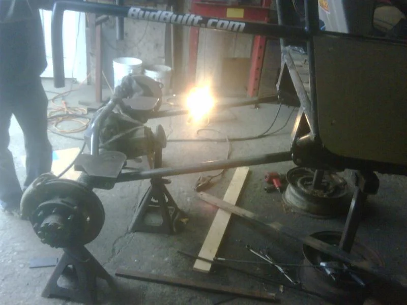

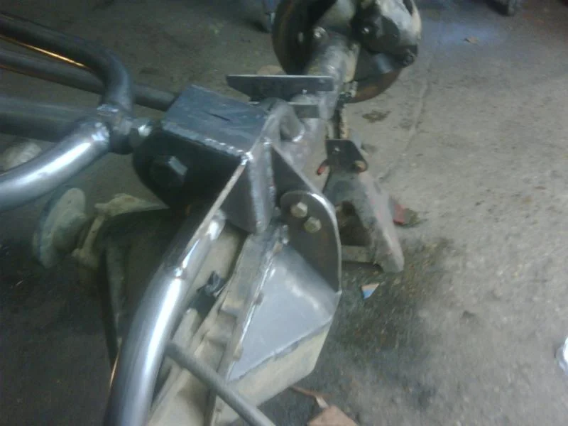

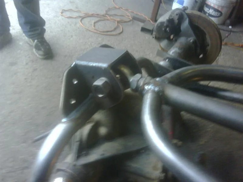

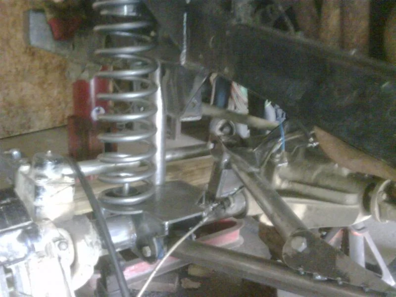

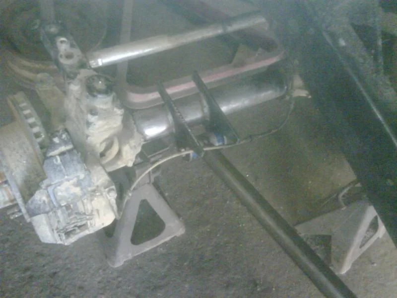

Stopped at Barneys today to see what kind of progress he has made on the suspension. The front leaves are gone, the front shock towers are gone, the forward most body mounts are gone. He has the lower links mocked up and I'm making a couple of plates for the coil mounts. Looks to be ready for Toys for Tots.

Stopped in at Barneys again last night. The front suspension is just about done. I need to get some 16" travel shocks so the front shock hoops can be fabricated. We played around a little and it looks like this thing is going to have CRAZY articulation.
Plans for the back:
Move the axle back another foot (it was already back about 9" from stock. Frame stops just behind seat mounts. Back of cage getting re-made to allow for spare tire sitting horizontally- for better visibility out the back. May require different fuel cell. 16" travel shocks again.
I'll get some pictures when I'm there again.
Still plan to have it ready for Toys for Tots. In fact, Barney wants to come along with his full size Bronco.

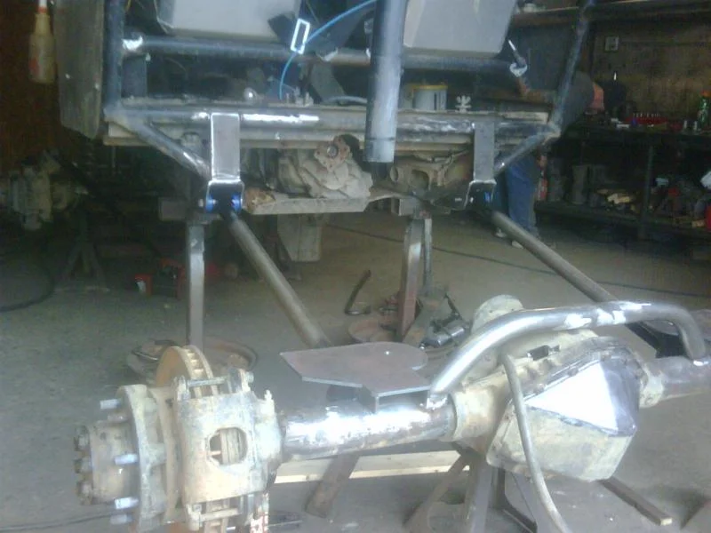

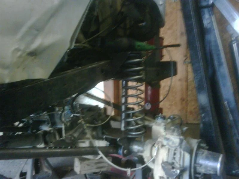

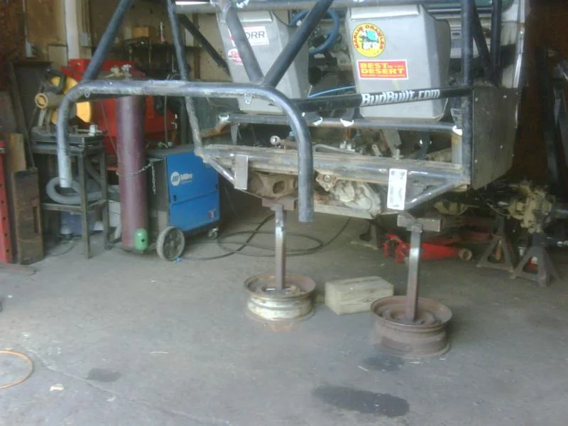

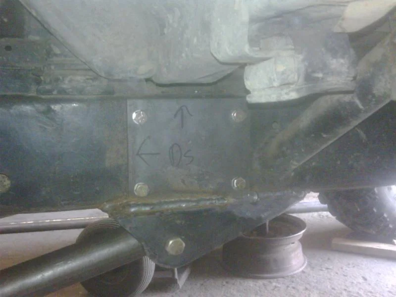

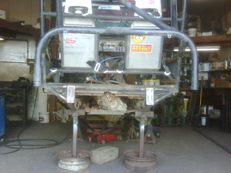

More pictures- todays update.

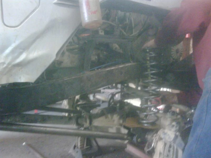

looks good, what are your plans for the rear tube work? I think it would look awesome is you just threw some bends in there and made the rear "bumper/gate" a halo with about a 75* angle. Like JR's Bronco...Ill go find some pics.

His has more angle than I thought, but you get the idea and it would be a nice way to wrap up the rear end with out having highly modify everything....or just tell me to shut up...on with the porn....

I like that a lot. I don't know what the plan is at the back yet. For now, Barney needs to get it rolling again so it is mobile. Then we'll think about aesthetics.
Preliminary calculations are that I could put one of the front tires 7 feet in the air, with none of the other 3 leaving the ground.

Nice, but make sure you are maintaining stability, one of the biggest mistakes made is going for flex and losing stability. Also flex IS the singe most over rated thing. *Sorry Carl* Carls old 4runner was a perfect example of TONS of flex, but extreem instability. If you have both awesome but it is rarely the case.

Adjustable limiting straps. Limit the flex to only what is usable.

Todays updates.
Rear axle back in place, rear links made.
Pics.

Quote:
Originally Posted by Shahram View Post
If I call my Land Cruiser a "space shuttle", will it keep us from burning up in a ball of molten metal when my buddies and I re-enter Earth's orbit after a camping trip on Planet X?
1998 4Runner Limited
1976 FJ40 Bugly, TBI 2F,4 speed, toybox, minitruck t-case, 418:1, 3 link, 4 link, coils, HP 60, 14 bolt, ARBs, caged, 42" IROKs
1964 FJ45SWB SOA,SR,383SBC,SM465,NP203/205,ARBs,Longfield Inners & Outers,36"Swampers,Caged eternal project
Hoosier Cruisers
LukeZero is offline   Reply With Quote

Todays update-
rear upper wishbone starting to come together.

wait, no conduit?
Looks nice, what made you go with the 3 link?
I guess im going o have to go to TFT this year just so I can see this thing in action.
Any idea on belly height?

Quote:
Originally Posted by 4rnr View Post
wait, no conduit?
Belly height is gonna be about 30".
As far as design of 4 link or 3 link... I let him pick what would flex the best. He has an enormous Ford Ranger on 2.5 ton Rockwells with this setup and the flex is just CRAZY.
Wheelbase is 117"
And, they do make conduit in the bigger sizes.
