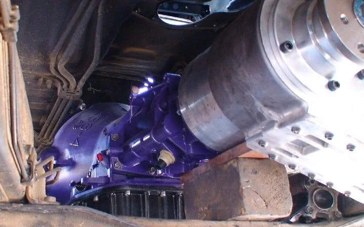

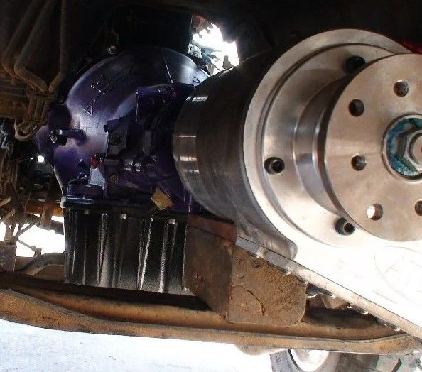

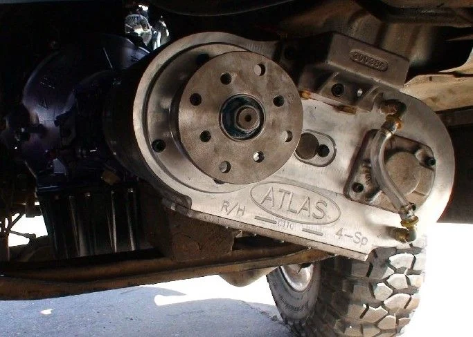

sorry about that.. had to down size them.

Old 10-15-06, 07:10 PM   #94 (permalink)
Site Addict
ridgerunner's Avatar
Join Date: Dec 2004
Location: Antarctica
Posts: 1,065
And that right there is the definition of "bling."

Old 10-29-06, 12:01 PM   #99 (permalink)
Site Addict
yotawheeler's Avatar
Join Date: Apr 2006
Location: Edmonton, AB/Vancouver Island, B.C.
Posts: 1,156
dude.....this thread is wicked, that is one sweet rig! and looks like she's gunna be bulletproof ill be keeping track of this thread for sure

nice pics dude .. this Atlas 4 spds rocks !

That trans/ atlas combo looks BEAUTIFUL! whats the lenght of the trans & what are the specifics of adapting it to an Atlas (splines, bolt pattern, adapter & tailshaft length etc.)? I may look into bolting a build 47re or 48re up to a 203.
Sucks about the axles! What happens if you break a casting, will replacements be available? I'm sick of dealing with fab companies that can never meet deadlines, sometimes missing them by 10x their initial ETA when taking your $$$.
oh yeah, whats the length of your rear drive shaft. I only have 29" with my TBI350, 700r4 & 203/205 double?. your combo has to be atleast 6" longer than mine.

As of yet.. I am unsure how long the drive shaft will have to be. Im waiting on the axles to come in before weld in the engine mounts and set the engine. .. so alot is riding on the axles getting done and in my rig. then Ill beable to take it over and have some custom axles made for the front and rear. Ill let you know what size they are when all is said and done.
About the 30d, I have found it for 1300, with a lense. not too much more than the 20d. And if I were to buy form one of thoes places on the internet.. I have found where you can buy a whole kit for under 1500, inclufddes 2-3 lenses case cover, etc. It just seems as if the prioce is too good to be true.. For now though.. Ill just use the camera which is built into our camcorder. This way ill beable to take a vid. of her when she first fires up.
