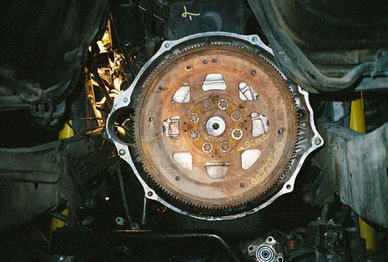

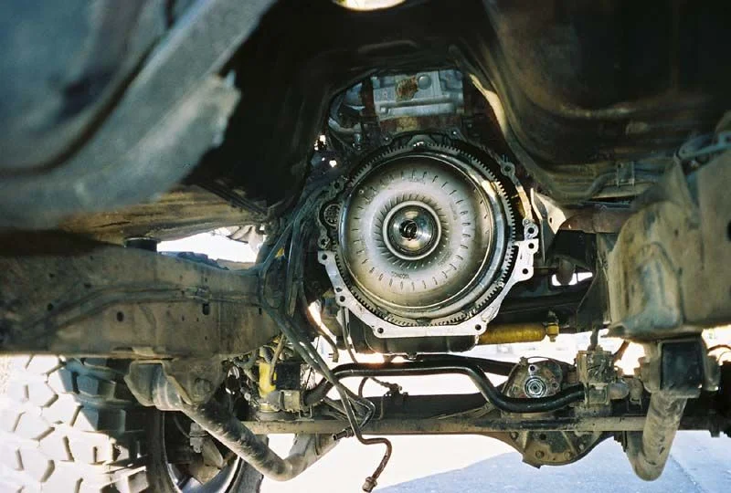

Let me see if I can find a few pictures.. I know I took a few from under there,.
I talked to Russ from Portal-Tek, and he said they should beable to start building with in 2-3 weeks. I cant wait untill I can put her back togeather again.

Here is a pic with the Toyota Engine and one with the Cummins taken from underneith.

So with the body lift the Cummins pan is only 2" -
3" lower?

Is the oil pan the only reason you're having to go with custom axles, as far as clearance is concerned? It seems that the oil pan is causing you a lot of grief that is going to make the truck VERY tall. It would seem logical to me to rework the pan, so that the motor can sit lower, and so you don't have to go to custom axles. Allowing you to not be ~12" over stock height.
I just think it will be so freakin tall that it will be unwieldy and not fun to drive/wheel. I don't know all that much about diesel's, so maybe there's a reason no one has suggested reworking the pan before. But assuming some general principles are the same, I don't see why a dry sump system wouldn't work on a diesel. And I guarantee you a dry sump system is a LOT cheaper than a new set of portal tek's and having to rework your entire suspension. Even if you do have to go to alloy shafts and longfield birf's.

Actually, the Cummins will sit only 3" higher than the stock, and thats at the valve cover... the oil pan will sit in the same spot, I will have it sitting 3" above the skid plate up front, allowing for clearence of the a/c and easier removal of the oil pan in the case that i may one day have to remove it. The body lift will help with the hood clearence, but I got the body lift to compansate for the 37" Krawlers, so they could fit in the wheel wells, because they were cutting into the fenders. I decided on the Portals for a few reasons....
Yes, I could have just went with a different built rear end custom made to work work with the Toyota suspension. By using the Cummins and the 47re (Dodge automatic transmission) I had to go from a off set (all wheel drive) differential to a standard Center differential. .. This gave way to more options and more headaches. By going with a centered diff, I have to do something about the rear axel, and the fuel tank. change, or replace. But I can also go to a part time 4 wheel drive, choose a different T/C with the options of 2-4 speeds, and have the option of going with a set of portals which will give additional clearence of the diffs.
but to answer your question... no its not because of the oil pan.. thats the least of my worries. I can have that cut, modified, hammered and re welded to work as needed. I am planning on adding an extra inch on either side of the axels to give me some more stability. Also, If im lucky, Ill beable to hit a cruising speed of 75mph. I dont need any more speed than that. It wasent built for road racing.
one of the advantages of the Portal-Tek axels, is that they will be a direct bolt in replacement. no extra cutting or welding needed.
True, I could get a dana 60-70 or 80 and stuff back there.. but after everything is all said and done, Id still be looking at about 4-5K to be modded to fit the Cruiser. Im just buying a new front axel also. a stock set of these portals are 8500 out the door. Not to bad.. still expensive.. but my current set up now is in need of up grades... My brakes are not up to stopping my truck anymore with the 37" tires. and they probably wont hold the power of the Cummins for ever. Im adding 16" rotors, CTIS, 300M axel shafts, beefed up parts, etc. to beable to compansate for what i am going with.
As far as the ride height, stability, and other issues... I wont know what its like untill I actually test drive it... I have kept all of my stock suspension parts, so if i have to I can always remove the 6" lift, and just get heavy duty stock ride height springs.
