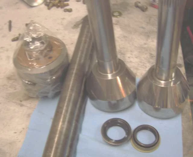

Front Axle Rebuild
I Previously had Stock Birfs and an Open Carrier..
Putting in a Lockright, with 27 Spline cromo Longfields.. Stock Inners for now, If im Breaking inners i can upgrade to 30 spliners by just changing the star!
i Also picked up Marlins New HD inner axle seal, this should solve the Leaking issues!

According to Bobby, Yes, only with the new Cromo stuff, the Birfs are the same size, the cage is the only thing that is different!

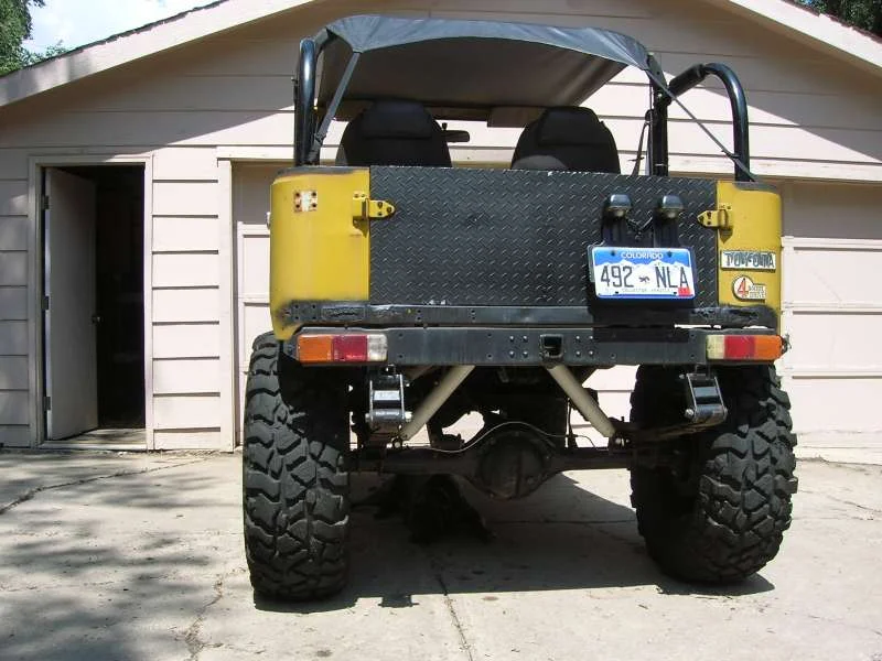

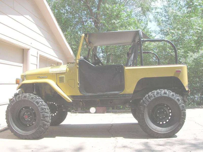

an Update
Got some new Tires/wheels mounted up last week.. (THANKS Uncle Ben)
They are 37/15.5 Pit Bull Rockers on 17" FJC Steelies (17"x7.5", 4.5" BackSpace)
My Axles are Stock Width at 55" WTW and i added a set of 1.5" Wheel Spacers.

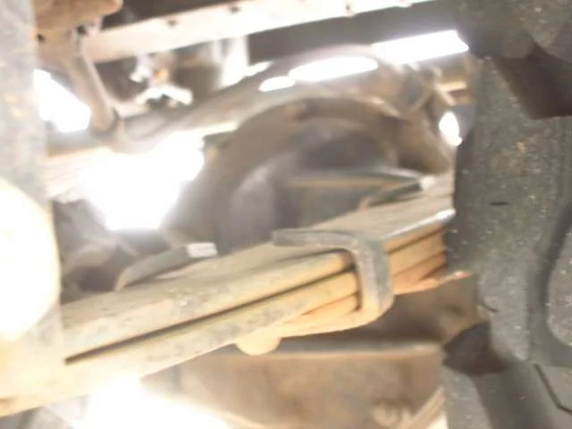

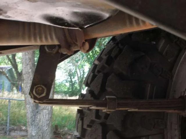

i need some advise on the rig.. Couple of issues as the truck sits.
Front springs are Flat Stock FJ40 springs Flipped / Shackle reversal under the frame rail w/stock shackle Stock Leafs
Rear Springs are FJ60 Rears Flipped w/ custom shackle.. they have a slight arch to them.. stock Leafs
100" Wheelbase, 23.5" to the Frame 22.5" to the bottom of the Flat Skid.
it Rides Like CRAP.. i feel every bump in the road, and pretty Stiff in the rear..
Its even worse on a rock filled trail, by the end of the day, im BEAT from getting thrashed!
Secondly, id like to bring it down to the ground just a bit.. especially in the rear..
THe front Tires rub on the rear of the front spring at full turn (see photo)
and the Rear tires rub on the side of the tub near the frame on full Flex.. ( so i need more width, either with larger spacers, Different wheels, or maybe new wider (FJ60) axles..
Also the Front fenders will need to be trimmed up alot
So im thinking about changing my front shackles so they run thru the frame, and have a bit more angle to them, also lower the rig in the front by about 1/2" or so
in the rear, id like to Take out a leaf pack or 2 to make it ride softer, then maybe put a smaller shackle on it to get it down even lower..
So, How should i go about widening the track, and getting it to ride better/lower? Im going to be getting some Bilstein shocks soon, but want to wait to see what the plan is on the truck first, so i don't get them too long/short..

sweet ride !! I miss my 40 ---for your ride issue - tj coils!! they work great on fj40's. also I have fj60 axles for sale!!
front 60"- rear 58"

I would try to achieve a shackle angle closer to 45 deg, should take care off all the above issues.

what do ya think about removing a leaf from the rear spring pack?

Quote:
But rear you only got 4 leafs ? so you gonna have only 3 ?
