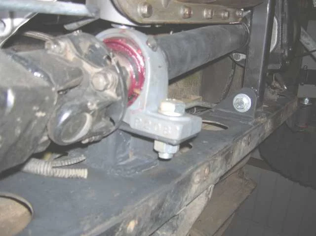

Front Axle Rebuild
I Previously had Stock Birfs and an Open Carrier..
Putting in a Lockright, with 27 Spline cromo Longfields.. Stock Inners for now, If im Breaking inners i can upgrade to 30 spliners by just changing the star!
i Also picked up Marlins New HD inner axle seal, this should solve the Leaking issues!

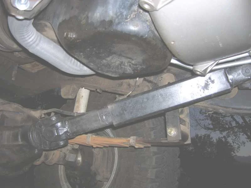

i need some advise on the rig.. Couple of issues as the truck sits.
Front springs are Flat Stock FJ40 springs Flipped / Shackle reversal under the frame rail w/stock shackle Stock Leafs
Rear Springs are FJ60 Rears Flipped w/ custom shackle.. they have a slight arch to them.. stock Leafs
100" Wheelbase, 23.5" to the Frame 22.5" to the bottom of the Flat Skid.
it Rides Like CRAP.. i feel every bump in the road, and pretty Stiff in the rear..
Its even worse on a rock filled trail, by the end of the day, im BEAT from getting thrashed!
Secondly, id like to bring it down to the ground just a bit.. especially in the rear..
THe front Tires rub on the rear of the front spring at full turn (see photo)
and the Rear tires rub on the side of the tub near the frame on full Flex.. ( so i need more width, either with larger spacers, Different wheels, or maybe new wider (FJ60) axles..
Also the Front fenders will need to be trimmed up alot
So im thinking about changing my front shackles so they run thru the frame, and have a bit more angle to them, also lower the rig in the front by about 1/2" or so
in the rear, id like to Take out a leaf pack or 2 to make it ride softer, then maybe put a smaller shackle on it to get it down even lower..
So, How should i go about widening the track, and getting it to ride better/lower? Im going to be getting some Bilstein shocks soon, but want to wait to see what the plan is on the truck first, so i don't get them too long/short..

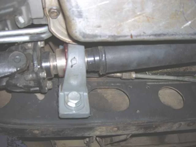

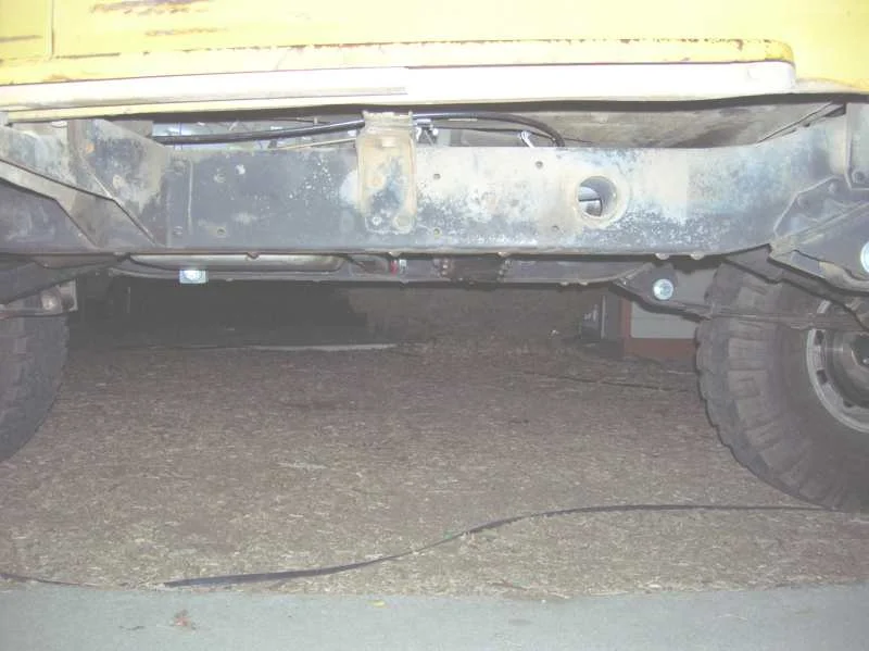

more updates
I Figured i would make an Update on some Recent work to the truck..
I did some Body work here - http://forum.ih8mud.com/paint-body/2...rtion-tub.html
finally put in a Roll Cage , Designed it in Bend Tech and Bent it up out at Redline.. Front Suspension Seats are "Race Trim". and the rear seats are Tumble and fold, not too sure what they came out of. but they work Perfect for a 40. Tube Doors from Redline..
I still have not addressed the Bad Ride Issues, but i Figured Safety was First!
I also Traded out the 1.5" spacers for 3" but they will work till i can build some wider axles..
I am SO. Happy with the way everything is working. the Pit Bull Rockers are working good now that they are getting broken in a bit.
some photos from CM 08
