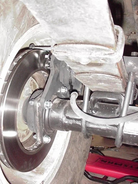

Old 05-03-06, 01:28 AM   #63 (permalink)
Supporting Vendor
Isotel's Avatar
Join Date: Sep 2003
Location: Crawlorado.com
TLCA# 16898
Posts: 3,543
With a little luck i should be on the road this weekend!
Rollin on some 35's for now
A shot of the Disk Brakes - Brackets are from www.ruffstuffspecialties.com

Old 05-03-06, 07:25 PM   #64 (permalink)
Rum Runnin'
GLTHFJ60's Avatar
Join Date: Apr 2005
Location: Usually Upstate NY
TLCA# 17825
Posts: 5,270
Garage
That looks absolutely gorgeous.
Excuse my dumb question, but why did you lengthen the wheelbase? To reduce the rear overhang?

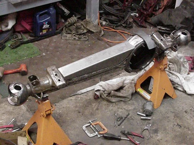

Old 05-03-06, 08:36 PM   #65 (permalink)
Supporting Vendor
Isotel's Avatar
Join Date: Sep 2003
TLCA# 16898
Posts: 3,543

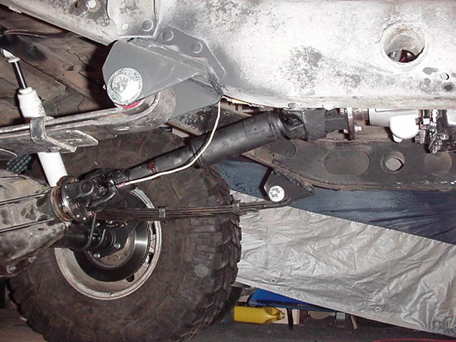

I wanted a longer wheelbase for steep climbs, dropoff angles, ect. The longer springs should flex a bit better than the stock ones
I Needed a longer wheebase because of the length of the 700r4 and Dana 300..
20" rear driveshaft would have been a bit too short. mine ended up at 25" kindof a crapy photo but an IFS minitruck Front Driveshaft worked perfect (clearenced for more working angle)

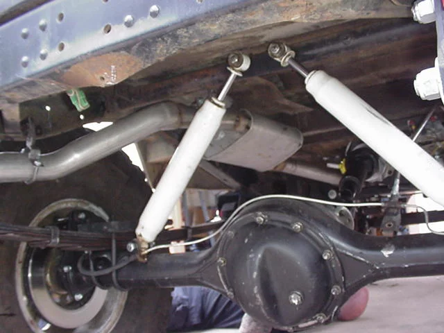

Old 05-04-06, 04:04 PM   #66 (permalink)
250+ Club
awp_cruiser's Avatar
Join Date: Jan 2005
Location: Seattle
Posts: 298
Nice work... You are going to beat me to the trail too.
No rear axle wrap bar?
No parking brake?
I am debating where to run my rear soft lines. Do you like where you have run those?
Any plans for a skidplate?
awp

Old 05-04-06, 06:55 PM   #67 (permalink)
Supporting Vendor
Isotel's Avatar
Join Date: Sep 2003
TLCA# 16898
Posts: 3,543
The Trail will have to wait till i can get a Front Driveshaft 2 piece shafts from Jessie are Pricey!
Rear warp bar is in design mode right now.. http://www.jeepaholics.com/tech/bambar/ i like this design, but need to figure out how it will work with my setup, i gota have the 3rd removable..
Skid plate will be some sort of Aluminum flat plate..
as for the Parking break, im not sure that i will need one, but it would be nice, and some tech inspections may need it..
My soft lines came of the 78 Monte, i guess they work ok, and are tucked up as best as i could without going over the Leafs..

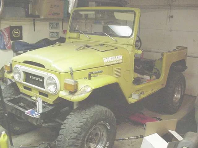

Old 05-10-06, 12:14 AM   #68 (permalink)
Supporting Vendor
Isotel's Avatar
Join Date: Sep 2003
TLCA# 16898
Posts: 3,543

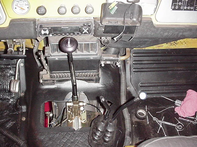

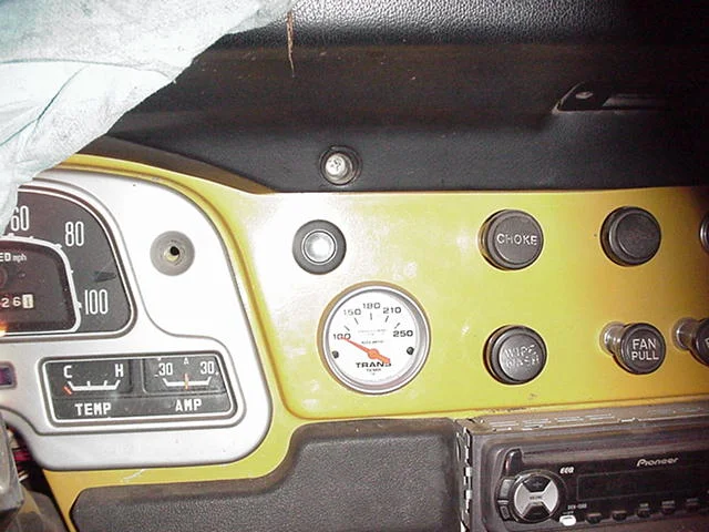

Progress
Tranny Temp Guage Done
Seats are in
Shifters are almost done ( so far i hate the lokar, ive got 3-4 striped screws including the one for the shifte knob.. Dosent engage right, etc..)
Exhaust is done..
I drove it around the block on sunday, all seems well so far, didint get up to any speed.. Ive got to do some studying for another Final Exam..
2 more days and im done with school FOREVER!
Still not done with my project and my roomate has his started the next project SAS on his 94 Minitruck

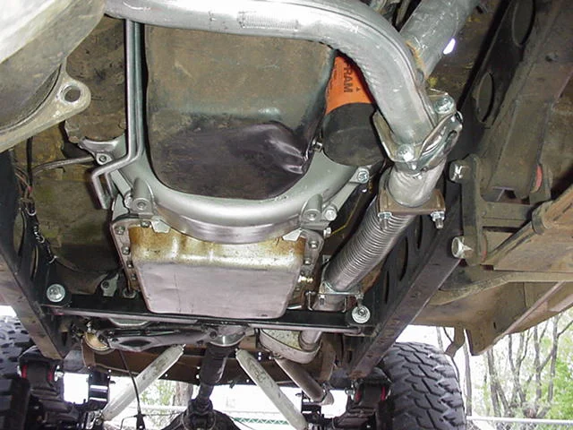

Exhaust shots
nothing Fancy, Everything cost me like $150 Manifolds to tailpipe.. I planned on having somthing nice put after the walker y-pipe, but Ran out of money.. this was 2 1/4 with a cheep turbo muffler..
Sound is pretty good, nice and quiet, its so nice to finaly have a decent exhaust! That fender Exit crap is long gone
before anyone said anything, yea i know my oil pan is jacked.

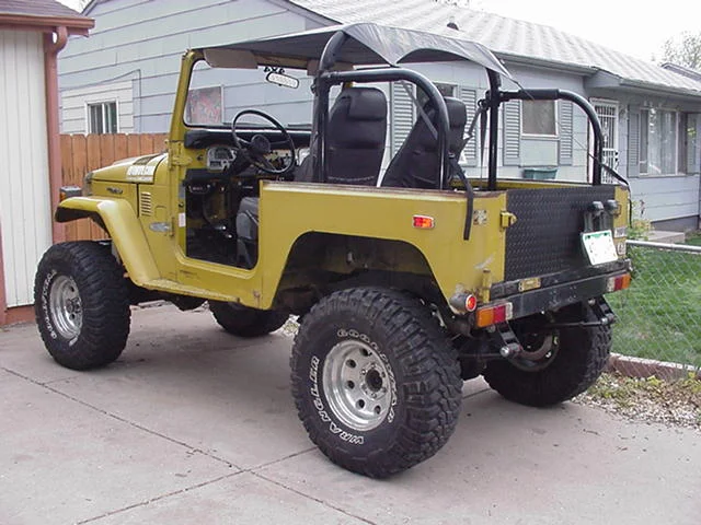

Some Driveway shots will have to do till i get a driveshaft.
The FJ60 rears provide less bodyroll than stocks..
overall everything so far has exceded my expectations, Minus the dam Lokar..

Hey don't know what you have to check codes or engine lights but I just bought this and it showed up today...got it from tradervar. com for 99 bucks shipped...

as long as the mounts are rigid it really does not matter when in relation to the axle they are mounted.
It is the single bar with a single mounting point on the axle as opposed to a ladder style mount that causes issues..

Still have not built a Wrap bar, but thus far im not getting alot of wrap from these springs..
Any Oppinions on this design?? http://www.jeepaholics.com/tech/bambar/
I dont have alot of room back their, and im going to need to rework my exhaust to make a cross-member

2-Piece Driveshaft tech
Ok now for some long overdue Front Driveshaft info..
I would have loved to Send Jessie at High Angle $500+ and have him build me a badass shaft, but i just couldint come up with the cash, so i decided to improvize a little and am happy as could be with the results..
I Found Front Section of a Rear driveshaft from a Extra Long wheelbase Toyota Minitruck, These trucks came from the factory with a 2 piece rear Shaft with a Rubber Carrier Bearing (Typicly the rubber wears out and people switch it out to a 1 piece shaft) ($70 at a Junkyard - I got Riped off, maybe you can find one cheeper(
Then after some research on Pirate i found that the Formula Toy Guys are using a 1 1/2" Pillow Block Bearing that fits perfect for replacing the carrier Bearing.. ( $15 a pop on e-bay, i got a second one incase this one fails)
I had my Local Driveshaft Shop Machine the 2-piece toy section down and he used a 2 1/4" Tube to connect it to a 1310 u-joint, This section is about 19" long and just Squeaks past the Crossmember, and Tranny Pan. (Cost - $100)
__________________
1976 FJ40 TBI350 700R4 D300 SOA Locked 37" PBR's Protected by REDLINE
Colorado Land Cruisers -=- CrAwLoRadO.com
Redline Land Cruisers - PM me for info on our products or to order!
Isotel is offline   Reply With Quote
Old 06-19-06, 09:14 PM   #89 (permalink)
Supporting Vendor
Isotel's Avatar
Join Date: Sep 2003
TLCA# 16898
Posts: 3,543
For the Front Slip Section i Went back with the old Square Shaft Section.. The U-joint side of the Junkyard Minitruck 2-piece was used at the top, and a Cruiser U-joint at the bottom..
I also drilled the flange for a minitruck CV pattern, i may eventualy replace it with a CV, and a Ballanced Slip yoke.. Trail-gear should have a kit out soon for about $100 for a 12" Slip..
So Far so good, i did some camping this weekend and minor wheeling, it works Great!
So ive got about $200 + some Time and gas..
A Flat Belly --- Priceless

The Raisin and spitwad of homegrown both use a similar wrap bar to the bam bar utilizing an old fj80 radius arm. They seem to work well, doesn’t look like there springs wrap but they do get a little hoping when they hammer down on really steep nasty stuff, not to say that the bar is necessarily the cause. Get a cage in that thing! Wheeling season is now!
